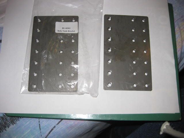

Post  Kevster on Sun 06 Nov 2011, 8:49 pm
Am I barking up the wrong tree here, the brackets I mean are the ones bolted to the hornplates,
Are they modified or is it just the ones attached to the tank that have been revised?
Anyway, here are the brackets I have that bolt to the hornplates.
Part number BS 40903
Re: Which bracket do I use?
Post  lynnr on Sun 06 Nov 2011, 8:58 pm
THats the correct one for the horn plate. No modification to part.
You will get modifyed brackets for the belly tank end to bolt onto the pictured brackets.
So as far as I can see you are good to go.
Number of posts : 2939
Post  Kevster on Sun 06 Nov 2011, 9:04 pm
Thanks Lynn,
Its all system go again then !
