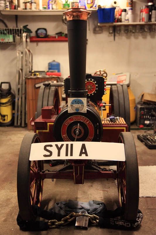

Post  thehawk on Tue 27 Mar 2012, 9:38 pm
Repeating my post on forum late last year (4" Burrell - Up and running):
I filled in the DVLA form, following the instructions from other wise ones here on the Forum. I also sent in the public liability and motor insurance certs, the STW pressure test cert, the STW safety valve cert, the receipts, the boiler certificate of conformity doc, boiler inspection certificate, plus my driving license, a utility bill and the three photos shown in my previous posting. My "local" DVLA office is Bournemouth.
I received an email from the DVLA Vehicle Inspection Officer within three days saying it looked good and implying he was satisfied with the evidence. Yesterday just 12 days from receiving my application the DVLA issued my registration certificate and a 12 month tax disc. So no further inspection required and a pretty efficient turn around by the DVLA. Yippee!!
BUT REMEMBER................
Once you have received your registration number you must go back to your insurer (WM in my case) and let them know. I forgot to do this and got a snotogram from the DVLA threatening a fine as I seemed to have a registered vehicle without insurance. Your insurance company needs to pass the registration number to the "Motor Insurance Database" (MID) - this has to be been done to stop uninsured drivers - so the thought of a DVLA man coming round to stick my engine in the crusher soon had me on the phone to WM!!
There is also one other issue with registration. Legally speaking the number plates can only be of 2 sizes both of which are too big for a 4" scale model steam engine - so you have to weigh up the risks and make a decission with fitting a smaller, say 9"x3", plate which looks right but is not legal! Of course on a public forum I'm not going to say what I actually did!!!
It's worth the effort as driving a couple of miles or more on the open road is great fun!
