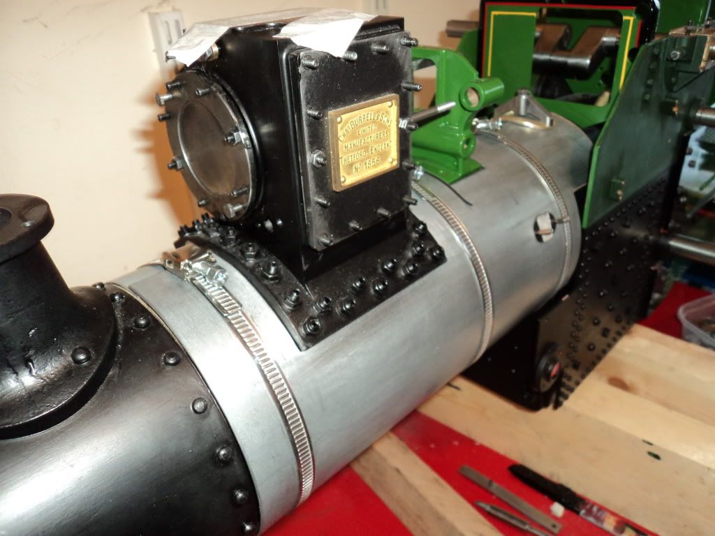

Post  andyc on Fri 10 Feb 2012, 7:50 pm
Hi,
Finally got some time to work on the engine ( not touched it for about 6 months ) and the first job on the list was the cladding. I was determined to get it to fit without carving it into lots of bits. After lots of trial fitting, trimming, filing, and scraped knuckles i think i have done it.
Not looking forward to re-fitting it once it is painted. Lots of other bits of the engine have been trial fitted, removed and painted so hopefully it should come together relatively quickly now.
Will look alot better with the brass boiler bands but needed the jube clips as i needed about 6 hands to do it without.
Andy
