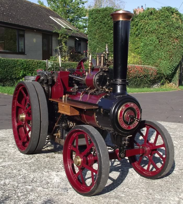

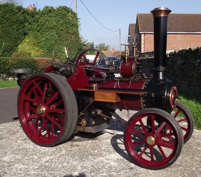

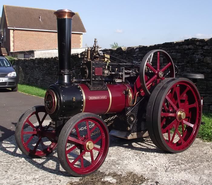

Last weekend I thought I'd have a steam up and as the weather was good I took a few photos. My engine was first steamed on Boxing Day 2010 and since then it has run a dozen times and I also spent one day at a local rally, at the Gartell Light Railway, in July. Now I'd be the first to admit my engine is not one of the flashy, gleaming paint and all lined out types. Spraying one colour was pretty much the limit of my skills and patience (not that I don't admire those who can and do!). But it was more important to me to have a working engine particularly after the nerve racking demise of MW when I thought that the six grand already spent had got me two hundred weight of scrap metal. Of course Steve and Dean rode in to the rescue and a happy ending resulted!
Few people report on what happened after they completed the build so I thought I'd would share a few experiences, not in huge technical detail but just to give those who have not progressed this far the gist of it. Obviously the whole process is a learning experience, well it was for me with my engineering background in electronics and radio. Not just assembling the engine parts all together, which apart from rivet bolts I enjoyed, but learning how to operate this machine and get an acceptable balance of fire, water level and steam pressure.
Since the first steaming I find the engine now runs more freely and feels more powerful. I share a private drive of approximately 60 yards on a slope of about 1 in 50 with room to turn at each end, so I can run continuously up and down. The downhill is enough to judge the improvement in free running, which it will now run down with the very minimum amount of throttle. Uphill is just enough load to judge the difference between both road gears and trying the three settings on the reversing lever. It certainly runs well in both gears and in all valve settings with a noticeable change in the exhaust note as the cut off is varied. Obviously, more economical with the reversing lever pulled back. I reckon if I thrash it, it does 8 - 10mph but it's a bit hairy with the amount of slack in the steering! (It would be nice to have some means of adjusting the slack). Also, too much throttle too soon and, guess what, it primes and you get showered in crap as does all that lovely paintwork! Although, priming seems to be less of a problem now things are settling down.
With respect to fuel, I normally use Taybrite briquettes (which we use to fuel our Rayburn). This is a relatively clean burning anthracite based coal that produces a fine ash (lovely when it primes) and no clinker. The engine likes a deep fire of this fuel. When I went to the rally this summer I was given a bag of "Welsh" coal so have run the engine on this a few times. This burns well with not too much clinker, nice and hot and seems to work with a less deep fire than with the Taybrite. However, the useful thing about Taybrite is it is readily available loose or in bags from the local coal merchant, price approximately 18 per bag.
The water pump works well, the injector works ok but is a bit spluttery and likes cold water, the water lifter works well and the blower works fine now that I have cleared a blockage in the cylinder block, which was either swarf or sealant. The only problem I have had is when the spring cup in the valve chest came free and jammed the slide valve buckle snapping it off. STW were very responsive providing me with new parts almost by return of post. In terms of small modifications, I wasn't happy with the security of the splines on the gear shaft so drilled and tapped the end of the shaft and fitted a disc so the splines cannot slide out. The throttle handle is a bit small and I found it dug into my hand, so I turned a new longer brass handle, cut a thread on the existing one and screwed the new handle over it. The throttle takes a bit of getting used to as one moment you're standing still and if you're not careful the next moment you're doing a wheely!! The new handle helped a bit, giving a better leverage. Elsewhere a few things have needed to be tightened up and I'm thinking of ways to put an tensioner in the steering chains.
I now feel confident enough to get road registered and take it out for some real exercise, living in a village means access to quiet roads, well they were until they let me loose!! I have wanted a steam engine since I was about 10 years old (well I'm not actually sure because I can't remember that far back!) but would have never built an engine from scratch so the STW formula is brilliant as are the two main characters involved in the company. But I would like to say thanks to all of the STW team, they have made me very happy. Slightly poorer in once sense, but decidedly richer in many others!

here's the pics of Paul's engine Cool ...
