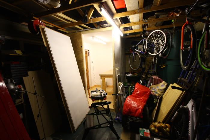

Post  Dan on Sat 12 Nov 2011, 9:08 pm
Well finally the workshop is finished. Bench too! So I've married them together....
The new workshop is in the corner of the garage with a false wall so whatever I build in there can be rolled out when finished...
Here's the false wall....
And here is the bench. It's bloody sturdy. Needs a shim in the back left but up against the wall it doesn't move cheers
Oh and it's such a small room I've had to use a silly wide lens cyclops
Now for some shelving. But it's too late now, will do it in the morning after remembrance service.
