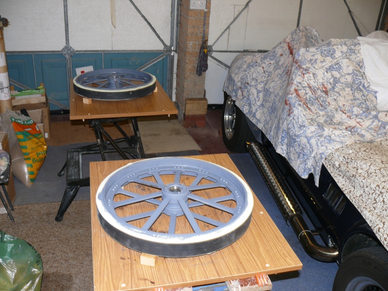

I have just started my build of the road loco. I believe it was the last one from the current batch. So far just received kits 1 on 28 July and 4 end of August. I have now painted the front wheels but not got a gloss finish despite using the Craftsmaster paint. Probably need to give them a bit of a rub down before starting the pinstriping.
Front wheels
Into etch primer
Under coat
Top coat yes it is blue Oxford Blue
The finish looks mat at the moment after putting on 3 coats but I have noit flatted the final coat as I am waiting to do the pinstripping and not decided yet what to do. Probably golden yellow with a red centre stripe.
Have just completed the first rear wheel construction, spent this weekend dry building and bonding the wheel. Will have to leave it until next weekend as am going to St Andrews for the week with work. Not to play golf, never played golf in my life expect for crazy golf with the kids.
Dry build complete
Bonding and build complete

I am not sure about yellow on a car I used to have a golden yellow Lotus seven, having parked it outside a slaughter house on a hot sunny day I came back to a black car. It was completely covered on tiny black flies. They must have thought it was a flower of some sort.
Have been back a week from St Andrews and been painting the rear wheel so far got two coats of etch primer on and two coats of undercoat. Now need to do a good rub / flating down before starting the top coat enamel, hopefully get some time on Sunday to start the preparation for top coat, as am off ballooning tomorrow for the day.
Rear Wheel
Post  IanL on Tue 27 Sep 2011, 8:53 am
Hi Just started to put the top coat on and the finish is really glossy, so much different from the front wheels which have turned out satin. Same paint out of the same pot so any suggestions why the rear wheel may have turned out glossy
This is after just one coat of enamel another one to go.
Looks like I will have to repaint the front wheels. The only difference I can think of is the front wheels were painted 24 hrs after putting on the last undercoat. Where as the rear wheel did not get painted for 4 days after the last undercoat.

Post  Steve Traill on Tue 27 Sep 2011, 12:17 pm
Hi Ian
By painting the gloss onto the undercoat before it was fully cured some of the lacquer in the gloss has soaked into the undercoat. Even when it is fully cured some loss of gloss on the first couple of topcoats occurs over time. I've found the third gloss coat is the one that keeps its shine long term.
Number of posts : 722
Re: IanL Road Loco
Post  IanL on Tue 27 Sep 2011, 2:10 pm
Steve,
Thanks for the info the front wheels did get three top coats at 24hr intervals. Maybe I need to give longer for the undercoats to dry out before top coating as happened with the rear wheel. So it looks like the fronts will get 4 top coats before pinstriping. Hopefully that will get me a gloss finish on the fronts to match the rear.
Re: IanL Road Loco
Post  IanL on Thu 29 Sep 2011, 7:54 pm
Hi Steve, have now put another top coat on a front wheel and it now matches the rear wheel nice a shiny but will need another coat and then leave to harden before trying to rub down and get a smooth finish. Thanks for the suggestion.
