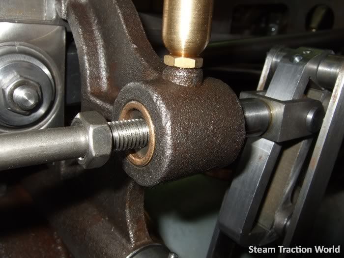

just to say we have found a couple of problems with the valve gear kit Embarassed
number one, it would appear that the valve spindle has the ability to travel deeper into the weigh-shaft bracket than intended. with the lock nut in place this could cause a bit off a mess...
we have made a spacer to solve this. please dont try to add length to the valve rods as apparently this will mess up the geometry !!!
number two, it seems the key-way on the weigh-shaft is too deep. we are making a new key to solve this.
these parts will be sent out as soon as possible

Was about to send you pictures of a problem I found last night. But you already have it.

I have fitted the spacers and can confirm. Problem solved. Everything wiggles and shimmies in the correct way and place. Just need to take it all apart again to plate / paint and remove the Right hand bearing casting shims. But think this can wait until the next kit that requires the crank removed anyway.

The 2 spacer for the end of the valve rods can be put on without the crank being moved. But I remember in the instructions that the crank may need to be taken off a couple more times for bits to be fitted.
When I first fitted my weightshaft and crossheads. The con-rods were off to the right of the bigends by 3mm. So I put the shims in as supplied by STW. Once I reset the weightshaft as it was 1mm too high on the HP side. This moved the con-rods into the correct location without shims. Hence my comment on removing them.
