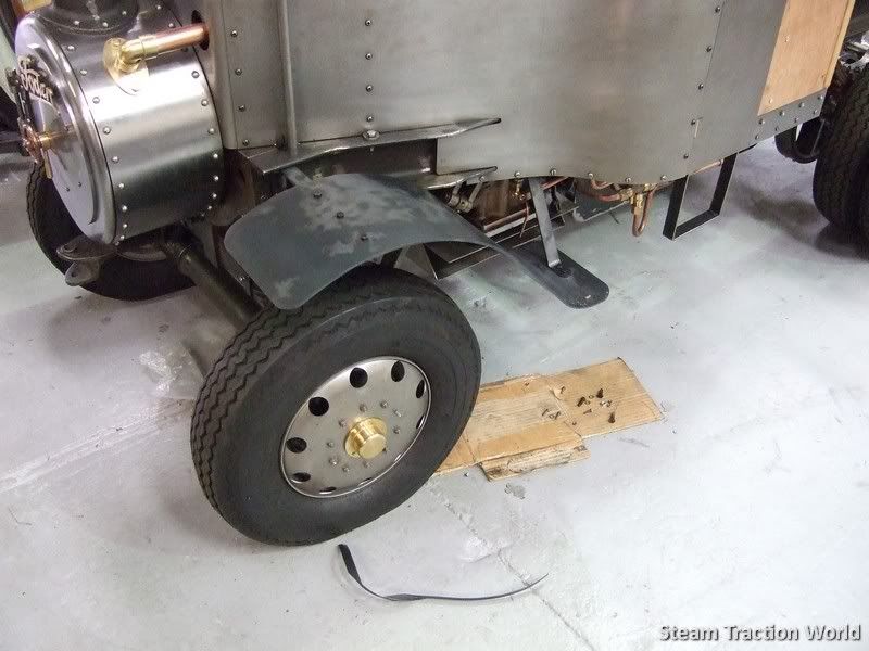

just had the folder for the next foden kit. this contains the front mudguards and various brake parts.
some of the bits are in stock and some are brand new parts that we need to make.
also i need to get the redesigned man hole clamp done so it can go in this kit Embarassed

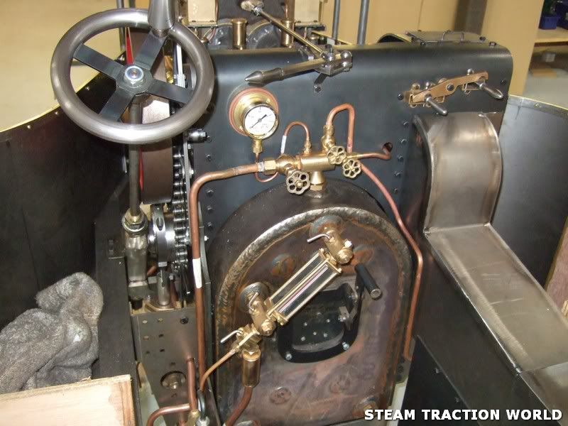

just a quick photo of all the gauges on the control model...

we have a delay on this kit because steve is making some SWB/artic mods to the mudguards. most of the new bits are laser cuts

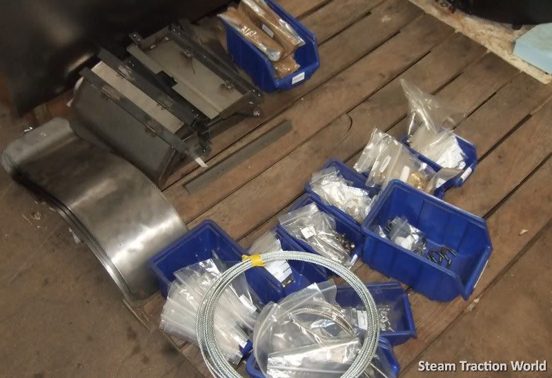

this kit is nearly ready to go.
the mudguard laser cuts are done...

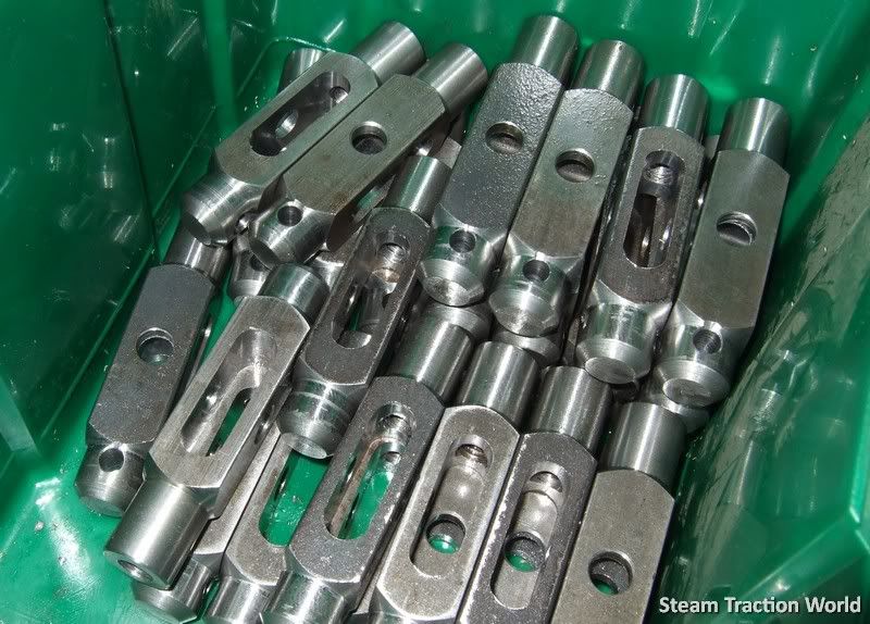

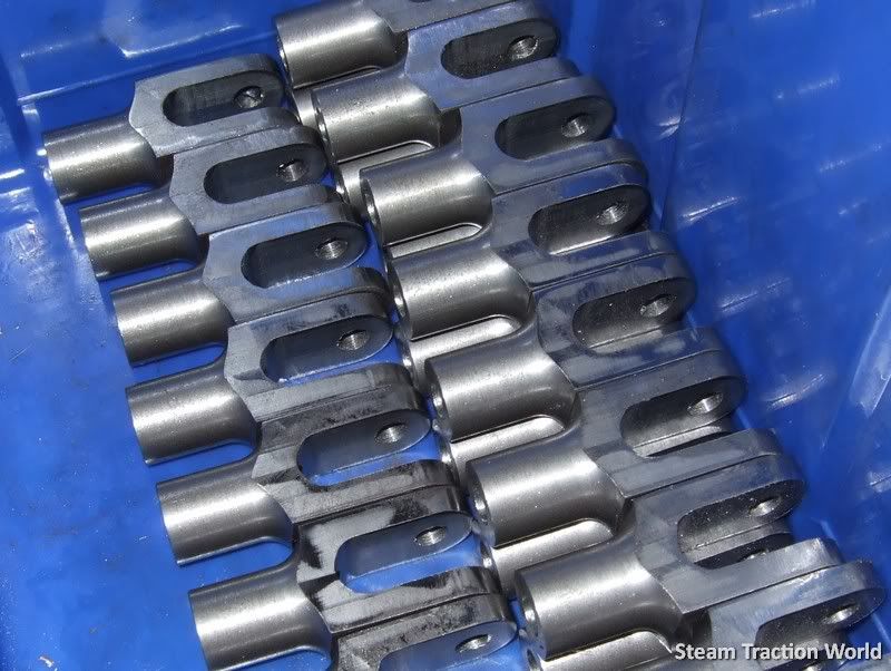

brake clevis' are done...

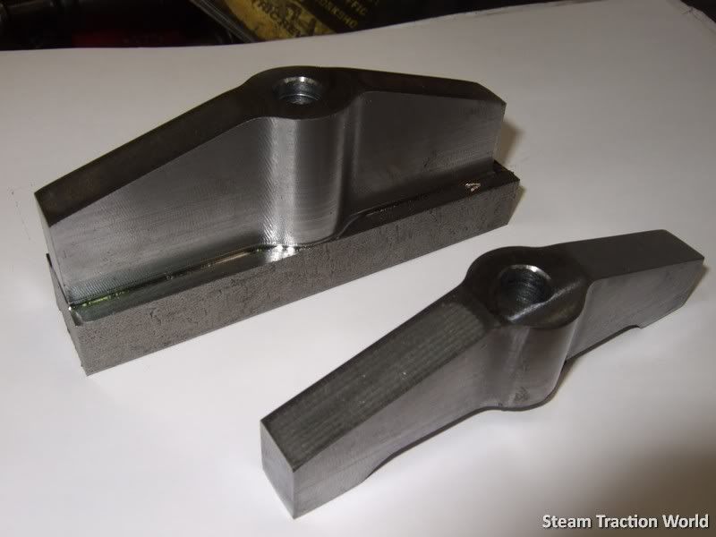

and the replacement manhole clamps are done...

I assume the R/H clamp is the old clamp and the L/H clamp is the new one if so what is the big lump on the bottom is this part of the machined part or a bit stuck on the bottom, a photo of it in situ would be good.

My clamp came loose at the last steaming . I had modified it by fitting "spacers" underneath it but still wasn't able to get it tight enough. This modified one looks as though it should do the job.

Yes I had heard about your little mishap, I was trying to assertain if this was a new clamp or a modification of the old one, I was assuming it was a mod due to the fact that it looked like it was in two parts, had it been a new manufactured part then it would been machined as one.

nope, both clamps in the pic are the new one. this is just to show how it was made. the large lump on the bottom of the first one is used to hold it in the vice. if you can imagine a solid lump of bar in the vice, the shape is milled from that lump, then its turned over into a pocket and the lump is milled off and the part is finished... 2ops Cool
the bar we used was a bit on the large side, we wouldn't usually waste that much material, but the bar was ordered before the design was finished.
as for a photo of it in place... well its actually very difficult to fit to the control model at the moment because of the con rods etc. I'll get a pic of it on a new boiler and post later

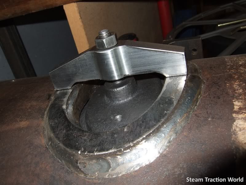

heres the photo...

Proper job, well done Craig!! Very Happy
