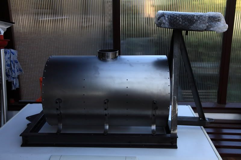

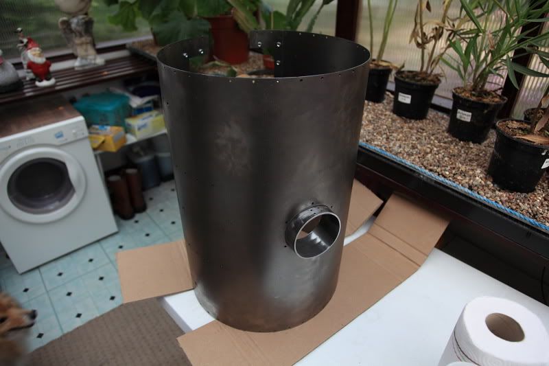

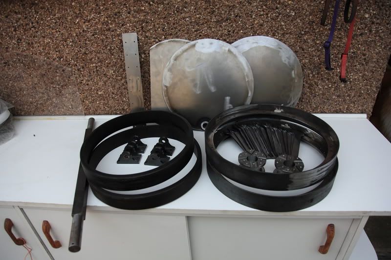

New water bowser starting to take shape.
Checking the parts in to inventory
Trying bits for size. The usuall STW precision.

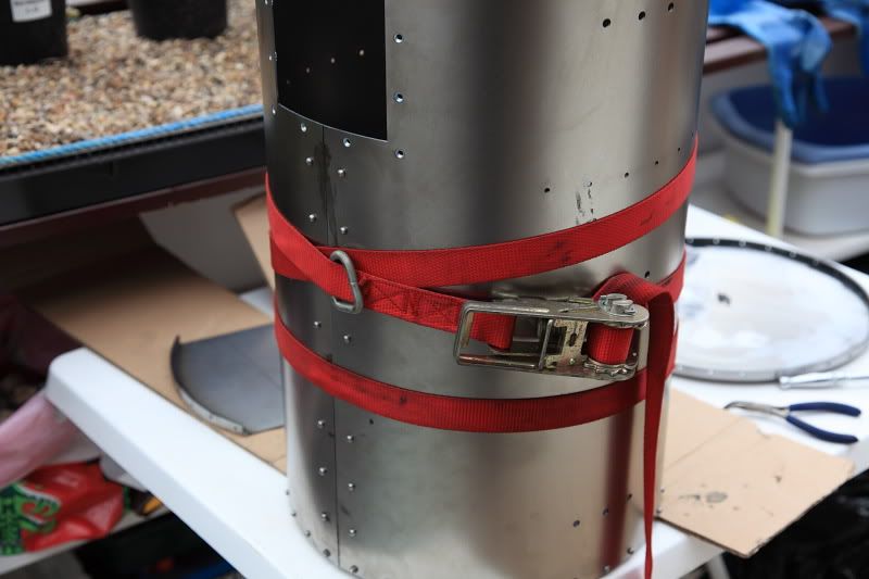

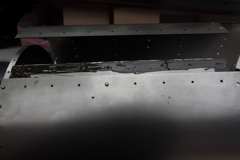

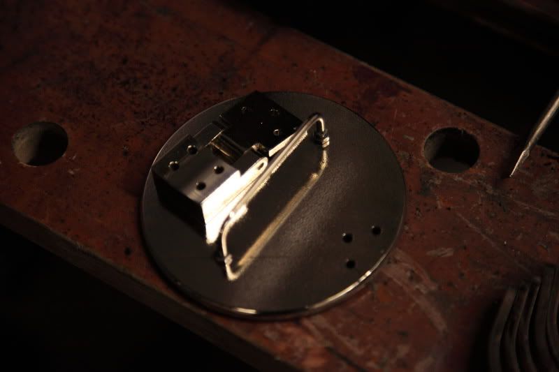

Just using a strap to help get the seam tight. Coated the seam plate with Heldite then cinched up the bolts.

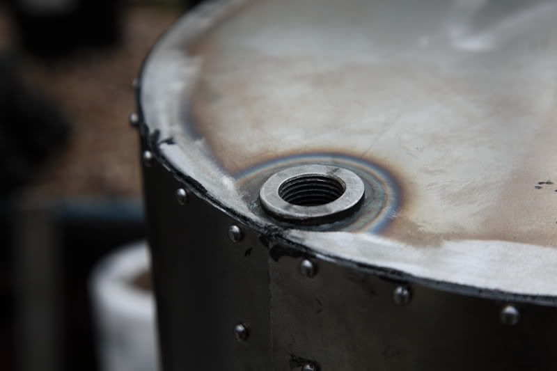

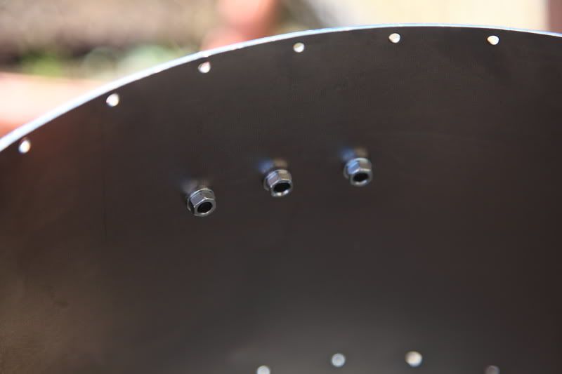

Just an idea. I welded the nuts for the hangers into the barrel as this allows the brackets to be fitted after the tank is closed up and painted. As the area just behind the bracket where it curves away could be a problem to paint.
That is one end done.

Nuts
Post  lynnr on Fri 29 Jul 2011, 4:59 pm
Missed the nuts welded

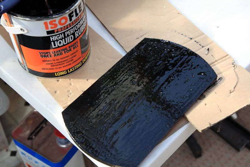

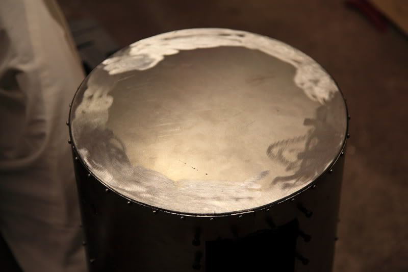

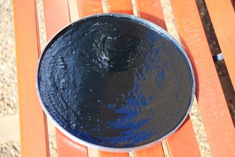

Still need to do the baffles as one is missing. Got the tap end plate all tightened up. So going to paint the bottom 1/3 with Isoflex, upto the baffle plate. Paint the 1st baffle plate on the non flanged side and insert. Once in place and buttoned up. Run some isoflex behind it to coat the corner and contact area. Then paint the front of the baffle and the next 1/3 of the tank ready for the 2nd baffle plate. And as they say repeat if required. I will then paint out to 1/2" from the blank end plate. Fit the end plate having painted this to the edge of the flange. So it only leaves the 1/2 inch flange to paint up via the hole.
Sounds like a plan
Number of posts : 2975

Started painting and fitting the baffles.
Then had to go fetch a new Rotary dryer as the old one fell over. The base snapped.

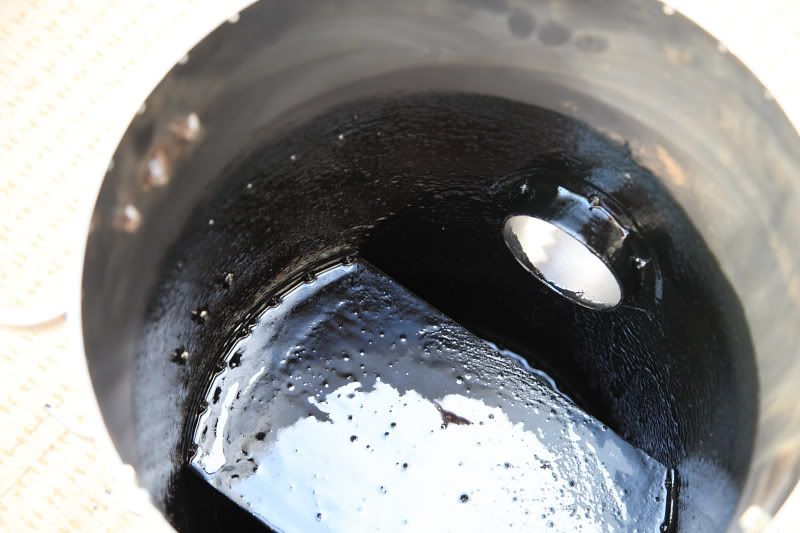

Done some more coating

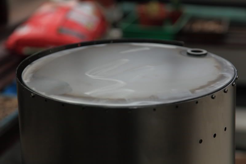

End plate ready for installation once the isoflex dries

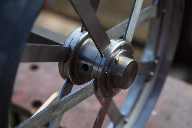

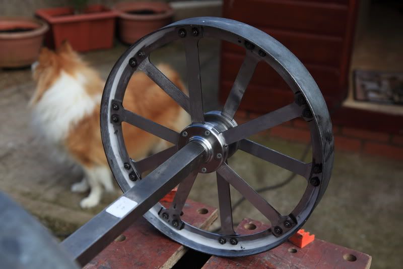

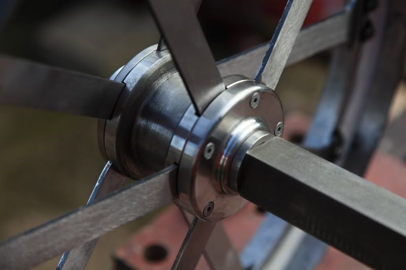

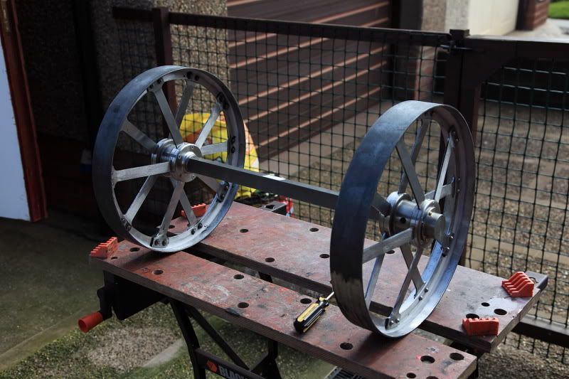

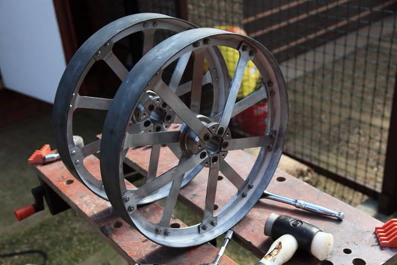

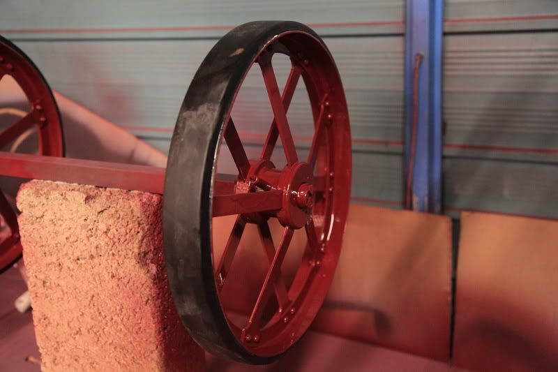

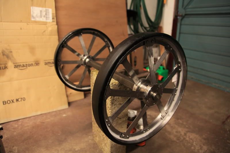

While the isoflex is drying thought I would start on the wheels.
Fillets done
Wheels dry fitted to make sure all is OK. Need to grind down 1 screw in the hub.

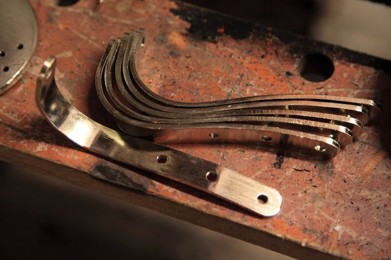

Should get the barrell finished tomorrow. Going to do some polishing tonight. Filler lid and hinge, handle, the 6 tank supports, the rear tow hitch and the eye of the front drawbar ready for Bright Nickle platting tomorrow.

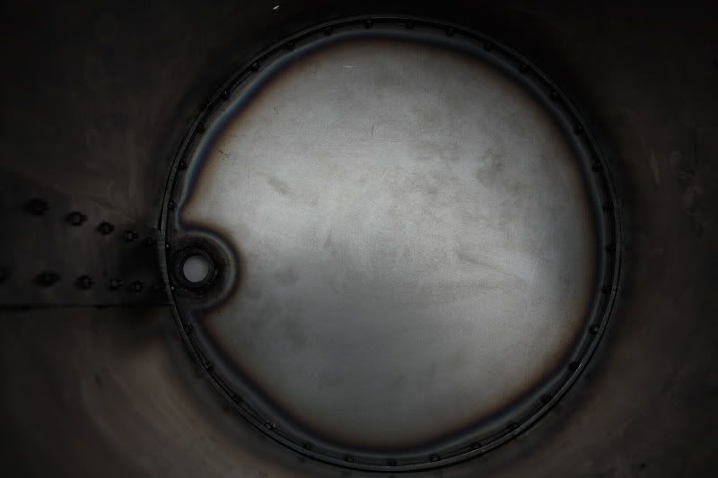

Good progress today. Got the blank end on the tank and the inside isoflexed. Tank support brackets are now plated after a good polishing.

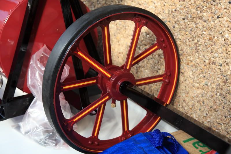

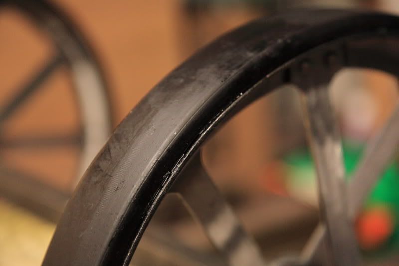

Needed to nip down town to get more isolflex, 50 minutes round trip. Never mind. Got the rubber on to the rims so sitting on the axil supported on a block so the rubber is not taking weight. Put the rubbers on as a dry run, then went for the full hog. Took 5 minutes a wheel to do the final. Not overly messy either.

Isoflex looks dark in there.
Nickle plating out again.
Wheels with the rubbers on

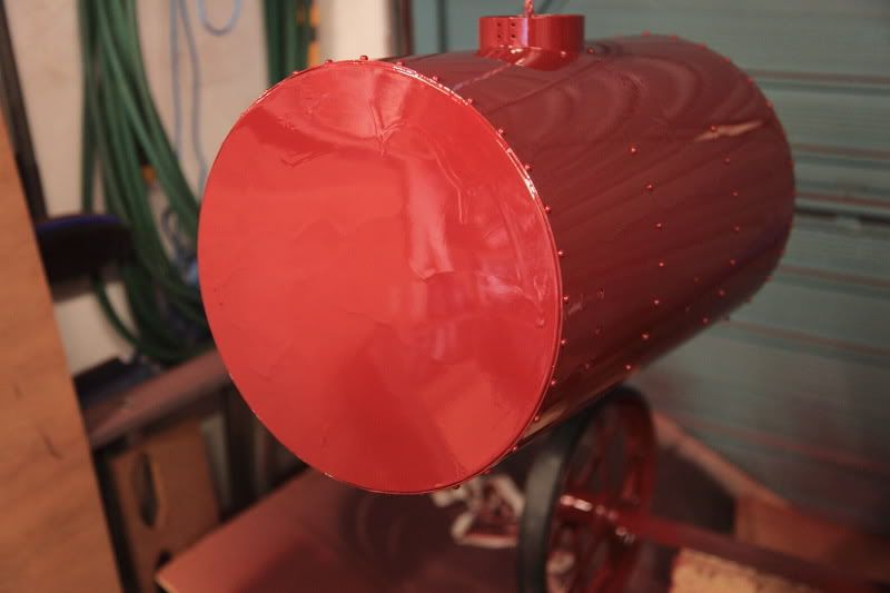

1st Aug 13:30
Post  lynnr on Mon 01 Aug 2011, 1:41 pm
Well
progress will not be at a halt. Now waiting for the paint to dry Very Happy
Couple of runs and sags but these will be rubbed down as it is only the first coat.

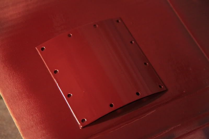

Tank inspection cover painted.
Wheels
and the tank

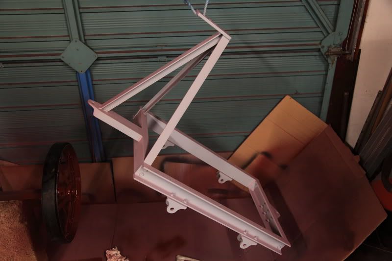

Did also get the chassis in undercoat as well but not enough room to do the black spraying.
So that is that for the weekend. Depending how tomorrow goes I may get the colour sanding done on the tank in the evening. Otherwise it will be left until next weekend.

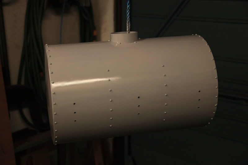

Painting

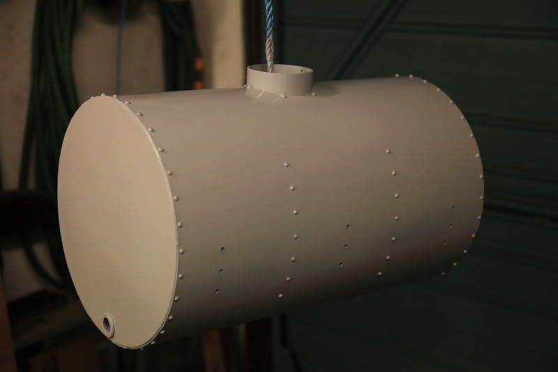

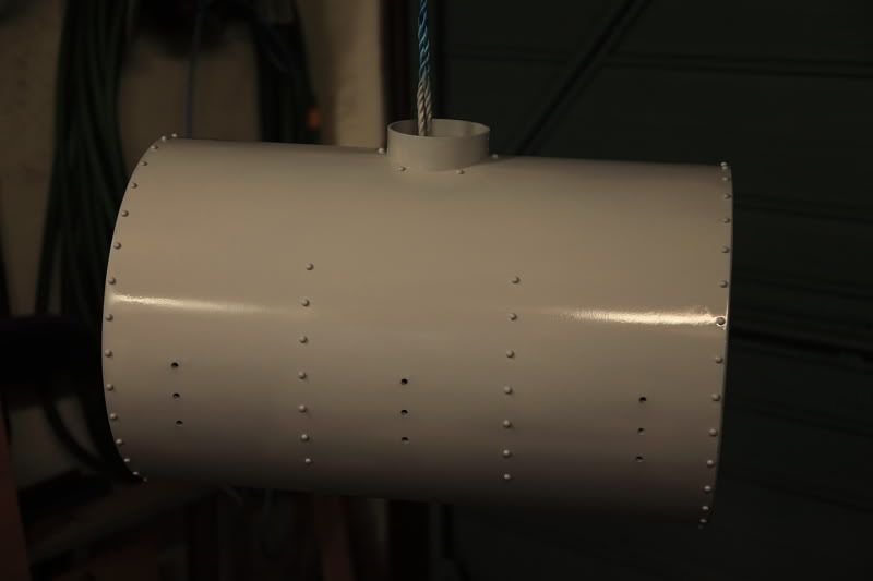

Post  lynnr on Thu 04 Aug 2011, 6:31 pm
Well after rubbing most of the paint back off last night I thought it better to add some more.
Finish is much better tonight but a fair bit of spray in the air so no camera in the area.
Will get a couple pics tomorrow.

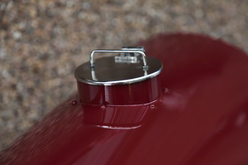

Bit of bling

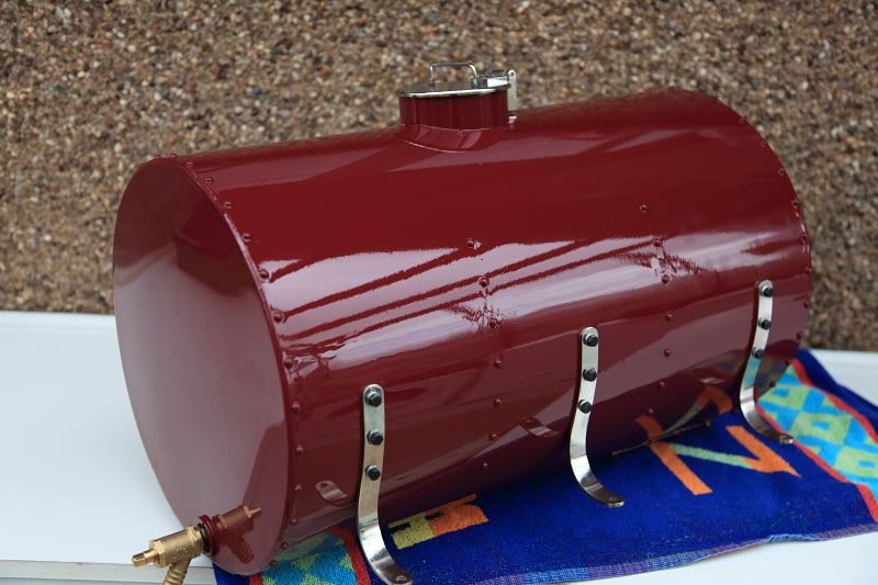

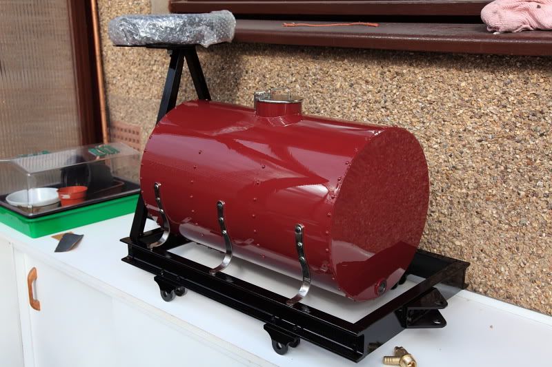

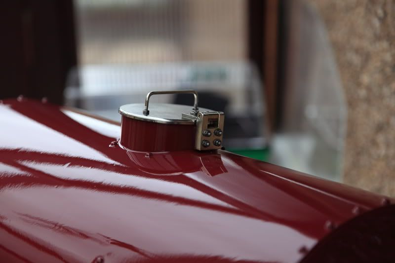

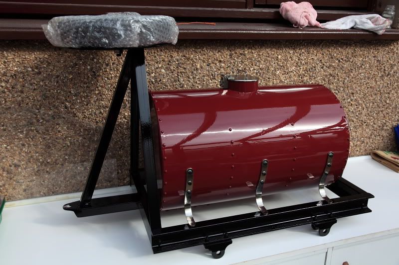

Post  lynnr on Fri 05 Aug 2011, 7:10 pm
Just a couple of pics
Tank now finished. Got tha chassis in the paint booth and in black drying
Not sure if I will line the tank or not... ponder

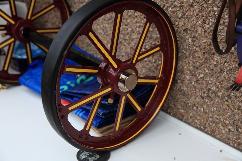

Now that the paint has had a week to set off nice and hard. It is time..... for lining out, coach lining or pin-stripping (cross out as required). So hopefully some pictures this evening. Of course this is when I get home from work. Wheels are going to be the same as the SRL. Not sure on the tank but once the paint is in the Beugler we will see if a particle of inspiration hits the right spot. Not having found any pictures of a full size water cart can not see what was normally done to them.

I suspect very little, as they were normally at the back of the road train. I lined the tank on mine to tie it in with the engine, but left the wheels plain.

Got the yellow on. Should be doing the red tomorrow evening.

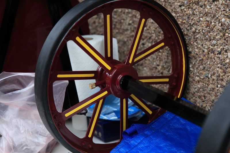

Done the lining
Post  lynnr on Sat 13 Aug 2011, 4:21 pm
Hi all
Wheels now lined out.
