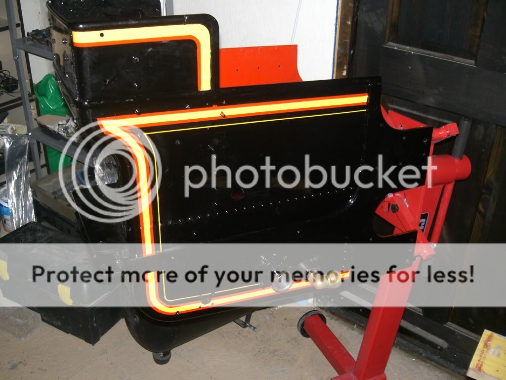

The technique Kev has mentioned I have used to good effect in places and marked out the line with a china graph pencil first to use as a guide.
I found that it you place a finder where you want the bend to start and then pull the tape as though to stretch it.. Just as you feel it giving slightly move your finger along the tape to stick it down . continue this practice all the way along the curve you require. If you mark out teh curve first with a china graph pencil it helps keep a good profile.
I have also used the cutting compass and masking film extensively. I have found it bleeds very little leaving crisp lines.
I used this technique for the tender curves. I first did all the straight lines using tape. I then set the compass to cut the right curve and stuck the cut film up to the straight lines I had painted and let dry over night. I was a little concerned about the matching up of the paint but you can't notice the joins at all.
I was contemplating bringing the compass cutter and masking film to the open day to show those who may be interested.
Taken with flash... makes the paint look a horrid colour...
It was also mentioned in another thread about engine stands. You can see one been used in this photo.
