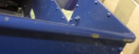

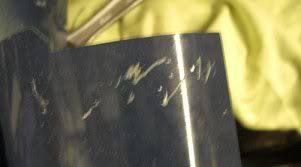

Post  hughb on Fri 13 Mar 2009, 8:59 pm
I was painting up as I went along but in an bit of a bash I now have scraches and some bad damage.
So now letting it go and doing it at the end here are some pics .
bounce so now do I tuch it all up or marsk it up ??

Post  BUNGLE on Fri 13 Mar 2009, 9:36 pm
THE BEADING ON THE TENDER WOULD NORMALLY BE BLACK, SO YOU COULD LIGHTLY FLAT THE DAMAGED AREAS (MASKING TO PROTECT THE REST), CLEAN, RE-MASK AND PAINT BLACK, THIS WOULD LSOE THAT DAMAGE.
AS FOR THE TOP PIC, I CAN'T MAKE OUT WHAT PART IT IS, BUT DOES LOOK LIKE IT WOULD NEED COMPLETE FLATTING AND REPAINTING TO ME.

Post  hughb on Sat 14 Mar 2009, 8:01 pm
BUNGLE wrote:THE BEADING ON THE TENDER WOULD NORMALLY BE BLACK, SO YOU COULD LIGHTLY FLAT THE DAMAGED AREAS (MASKING TO PROTECT THE REST), CLEAN, RE-MASK AND PAINT BLACK, THIS WOULD LSOE THAT DAMAGE.
FIRST RULE IS DON'T PANIC, WE ALL COCK IT UP FROM TIME TO TIME ! Smile
HOPE THATS HELPS A LITTLE.
REGARDS
BUNGLE
Hi Bungle
Thanks for this I was going to paint the inside black but not the beading .I like it .AS for the top pic it is the boiler cleading......

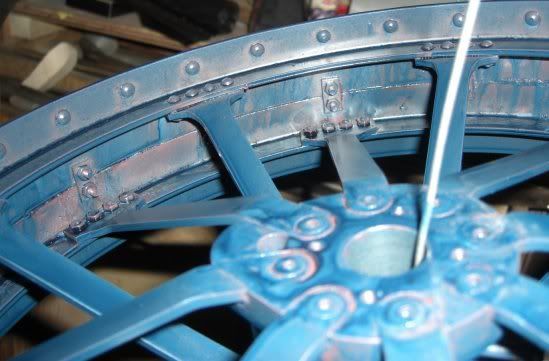

Post  hughb on Sat 14 Mar 2009, 10:11 pm
Hi I have just been on the other fourm talking to a frend he says to ask you guys about this prob
As you can see it is like the paint is seethrough .
Before I went it was looking good.. Then this happend
It was all mixed up at the same time and it was warm and dry for the spraying condishons
Has any one got an idea why this would happen???

Post  TonyT on Sun 15 Mar 2009, 12:30 am
Hi hughb
First of all,welcome to the forum.
Well there could be several reasons why your paint didn't stick to your rear wheel
1; Have you degreased the parts?
2; Have you gone over all the parts with production paper to get a key for the paint?
3; Have you used a primer before your top coat,how many coats,and did you key them in between coats?
4; Have you tried to put too much paint on in one hit?
I'm afraid to say but painting bare metal and getting the right finish is a case of the 3 P's
Preparation,preparation,preparation Exclamation
My rear wheel's took a week to get them painted and I was glad when they we're done
As for your beading on your tender,and all other brass parts you wish to paint,you must use an etching primer first on them or else you will never get paint to stick .

Post  BUNGLE on Sun 15 Mar 2009, 9:33 pm
I'D AGREE WITH ALL TONY SAID, BUT I WOULD ALSO SAY THAT IT LOOKS LIKE YOUV'E MIXED YOUR PAINT VERY THIN. HOW ABOUT YOUR SPRAYING TEMP AS WELL ??

Post  northburrell on Mon 16 Mar 2009, 11:24 am
Yep I would say too thinned top coat and it's mixing with the red base making it look like it's bleeding..
I went for enamel paint on the inside of my tender not sprayed but brushed on to give a better harder paint for were it's going to be getting knocked about...
no matter if you use etch primer, paint still wont stick to brass that well really, better than normal primer but still not like it sticks to steal..

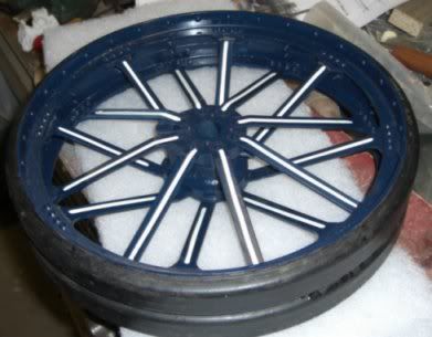

Post  hughb on Mon 04 May 2009, 11:26 am
Well I have now done some of my painting .First thanks to all your help on this .As if you look back you can see how bad my wheels were. So here they are now I have just done some of the pin striping on them .Firts time I have done it here are the pics.

Post  LilyJack on Mon 04 May 2009, 5:19 pm
Hugh
I'm DREADING doing the lining work, yours looks a good ole job there chap....Wheels DEFINITELY look better than the last shots taken thats for sure..

Post  hughb on Tue 05 May 2009, 8:53 pm
Hi thanks
I have to do the black pin stripe on my wheels yet . I have just used the pin striper like my marking gajes .
It was dornting but I am doing well .I gess after 4 more years I willl be ok Smile Laughing Mad
