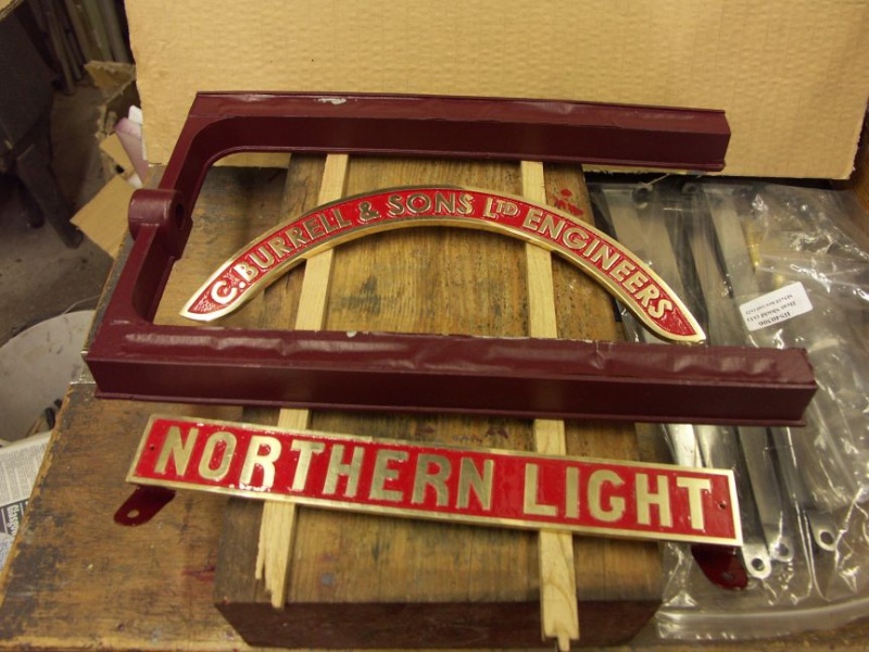

Here's the name!! Unfortunately, I read the warning about "Brasso", too late, so will have to repaint!!:-

Tony thats a beast there my friend I cant believe how big the thing is.. I see you found out how destructive brasso can be! just drop the plate in some paint thinners and repaint it and it'll be fine.. use some good silver polish and dont use a polishing wheel either as this can burn the paint too.. just take it nice and slow and polish it up by hand when your not busy building the rest of it..I use a small polishing wheel that you get with dremels just in my finger and not on the dremel. works well to help polish up the brass..

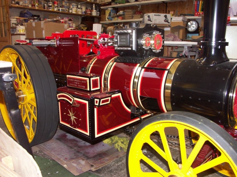

Post  Tony King on Tue 29 Nov 2011, 9:48 am
More pics............
The eccentrics in their new levery:-
I managed to get the lining wrong on the exciter platform, so had to wet & dry back & start again!!:-
The eccentrics all back in place on the crank:-
The engine without the exciter platform!:-
Now got to dream up a "northern star" logo to go on the heat sheild:-
Just love all those rods & pins & "stuff"........ As usual, now all polished to showman's standard!!:-
Another view from other side, just can't get enough!!:-
The "proud" name!:-
The repainted exciter platform resting in its place!:-
The engine to date!:-
Hope you enjoy pics................ Can't wait for the next kit now! Very Happy
