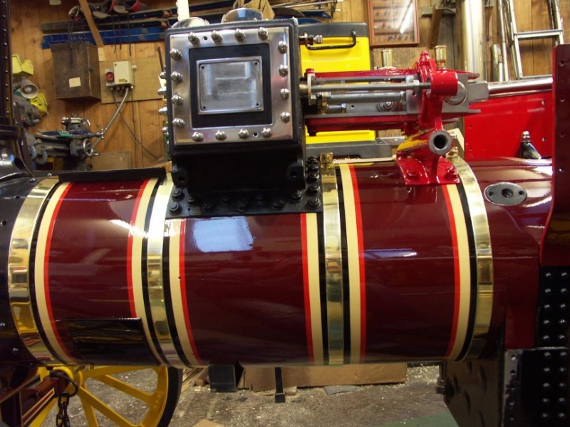

Post  Tony King on Fri 07 Oct 2011, 12:10 pm
Unlike you lucky people in the south with your hot weather, we up here are facing snow on the hills!!!
Anyway, due to "orrible" conditions, I'm cracking on in the workshop with my engine, rather than doing what I should be doing outside!!
And lovely it's looking too!! So here are the latest pics of progress:-
Finished wooden cladding, & setting up of the con rods.
Having cut & filed & fitted all the cleading, took it off & squirted loads of paint at it. The dining room table being beside a nice warm Rayburn is the perfect place to get it dry quicker!!! Not everyone appreciated this for some reason!!
This pic shows weighshaft bracket etc painted & woodwork held in place with insulting tape!!
The cleading starts to go on, & freshly polished brass bands add to the effect.
All now in place & no scractches ............... YET!!!!
A view of the motion work, pitty this will all be covered up on the completed showmans, but, I know it's there!!!
A view of the other side.
Just have to wait for the paint to harden off abit more, then start with the masking tape to get some lines on!!
I still haven't lined the wheels yet, hopefully the next kit will arrive from STW before then!!!

Tones Engine
Post  Tony King on Wed 12 Oct 2011, 8:06 pm
Just thought I'd put up pics of cleading now the lines are on:-
