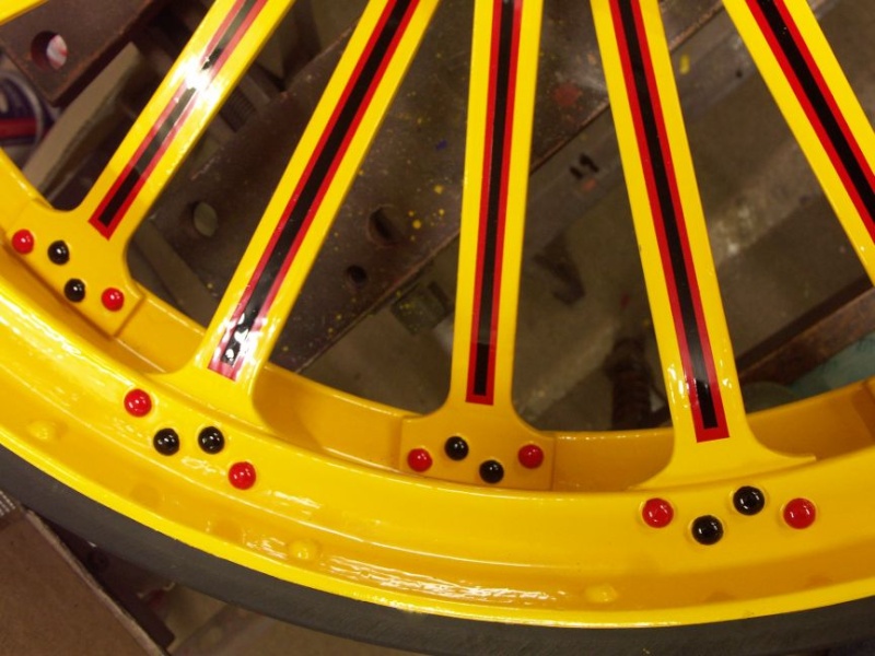

Post  Tony King on Fri 10 Feb 2012, 1:11 pm
In my spare time this week, I've been pondering how to paint the wheel rivet heads. To that end, I made a masking tool out of a penny washer & attached a handle to it!! I opened out the hole with a counter sink bit, untill the washer almost sat at the "root" of the rivet head. As you can see in the first picture I had to file away quite a bit of the washer so as to get it in among the rivet heads on the wheel rim.
"The tool":-
How it works!!:-
The first spots!!:-
The second load of spots:-
The complete picture:-
I have to say, it's not a perfectionists job, but if you don't get too "close", at a quick glance, I think it looks OK!!

Post  lynnr on Fri 10 Feb 2012, 1:18 pm
Sorry I have to disagree with you there Tony.
Even at close range it looks very good! Very nice indeedy!
