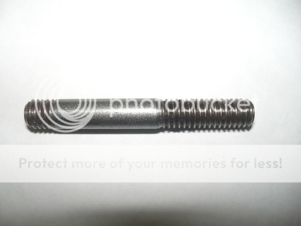

Can anyone explain to me what the two extra long engine studs are for in kit 10?
They have a short thread at one end and a long thread at the other.

I think you'll find they are for the left hand crank bearing. When STW machine this, they clamp the bearing holder parts together with a pair socket headed screws which are exchanged for the studs you have found. Looks more like the real thing, then!!!

I was also puzzled by the studs until I looked at the right as it had the nut and 1/2 nut arrangement. So copied that.

My only issue is when I put the studs in they go so far in I cant get the lock nut on the top, so have to turn them out a few threads and then they're loose......?? Should I loctite them??

Not good engineering practice to leave them loose and use loctite.
Lets hope STW supply some the correct length !!!!!

yes, i can confirm that the studs are to replace the cap heads in the LH bearing housing.
yes, they are too short and yes we will be sending out replacements (apparently it only affects the first 20 kits to go out).
