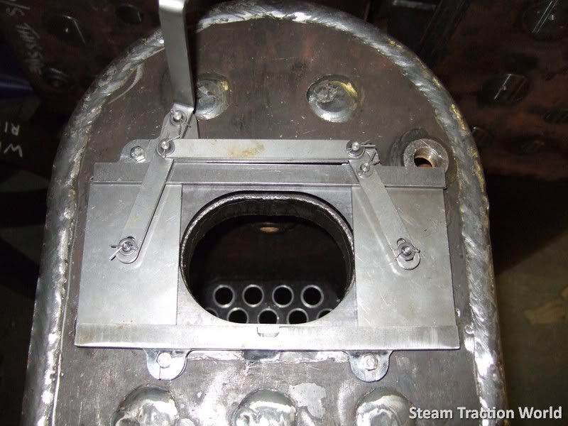

Can anyone tell me the size of the fire hole opening in the backhead? It is to help me identify the correct shovel size. A little premature I know but someone is trying to get properminiature shovels made with wood shafts to mimic the full size ones.
I think it looks nicer than one with a bit of steel bar for a handle - no disrespect intended to those who already use such a shovel!! Laughing
Re: Fire Hole Size?
Post  craig@STW on Fri 25 Feb 2011, 8:11 am
fire hole is 99mm wide and 75mm high Cool

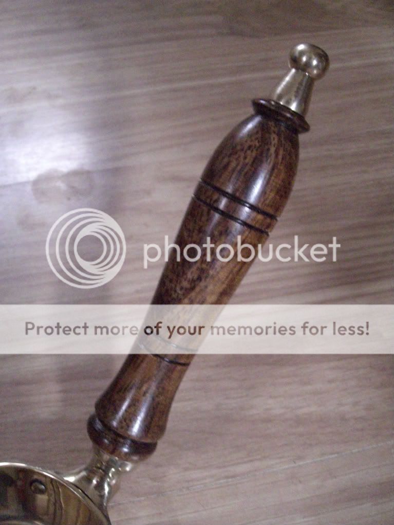

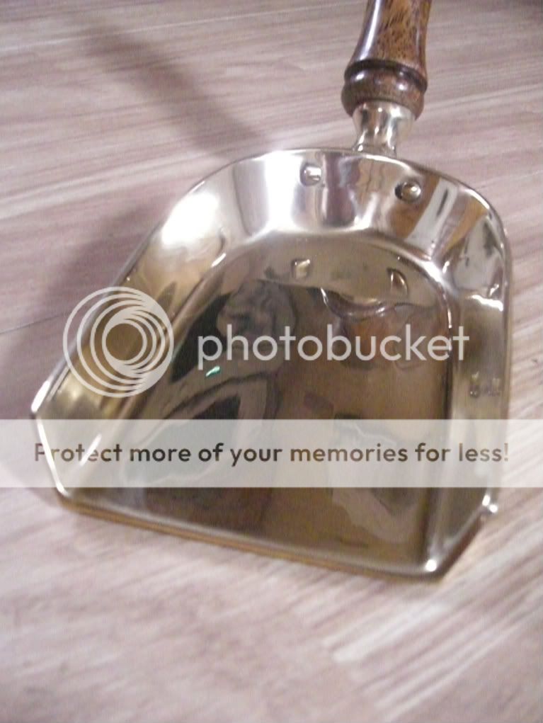

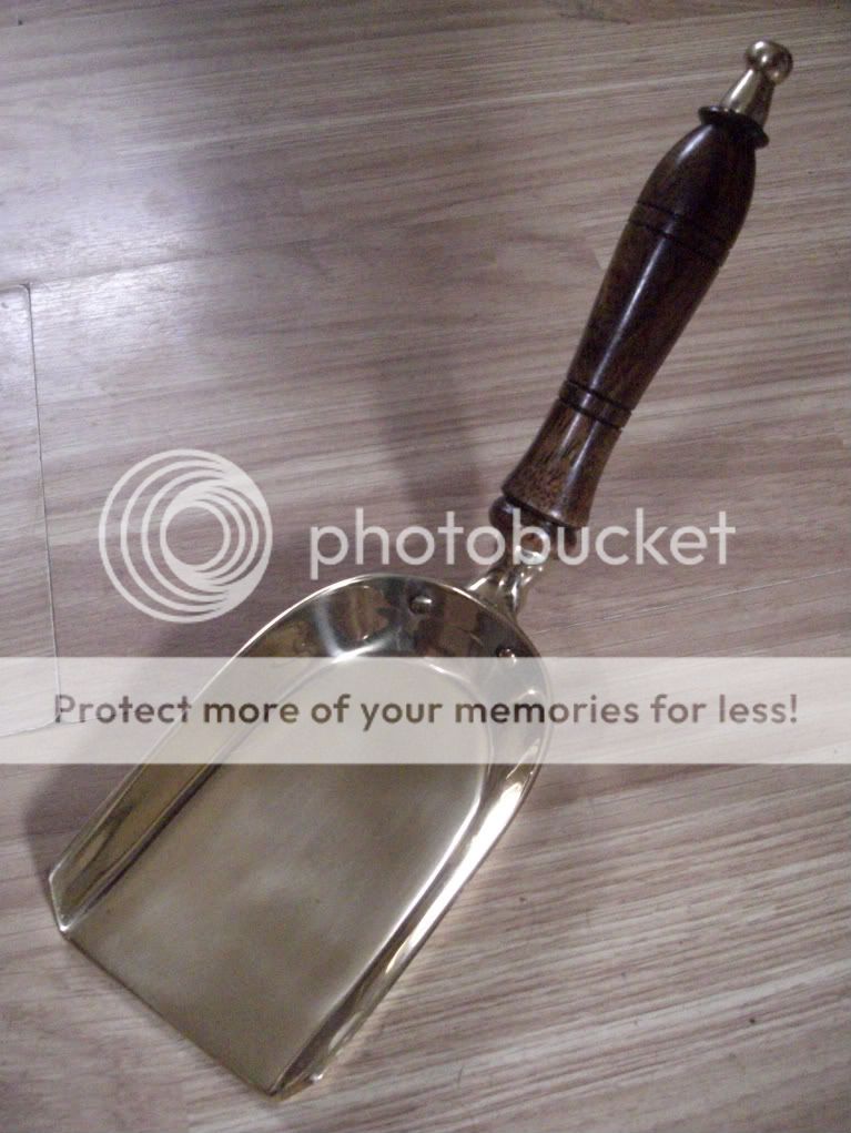

Post  sonick45 on Fri 18 Mar 2011, 1:42 pm
I got a gift yesterday which was nice.
It's a Solid Brass shovel (nice and heavy) with a wooden handle.
90mm wide which should fit through the 99mm hole nicely.
Just need to finish the engine now... bounce
Number of posts : 483
Shovel & a half!!
Post  Tony King on Fri 18 Mar 2011, 3:44 pm
Now that looks like a Showmans shovel if ever I saw one, very shiney & very sophisicated, the eggs & bacon should just slip off there a treat!!

Post  sonick45 on Fri 18 Mar 2011, 7:47 pm
It's a coal shovel yes. sold separately. believed to go with a coal scuttle. (Or a bunker).
it's to small to go with a fire/stove set. would look odd.
