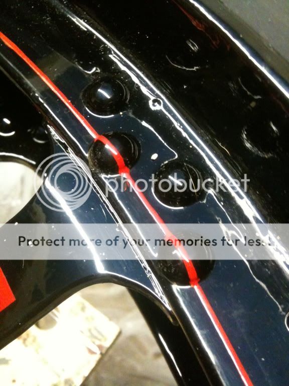

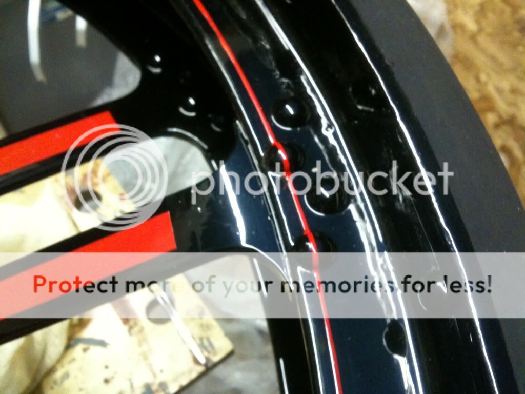

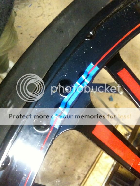

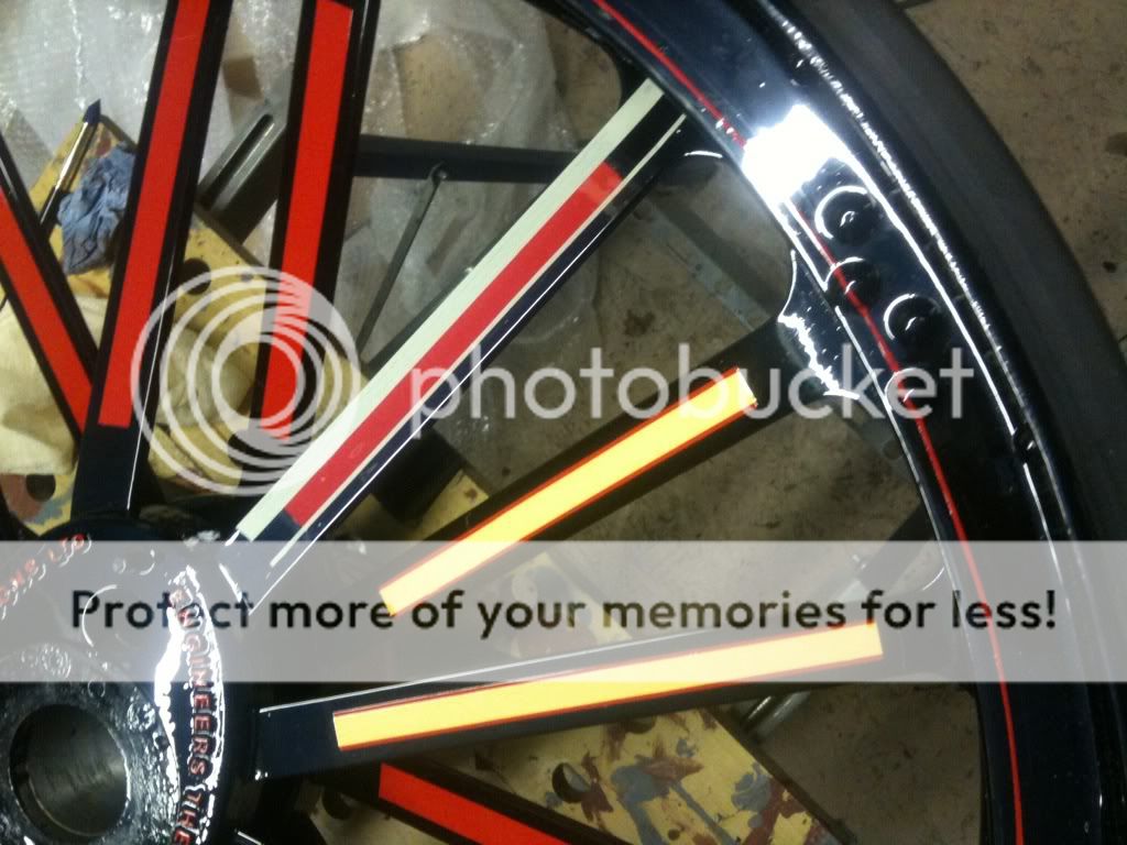

For those of us that have chosen to paint our engines using the Presidents scheme the thin red lie around the rims was easy on the fronts but the rears are a slightly different story.. Unfortunately the rivet heads are closer to the edge than on the original and the red line will need to flow over these making it a lot harder to paint.
I have decided to tackle this line first and use pin-striping tape as with all my other lines.
It's still work in progress but i think this will be the easiest way using the lining tape technique.
I plan to tape over the heads once the lines in between have dried. This will give me a much greater chance of getting the line straight.. I hope.

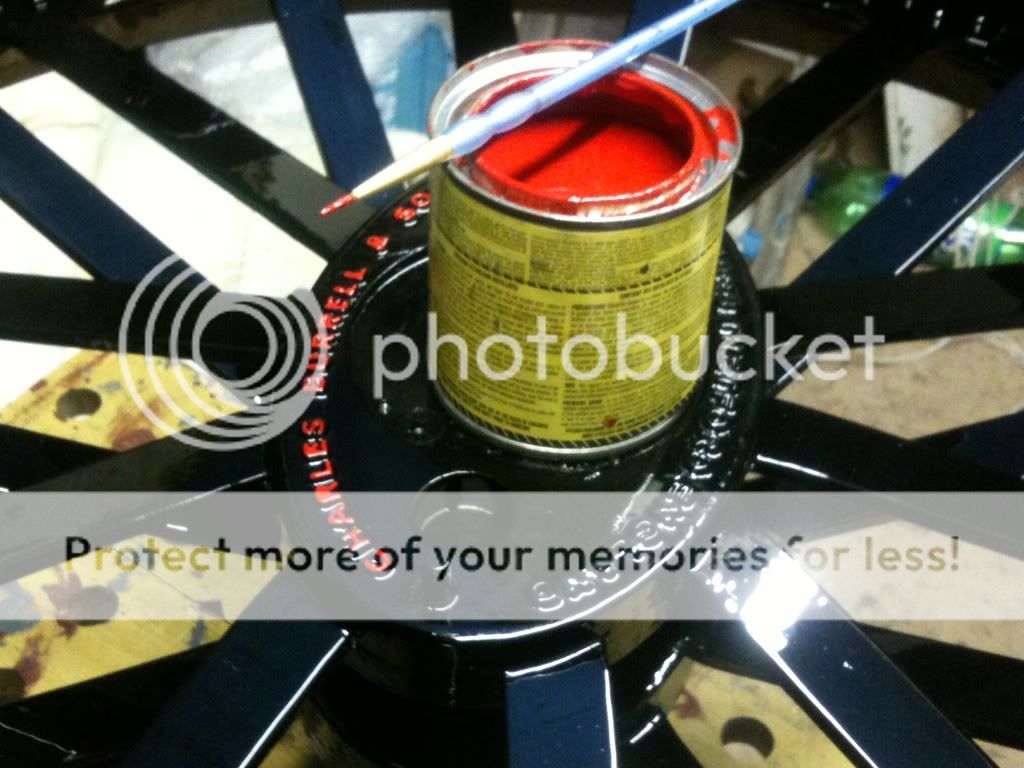

Post  sonick45 on Sat 20 Nov 2010, 9:36 pm

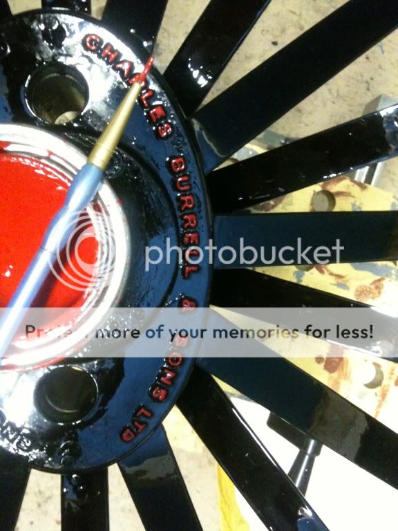

Started tackling the hub lettering tonight.
Had a little bleeding over but noting a touch of black wont cure..
All in all really pleased with the finish..

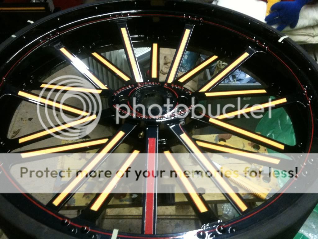

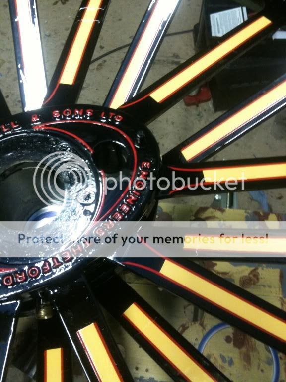

I had been building up enthusiasm to tackle this one.. the thin line that flanks the outside of the gold on each spoke. As there are 20 spokes on each wheel it is certainly a labour of love, and having done the previous 4" it is quite a struggle getting to the top and bottom of the spokes as you just cant get your hand in. But this time I decided to do a couple at a time rather than tape up the whole lot and hit it all in one go and it is certainly making it much easier to cope with. Also the wheel doesnt seem as deep as the earlier engine meaning it is possible to get to the outer ends of the spokes. The inner end is a different story and requires a very fine brush and steady hand to finish the "fish tail" ends. As you can see the lining tape is applied and then the ends are manually brought together to taper the line to a fine point, and I'm very pleased with the result.

Post  sonick45 on Mon 22 Nov 2010, 8:25 pm
Highpressure your wheels are looking amazing .
It's interesting to see all the different techniques people have to lining.
I see you have put down the yellow first then bordering with red.
I plan to do exactly the opposite red first followed by yellow inlay finishing with the fish tails last.
Having seen how you are doing the fish tails I may do the same as it will help with tapering the ends.

Post  highpressure on Mon 22 Nov 2010, 9:23 pm
Hi Rick,
Thanks it makes the effort and troublesome bits worthwhile. We all seem to be making a good job though. What I have done is put the tape on with just a slight bend in the end , then once the top bit is off just tease back the last few cms and then just run them together. It takes a couple of trys to get it right but it can be done with patience. Tonight I did all the spokes that finish on the outside of the hub. Ths inside ones are more tricky but the best thing I have in the kit is the rub out tool which allows me to clean up any rough edges or bits where the panit creeps under the tape, well worth buying. I wasnt aiming to make a show stopper but having paid a lot ao attention to detail I am really pleased witht he final result and certainly hope to turn a few heads, It just makes waiting for the boiler all the more difficult because when it all hangs together it will give a good idea of how it will all look when finished. Roll on February cheers cheers cheers

Post  sonick45 on Sun 28 Nov 2010, 9:02 pm
been spurred on by seeing Kev's wheels i've continued to line the rears.
This is my progress as of tonight.
The thin line over the rivet heads were fiddly and although up close they aren't 100% perfect when you step back they look really good as they sweep over the bumps.

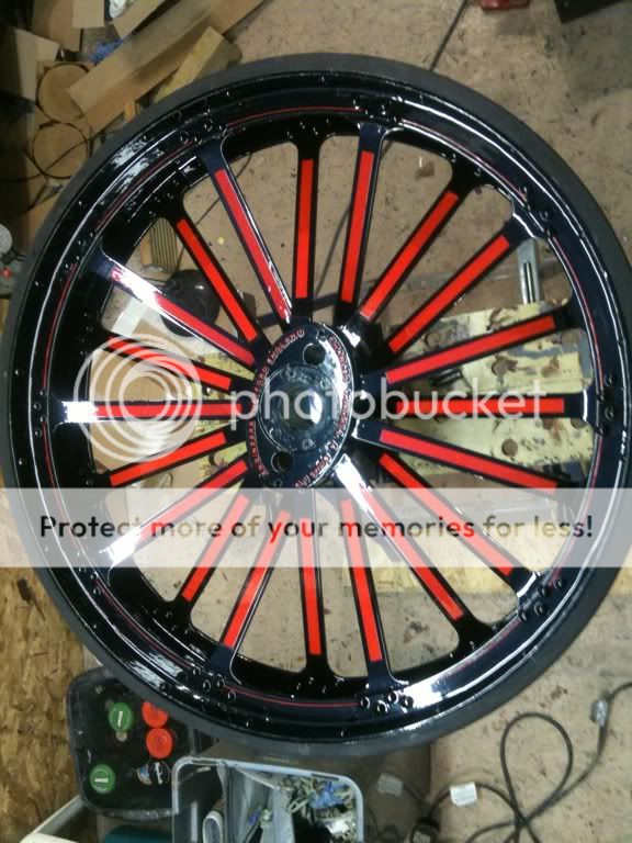

Post  sonick45 on Fri 03 Dec 2010, 4:12 pm
slow but steady progress.
Finished the inside lines on the hub and made a start on the fish tails.

Re: That thin red line......
Post  sonick45 on Sat 04 Dec 2010, 8:35 am
lynnr wrote:Hi
Looking really good! Are you just using tape?
Yes and plastic masking sheets with a cutting compass for the fish tails.
