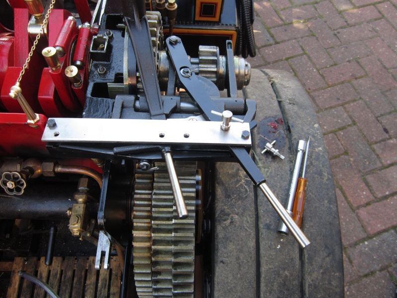

Having got all the latest stuff back from the platers and being in the fortunate position of having the next four weekends with rallies on I have been busy in the evenings reassembling everything to have a trial run this weekend. Wanted to see how the gears are and make sure it all survives. Sadly this wasnt to be as the water pump drive locked solid, broke the nylon gear and needed the whole crank out to sort out but I can report that the engine can drive comfortably with two full grown adults on a twin seat on tarmac roads with no issues at all. Also first is very low geared which as demonstrated at the last outing is fine for crowded rally fields. Second is comfortable to run steadily on a road without too many dramas and third is great, clipping along well without feeling like the motion is flailing away like mad.
Also for those that havent read about the mod on the third speed hub this repair would have been very tricky if not impossible with the crank in place. Also without The Colemans help ( Andy2 ) I would have been lying in a darkened room crying so Thanks once again Andy, invaluable experience for you also.
Gear levers and associated bracketry, black is black nickel and silver is clear nickel, shouldnt get rusty at all now.
Third gear engaged showing mod on hub in place to get acces to bearing cap, rotating 180 degrees allows crank to be lifted clear of bearing without taking second and third off, or the roadwheel and gear cluster.
