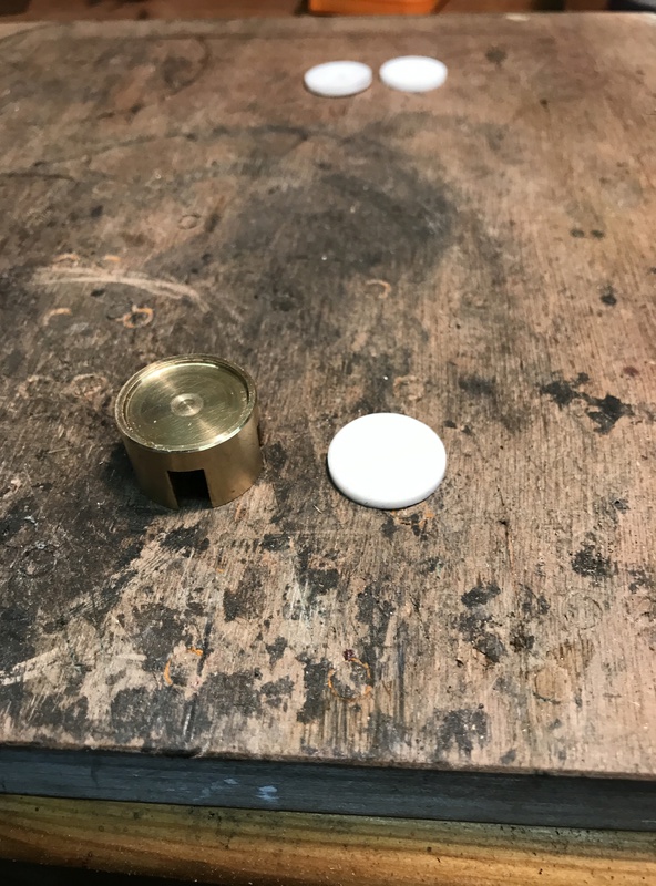

Post  Steve Traill on Tue 11 Jul 2017, 8:59 pm
Thought I'd try fitting a ptfe seat to the regulator block.  First of all I machined a new puck only 1mm shorter, then machined away a recess about 1mm deep.  Then from a chunk of ptfe bar made the 2mm discs you see in the pic.  I did a couple of spares as I don't know how long they will last.  For some reason the pics have gone sideways, still you get the drift.
It's a pretty snug fit so don't see the point in trying to glue it yet, lets see what happens!
Update after the next steaming.
Number of posts : 727
Re: Thetford Works (Cornwall)
Post  LiveSteam on Tue 11 Jul 2017, 10:14 pm
This will be an interesting experiment, must admit my PTFE mod on the globe valves are one the best things I've done on our MW Agri.
My only concern might be how well it will copes with the friction and especially once its been left stood a while and you get a little rust build up on the cast seat ??

Post  mikero on Tue 11 Jul 2017, 11:03 pm
I have seen PTFE used as piston rings, CNC machined from tube into a spiral spring. Not sure how long they lasted though.
Number of posts : 254

Post  Steve Traill on Thu 13 Jul 2017, 7:34 pm
I've heard that some of the full size engines are fitting ptfe plates on the regulator block so if it works for them it should work for a miniature. Years ago I pondered making a complete block out of ptfe but decided it probably wasn't strong enough. Just fitting a disc in under the regulator block means it is only under compression and is easily changed. I haven't even glued it in, it's just a snug fit. I wasn't sure if araldite would have coped with the temperature and I didn't think silicone would stick to ptfe.

Post  mikero on Fri 14 Jul 2017, 1:32 am
I would worry that there would be erosion at the point where the puck first opens, especially if you have filied a vee in the delivery hole.

Post  Steve Traill on Sat 15 Jul 2017, 10:48 pm
I've decided to go down the SS plate route, I've been milling a plate today 1.5mm thick to bolt on top of the cylinder block like the Road Loco's and I believe all new engines from the STW stable. The problem with cast iron is it rusts and that puts grooves in the brass which lets the steam leak. I hope that with a stainless steel base & a ptfe slide it should be leak free & last a long time. Boconnoc will be a good test!

Post  LiveSteam on Sun 16 Jul 2017, 10:37 pm
Steve Traill wrote:........... The problem with cast iron is it rusts and that puts grooves in the brass which lets the steam leak.
Yep my MW agri brass puck looks like the Himalayas Laughing and yep it does let by, I've wondered about polishing it out and getting it to seal fully but kinda like the fact it will tick over very very slowly, there's zero power in it as you can stop the flywheel with your little finger, I call it a design feature Laughing
Number of posts : 522

Post  Steve Traill on Sun 16 Jul 2017, 11:10 pm
In the building trade we turn a f**k up into a feature if we can! I just like things to be right and if it should stop with the regulator in the off position then that's what I aim for. Hopefully the mod will improve things, I just wonder if the ptfe is hard enough, only time will tell. If it works it's a simple mod for STW to incorporate and make their engines even better.

Post  Steve Traill on Fri 04 Aug 2017, 8:35 pm
Just an update on the modification I did to the regulator puck, here's a pic!
As you can see it melted and was sucked down the hole leaving the regulator jammed wide open.  Fortunately it was stationery at the time and heavy pressure on the flywheel stopped it going into self destruct mode until we dropped the fire & blew down to release some of the pressure.  It was going so fast that putting the reversing lever into the middle notch meant that it still ran like the clappers just on momentum.  Bit scary for a few minutes, so ptfe disc on the regulator puck is a no no.  It was all going so well too, it was only two & a half hours in that this happened.  Back to the original brass puck no with no side effects.
