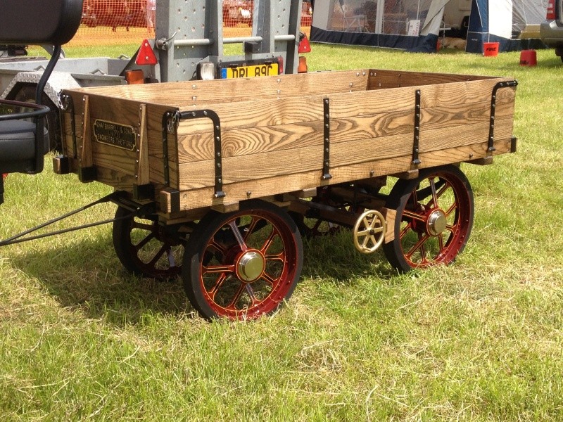

Also the traction wagon has seen some spanner action, went to move it to take to a rally and the springs fell out of the hangers at the back (this time) so have drilled and riveted holding straps to the fifth leaf down.  It has worked on the front and now works on the back.

Post  lynnr on Fri 26 Aug 2016, 9:39 pm
Looking good.
I also have a "R" clip through the brake handles as both my wagons would randomly wind on the brakes as they are so free running. Due to road vibration.

Post  Mark the spark on Sat 27 Aug 2016, 1:40 pm
Hi Steve
what does the plate say on the front of your wagon?
thanks Mark
Mark the spark
Number of posts : 195
Location : Edinburgh
Re: Thetford Works (Cornwall)
Post  lynnr on Sat 27 Aug 2016, 2:54 pm
Hercules. If I remember correctly.
