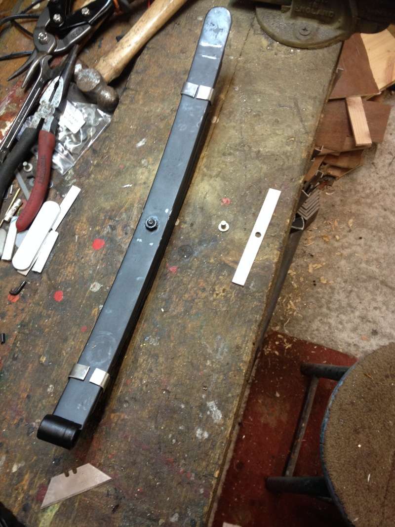

SOFT SPRINGS
Post  Steve Traill on Sun 03 Apr 2016, 5:13 pm
On little problem I had when I thought I'd finished the wagon was I went to lift the front up to move it around in the workshop and the front axle fell out of the hangers!  The springs are very soft and the weight of the axle is enough to bend them out of the hangers which then means the pin has to be removed to get them back in, just what you want in the long grass at a rally field!  I tried moving the rear hanger closer to the front one which helped a bit but it still dropped enough for the second leaf to jam the wrong side of the pin.  Thinking about old leaf sprung cars I've had in the past they always had clips to hold the leafs together but allow them to flex.  I tried this firstly by bending a bit of aluminium around the five largest leaves to hold them together, it worked!  The ally looked horrible but proved the concept, I then looked around for something from the scrap bin to make the clips.  A bit of brushed stainless steel caught my eye so I used that.  I found some short rivets with a flat head, then the problem of drilling spring steel.  I have a set of those drill anything drills one sees at Dorset & other shows.  I thought here's a good test, put a 5mm drill in the pillar drill and managed to drill four holes before the drill mushroomed out.  The steel is definitely spring steel as it's very hard to drill but those drill anything drills did it (just).  I cut four little straps & riveted them onto the end of the fifth leaf.  Assembled then spring and wrapped the strap around it.  Put it all back together and no more dropped axle.  For some reason, that I haven't quite fathomed yet, the rear fixed axle doesn't do this yet the springs are all the same.  One of lives little mysteries no doubt.  By the way anyone building one of these trailers the springs are hand made and come as a set, don't mix them up when taking them apart for painting as it's a pain matching them all up again     Here's a couple of pics.
Number of posts : 717

Post  Kevster on Sun 03 Apr 2016, 6:08 pm
I had the same problem but only on the rear springs, not fixed yet I may fit some restricter chains or maybe Steves solution.

Post  lynnr on Sun 03 Apr 2016, 6:49 pm
On the fronts I have done nothing and one wagon the rears are as per STW. As long as I lift slowly they actually stay put. I only ever lift one wagon to double stack when in Crystals bedroom. Never need to lift when out at rally as on the trailer they park line astern.
So really it is not a big problem unless you really need to stack them all the time.
