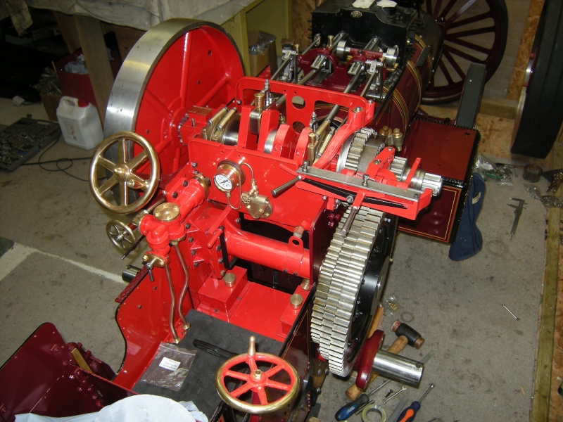

July 2014 update
Post  Steve Traill on Wed 09 Jul 2014, 3:09 pm
Here's a few pics of the Deans Showmans to date, looking to bring it to Dorset finished so have my work cut out!  Hoping to steam the engine in two weeks time, actually it would steam now but waiting to do the regulator mod first.
Number of posts : 733

October update
Post  Steve Traill on Sun 26 Oct 2014, 10:19 pm
It's been a busy few months, mainly completing Deans engine, see below:
Here it is having it's cylinder block changed.
Roof frame in position, it all fits well.
lights all working!
Painting the tricky bits before the planks go on.
The cloth is on.
All the fittings in place
My favourite shot of the engine!
Finished & ready for Dorset.

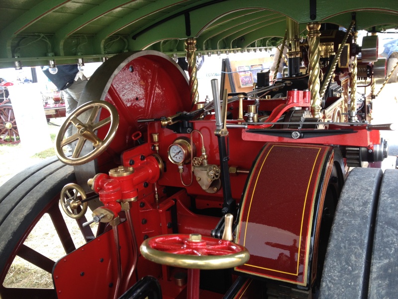

Showmans at Dorset
Post  Steve Traill on Sun 26 Oct 2014, 10:26 pm
On the STW stand.
A rare shot of some grass at Dorset this year!
The battery terminals are so we could demonstrate the lights with a car battery.
