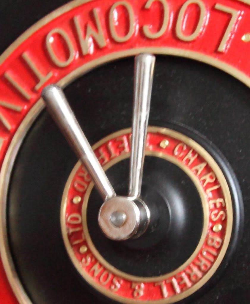

Post  lynnr on Sat 18 Sep 2010, 9:23 am
Got the Nickel plating kit going last night. Quite successful only got a small problem where there seams to be a change half way down a handle a "tide mark" where the nickel did not appear bright. After polishing it appeared fine. Not sure what caused that but I will be trying again later today possibly.
Well here is the result. I do not have my tripod at the moment so could not hold focus with the 100mm macro lense too easily.
Number of posts : 2962
