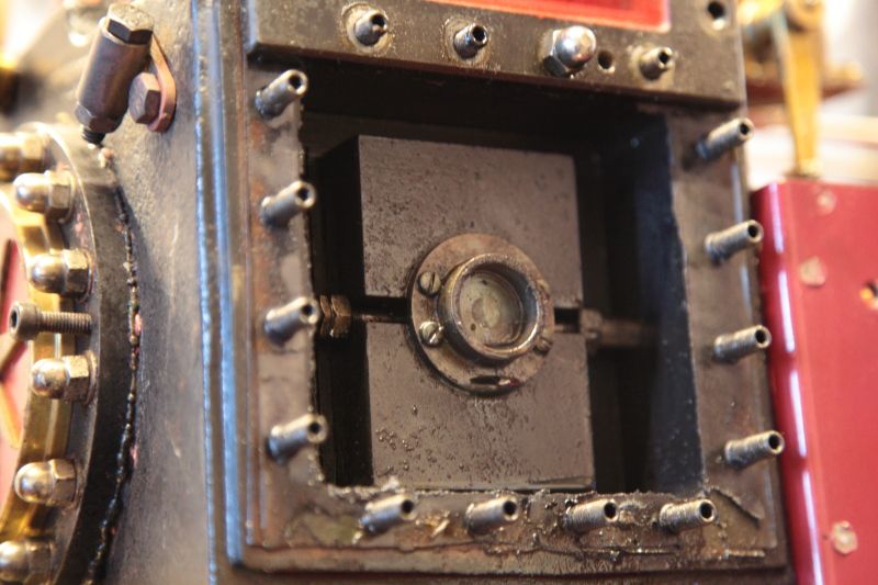

So since the covers are off I checked the starter valve and it is working well
Regulator, as we know, is leaky

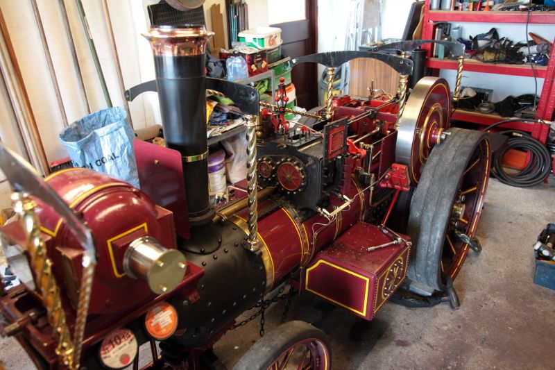

Going in reverse!!!

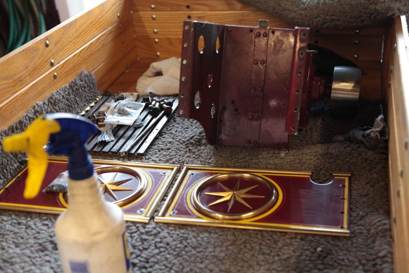

Well stripping down to check for problems and rectify any.

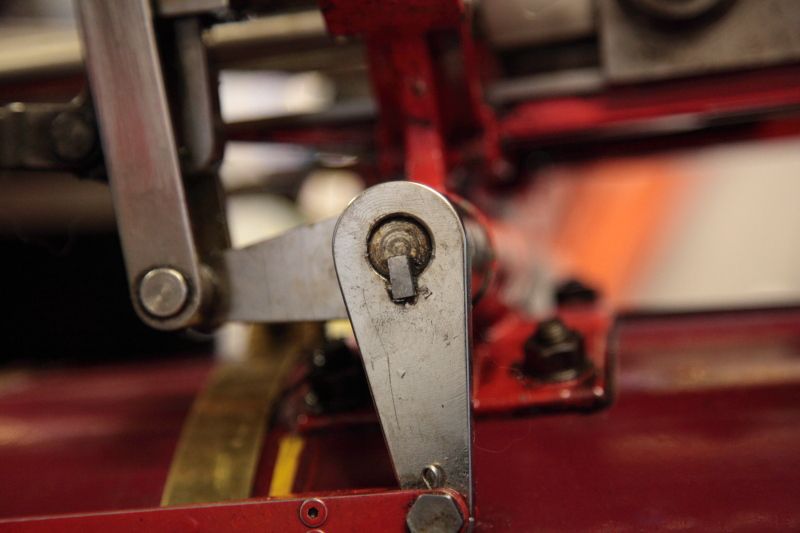

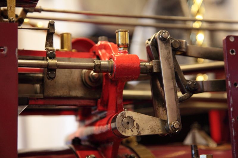

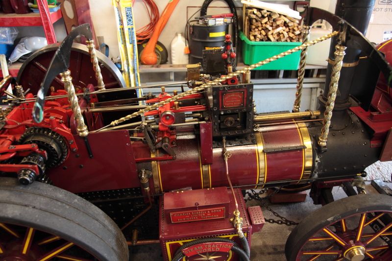

One problem found. The keyway for the Reverser linkage is not holding tight on the shaft. So the expansion links can "spread out" a bit and not run true. I need to pop off the linkage and the reachrod to slip off the offending item and drift out the key from it. I will possibly need a slightly bigger key but I will see. May fit the item with the key and put a taper pin in as well.
She does look strange
Motion covers off to allow cleaning and maintenance

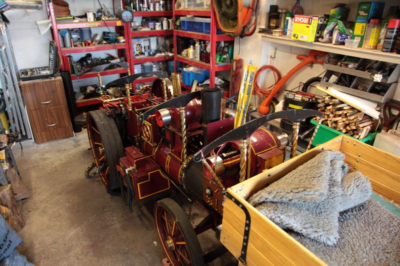

Traction wagons do make handy part storage.
Problem with this. Not held by the key so can wander out and in.

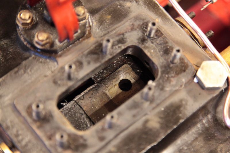

Good amount of oil in the HP valve chest
And the same on the LP. So getting good lubrication
Regulator. Still needs work
Pistons and bores are in excellent condition

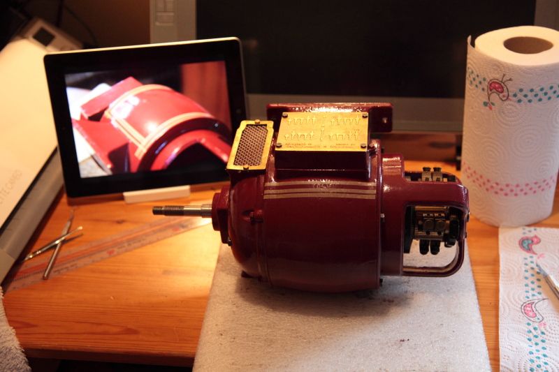

Post  lynnr on Wed 30 Oct 2013, 3:41 pm
Definitely got the arty head on today.
Got some of the lining done on the Exciter dynamo. Unfortunately the masking tape has taken some of the base colour off so it will need touching up. Oh Hum
Using pictures of the main Dynamo being done as reference. Laying out the masking tape.
And the first lot of lining done. Need to leave to dry as the brush cage is a bit fiddly.

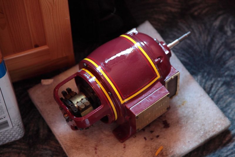

Post  lynnr on Thu 31 Oct 2013, 5:46 pm
Bit more fancy work.

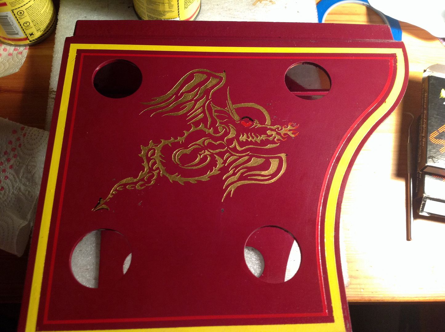

Thought the side of the exciter platform was a bit dull and unmapped. So thought of something nice.
There be Dragons! Still to varnish but that will be tomorrow.  Btw the gold is 1shot metallic gold.

Total disaster!!
Started to varnish the dragon and the craftmaster varnish has reacted with the 1shot metallic gold paint and destroyed the painting.
Number of posts : 2915
