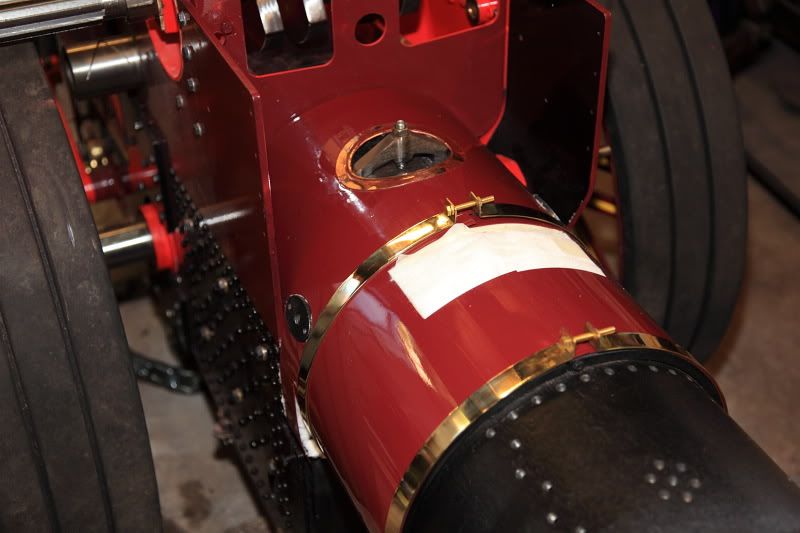

Post  lynnr on Sun 24 Jul 2011, 5:01 pm
Good couple of days. Been fettling the crank. Can move it easly by hand on the end of the splines. Also took the plunge and started painting the cladding. I can put the part with the inspection hole in it in place and the portions above the belly tank. I am going to cut the legs off the parts that go round the exciter platform as the filler plate covers the whole area and means there is 2 layers of cladding in that area. The joins are also under the brass straps. Will do some pictures when the paint is surface dry. I do not go anywhere near the painting area until it has set off.
Number of posts : 2919
Cladding
Post  lynnr on Sun 24 Jul 2011, 7:06 pm
Hope the photos show the gloss of the finish. I have not polished the parts it is just the paint. Couple of dust spots which will eventually polish out.

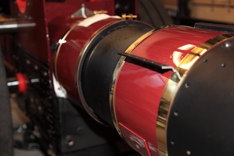

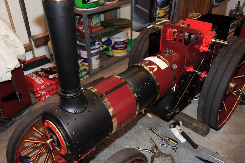

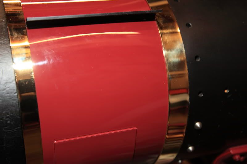

Been doing the cleading last night. I have cut off the tabs on the front two pieces that fit round the exciter bracket as the filler reaches full length in the gap at the top and results in double width of cleading. This does not look right as it is up against the smokebox. Need to do a bit of filing tonight just to get the joints tight. Both joints are under the bronze banding anyway. Cleading portion under the motion works is now in place. Looking very nice, if I say so myself. Got the bronze bands into the polishing mops also and they are looking good. Couple of deepish scratches down at the bend for the bolts but otherwise spotless!
Pictures tonight.
As Promised
Post  lynnr on Tue 26 Jul 2011, 7:36 pm
Photos

Post  Tony King on Tue 26 Jul 2011, 10:30 pm
You must be right up there in front now with your showmans............... looks really good with the cleading in paint!! Well done!!
You now have to protect it, which is a challenge we all face, as I reckon these engines will be taken apart & put together a few times yet!!
Post  lynnr on Wed 27 Jul 2011, 8:09 am
Tony King wrote:Hi Lynn,
Hi Tony
Thank you very much.
The cleading at the front and rear should not require removing as there is nothing else to go in those areas. We may need to remove the cleading where the Weighshaft attaches for fitting purposes but I do not see any other requirement there. As you have seen I have left of the section around the block and belly tank bracket. I am thinking of attaching wool dog blankets around the cleading to act as protectors. They have wool on one side and a backing cloth on the other.

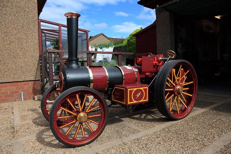

Just some in the sun

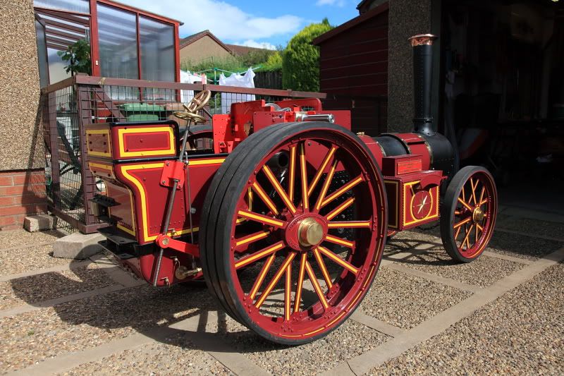

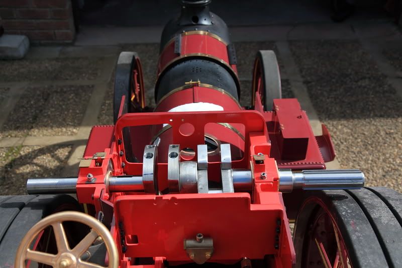

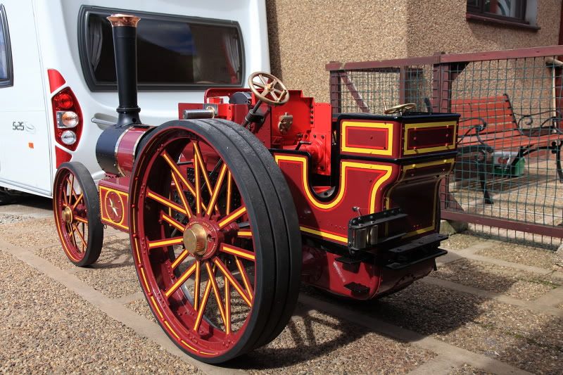

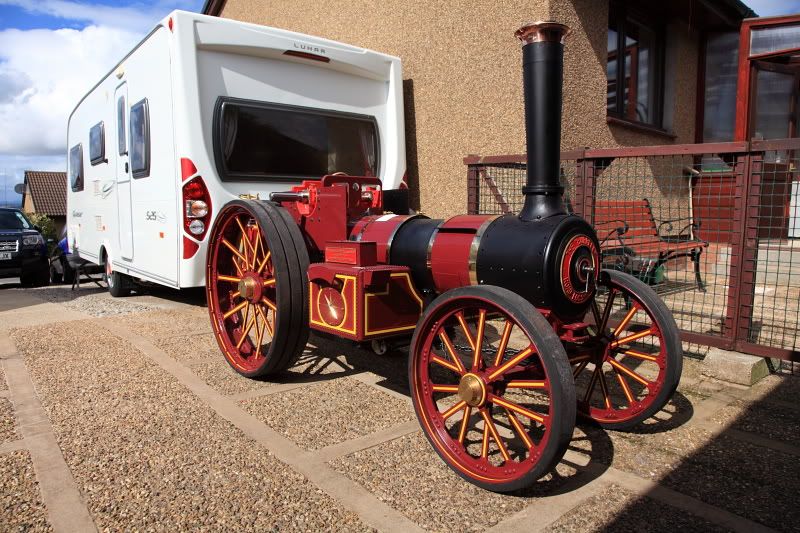

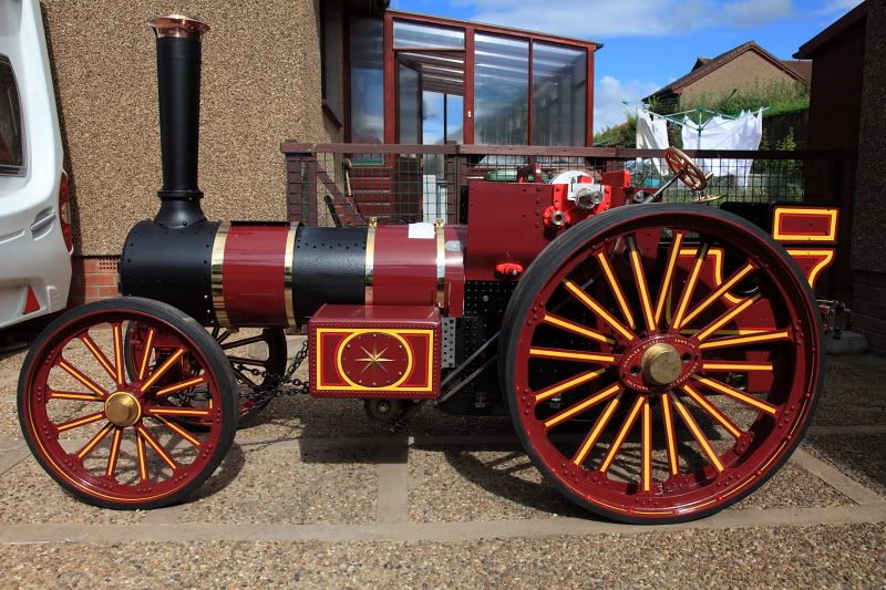

Post  lynnr on Sat 13 Aug 2011, 4:22 pm
More Pictures
Looking good!
Post  Steve Traill on Sat 13 Aug 2011, 6:56 pm
Hi Lynn
Looking very impressive out in the daylight, it's a credit to you and all the hard work you have put into it. When in steam they are going to be so impressive and I'm sure prove a good investment in time & money. cheers

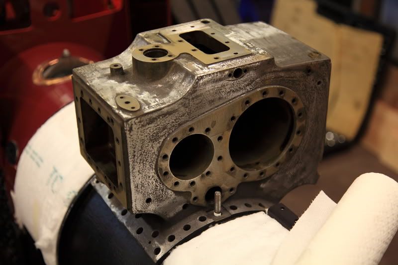

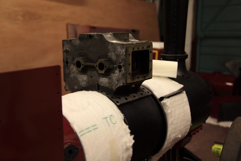

Post  lynnr on Thu 18 Aug 2011, 7:45 pm
Nice square clean un-molested package arrived at 17:45 today.
Done some cleaning up.
Other parts in storage
Found the slot in the cleading that has the belly tank bracket needs to be opened out by 2mm or the bracket fettled down a bit.

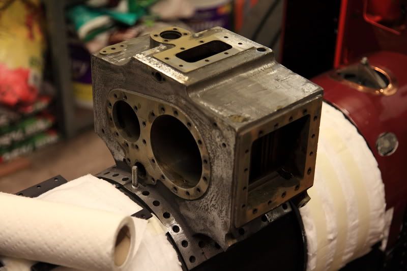

Post  lynnr on Fri 19 Aug 2011, 8:46 pm
Been doing the studs on the block. All going well. At first outer studs would not line up but once I started tightining down as per the instructions the holes started to line up. Only got 2 problem holes and need to get a replacement stud as one appeared very soft and stripped with little effort.
Will keep visiting the block over the next couple days and put a flat on each nut. Also decided not to paint the block off the engine and I am glad as the number of dings that the block got from the spanner and socket would have chipped it devil.
