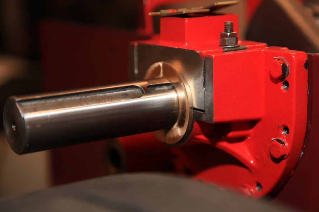

Building is going well. Had a problem with a few of the tender bolts but a bit of chasing from the back with a tap cured the issues.
Currently putting the rear wheels on. Doing the left at the moment with the cintered bushes. Need slight honing as the were a tight fit and press in. I think the inside diameter has shrunk slightly.
Question for STW. When do we get the locking collers for the rear wheels. It would be useful to get them with the rear axil to allow easy movement of the enging. The coller would stop the wheel sliding off the axil and the hub cap would stop the wheel sliding too far on.

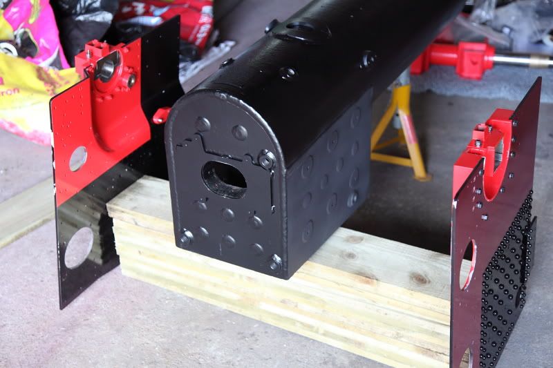

Hornplates went on well and lined up very quickly. Took 5 minutes.

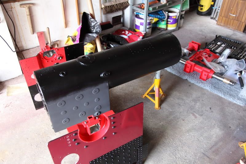

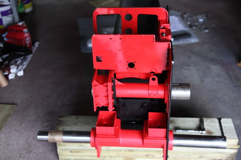

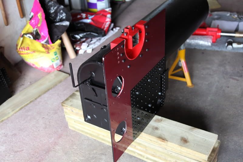

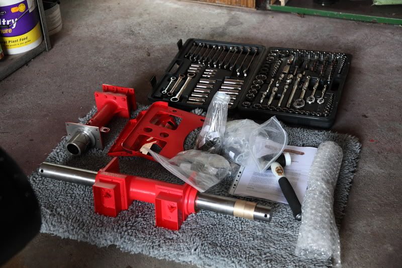

Getting ready
Fire door added
Right Hornplate
2nd Shaft casting
Rear axil casting and shaft
Rear spec plate
Front spec plate
All ready for the left hornplate
Left hornplate fitted and Alignment tool in place. And it rotates. Very Happy

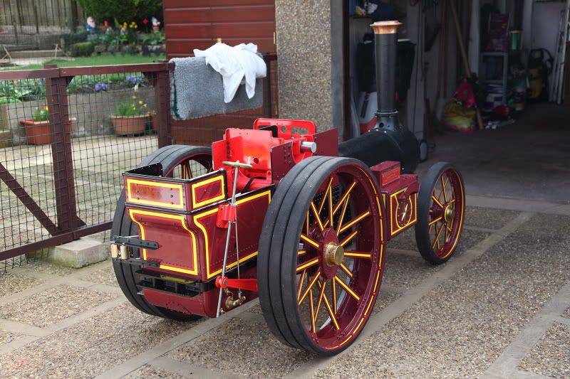

Tender moments

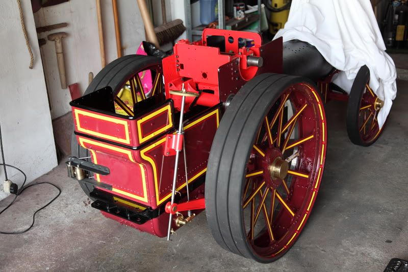

Getting ready to fit the belly tank for the time being. Need to remove for cleeding.
Just checking
Getting there!
Ta Da!!!!!!!
Only couple of points. Lover bolt at the back is too long as it fouls the tender sides if not flush with the hornplate

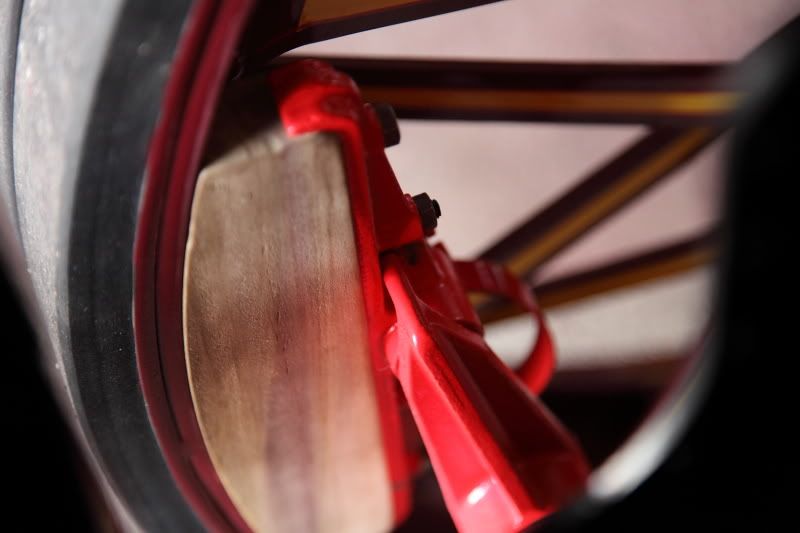

Are my brakes right?

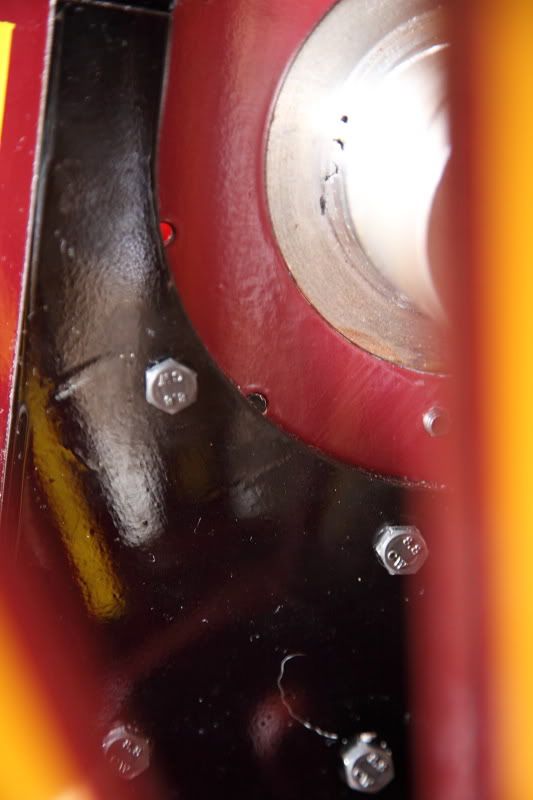

I noticed that you painted all over the back of the hornplates where the axle cannon boxes, second shaft bearing housing bolts on and the firebox bolts, any issues with being tight due to paint thickness?
What did the neighbours think of it when they saw what you have been up too?

Had no problem with fitting the hornplates. The paint on the inside of the hornplates is quite thin as it is farly enclosed and should not get dinged.
Thats also part of the reason I had the hornplates apart when fitting to the boiler. It was somewhat easier to bolt things together as parts were much lighter and were put together at right angles where as if it was installed as a single unit. You are fighting the weight and trying to slide parts together. Only real heavy part was the axil as it was very tight in its bushes so did not want to try and wiggle it out again. Then run the risk of damage when puting it back in.

Then to allow the bracket for the flywheel brake to fit I cut a section out of the cleading. If you mark the centres and outer width of the plate on the inside and cut out. You have enough space and it does not distort the cleading. Also I cut 5 threads of the 2 bolts as they were very close to the boiler barrel.

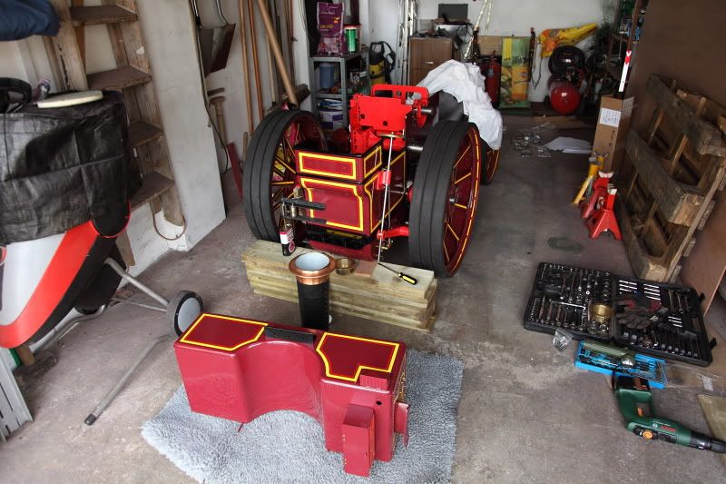

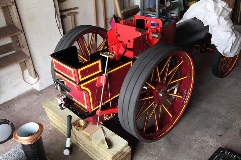

Steering
Post  lynnr on Mon 18 Jul 2011, 7:28 pm
Pictures of steering arrangement and clearance.

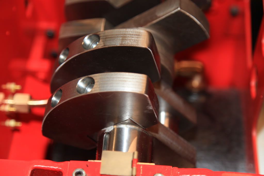

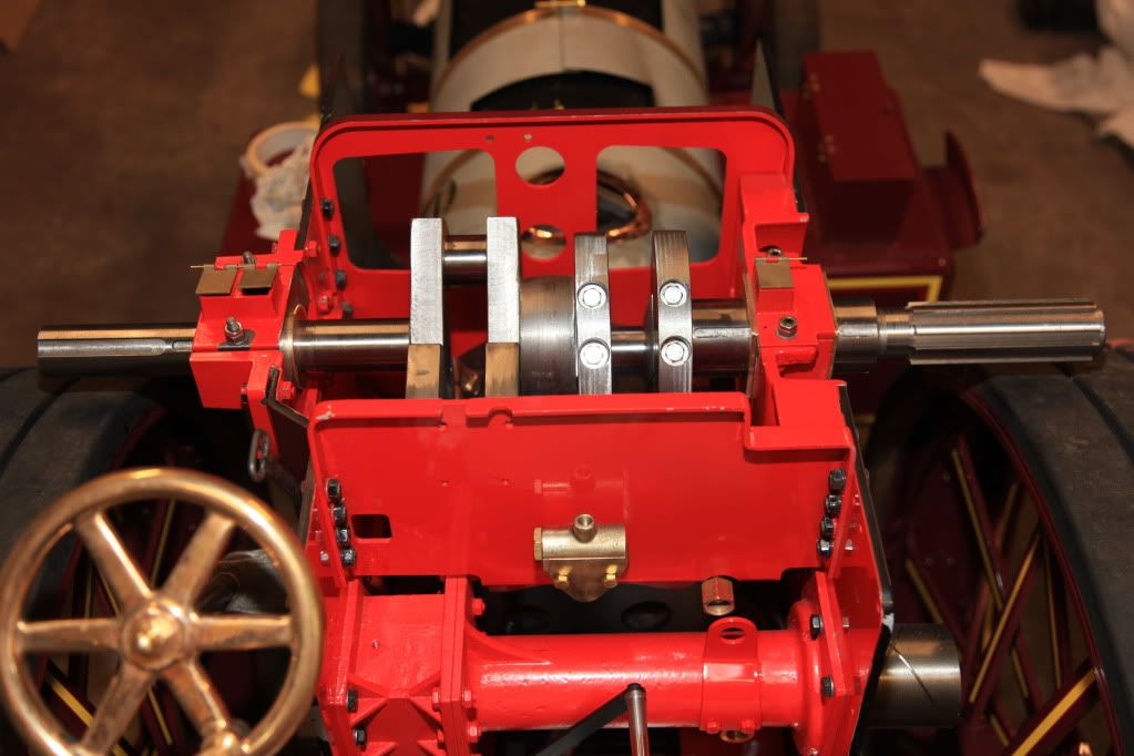

I must admit you are correct. Got the crank attached last night. Will not require too much fettling as I can actually turn it by hand with just putting everything in place. I will do photos tonight. I did have to remove the paint from the bearing housing faces to allow the bronze bushes to slide in to place.
As the left hand bush is round. Should I put locking compound behind them to keep the orientation and the oil holes lined up?

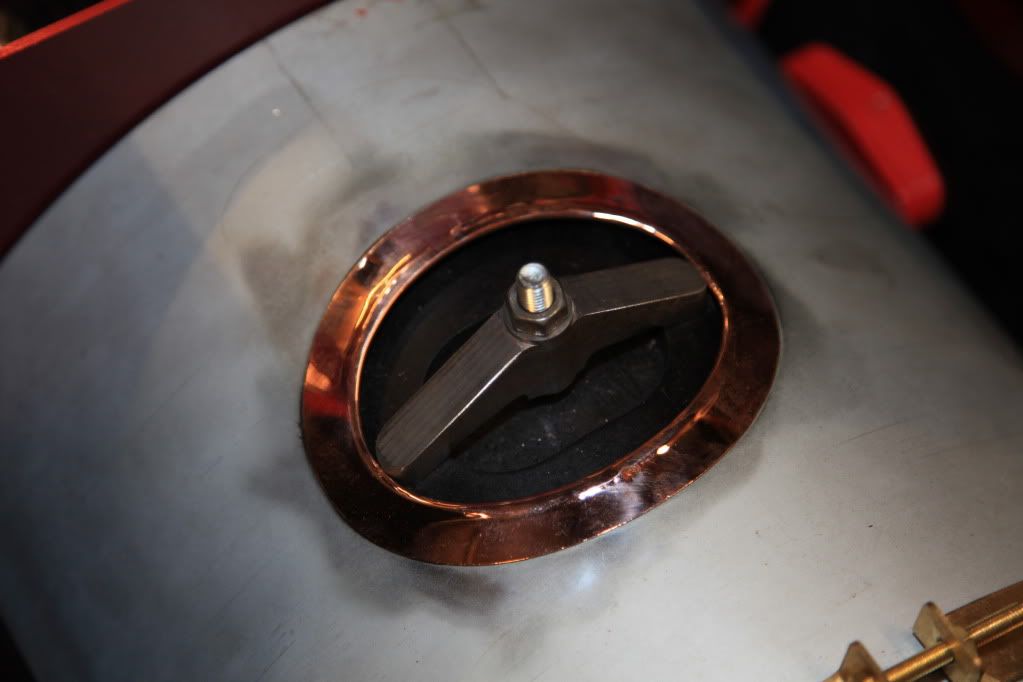

Post  lynnr on Fri 22 Jul 2011, 8:00 pm
Got home from work early today. Got the steering chains blackened. Before I done the blacking I welded the eyes on the adjusters so that they can not pull out over time. Done the copper ring round the inspection plug.
