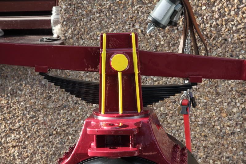

Items ready for Topcoat
Smokebox door with the name plated ready for polishing
Front Axil top coated
Perch & pivot top coated
Smokebox almost finished. Just pinstriping on the perch & pivot to do

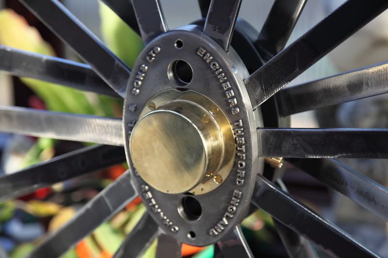

Post  highpressure on Mon 06 Sep 2010, 6:16 pm
Looking very good, what paint did you use for the name rings? I have yet to do mine and not sure what to go for.
Cheers Kev.
Paint used
Post  lynnr on Mon 06 Sep 2010, 6:23 pm

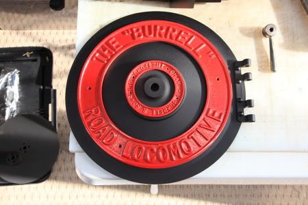

highpressure wrote:Hi Lynn,
Cheers Kev.
Hi Kev
The red paint I used for the name rings is Plasti-Kote Projekt Paint 2in1 Metal Protekt on top of light gray/white etch primer. Hope it will give good service.
Number of posts : 2919
Post  highpressure on Mon 06 Sep 2010, 8:09 pm
Got some of that. I presume you then sanded back the letters etc for the finished effect and then polished it? The outer plate I have has letters level or so with the outer rim but in the smaller one the letters are much lower so making it difficult to run a sander or something over them. Was yours the same? From the pictures it looks like the letters are a bit more proud or maybe thats just how it looks once there is a colour difference. A good close up would show it.
moldings
Post  lynnr on Mon 06 Sep 2010, 8:52 pm
On the bigger ring the letters are flush with the rims so made it easy to polish off the paint using a fine file. Then I polished the ring up with sheet of wet and dry and a cork block.
The small ring is not so well moulded, somewhat pitted. Yes the letters are much lower but using a sanding disk in the dremel type tool. Working the disk almost on edge I got a reasonably polished finish to the letters. It took about 2 hours to do.

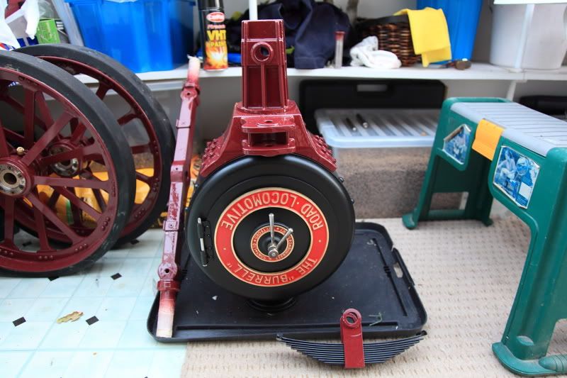

Post  lynnr on Sun 12 Sep 2010, 3:49 pm
Vapor wrote:Hi Lynnr,
Can I ask what paint you used on the smoke box.
Plasti-kote Woodstove satin black. says good to 400degC. This is on top of Carplan Firecote VHT matt black baked in the oven at 200 for 60 mins.
I originally thought the VHT would go sort of satin as this was the finish at first. Then once it dried it went very matt black so I resprayed with the plasti-kote.

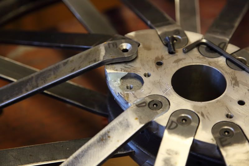

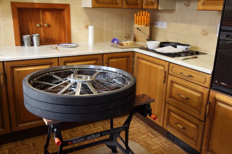

Kit 4 Rear wheel
Post  lynnr on Mon 27 Sep 2010, 9:03 pm

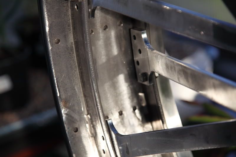

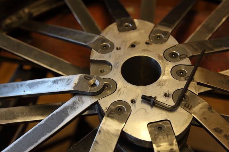

Got the rear wheel last friday. Cleaned and dry fitted yesterday.
Enjoy

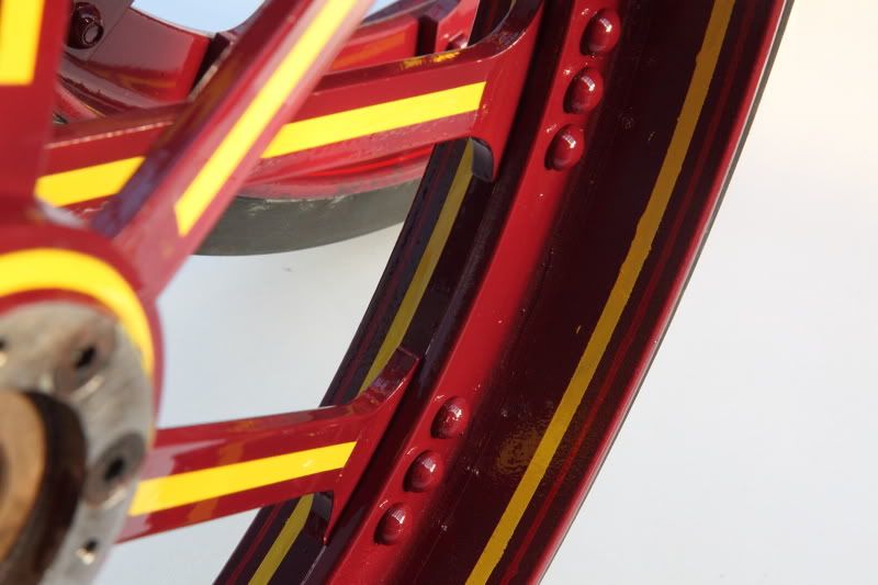

Post  lynnr on Mon 11 Oct 2010, 12:27 pm
Good progress had over the last few evening and today. Got painting today. Used a touch more harderner in the paint. Now able to handle the parts after 4 hours at 20DecC. Should be able to do pinstriping tomorrow.
Perch and Pivot repainted due to a problem. (Inclusion just under the surface of the pivot shaft locked everything up. Had to go at it with an assortment of tools and hammers).
Front Wheel rim showing first pin striping

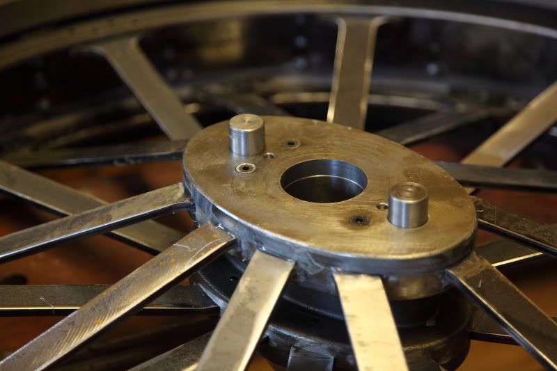

Post  lynnr on Fri 29 Oct 2010, 9:44 am
Got my next wheel. Hope to get cleaning and dry fit over the weekend. Not got anything else competing for my time at the moment.
Been cracking on
Post  lynnr on Sun 31 Oct 2010, 4:13 pm
Well. Mid afternoon on Sunday and the wheel is all cleaned and bolted together for the dry fit test.

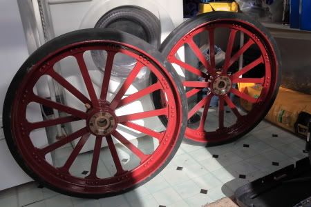

7th Nov update
Post  lynnr on Sun 07 Nov 2010, 3:45 pm

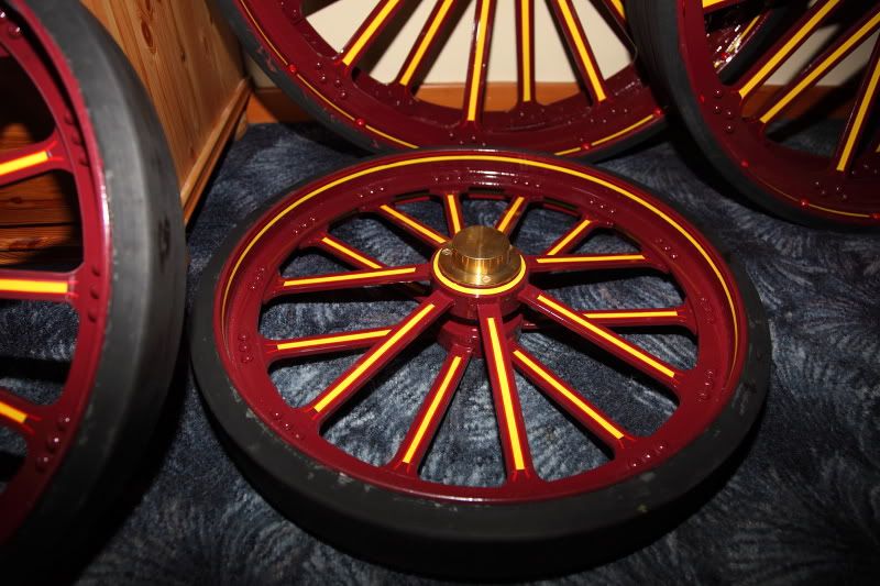

Well another day of good progress. Managed to get the right rear wheel fully assembled and into undercoat.
Finished and time to make lunch
Both wheels in "storage". The one at the back is top coated ready for pinstriping the one at the front is just in undercoat.

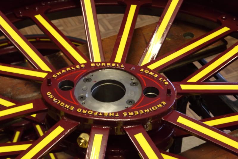

Just done some casting letter painting on the left rear wheel. Forgot to do the "&" but done the rest.

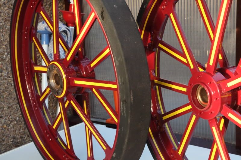

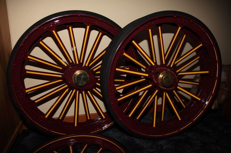

21/11/2010 Progress. Pinstripping!

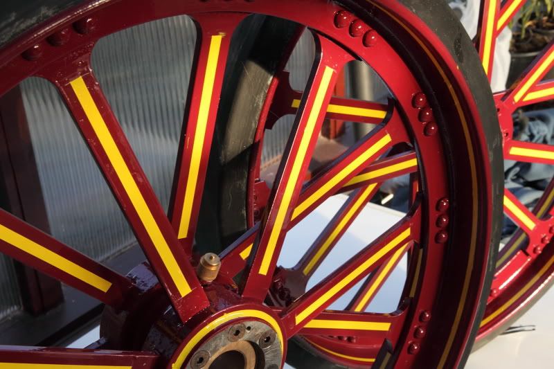

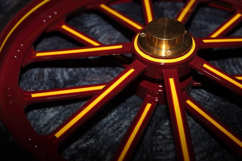

Post  lynnr on Sun 21 Nov 2010, 3:20 pm

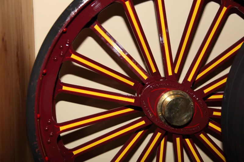

Here is the latest update. Been busy over the last couple days cracking on with the pinstripping. I am using a mix of masking tape and beugler pen. To what I think good effect. May consider redoing the yellow line on the rear wheels rim to make it a bit more consistent may just paint some wheel colour to straighten the yellow out and clean up the ends of some of the lines.
So here is the pictues
Rear wheels
Front wheels

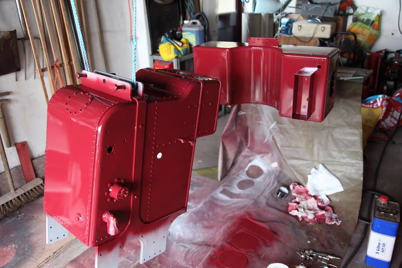

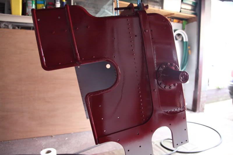

Post  lynnr on Thu 02 Dec 2010, 7:39 pm
Well good progress done over the last few days, does help when you are on holiday.

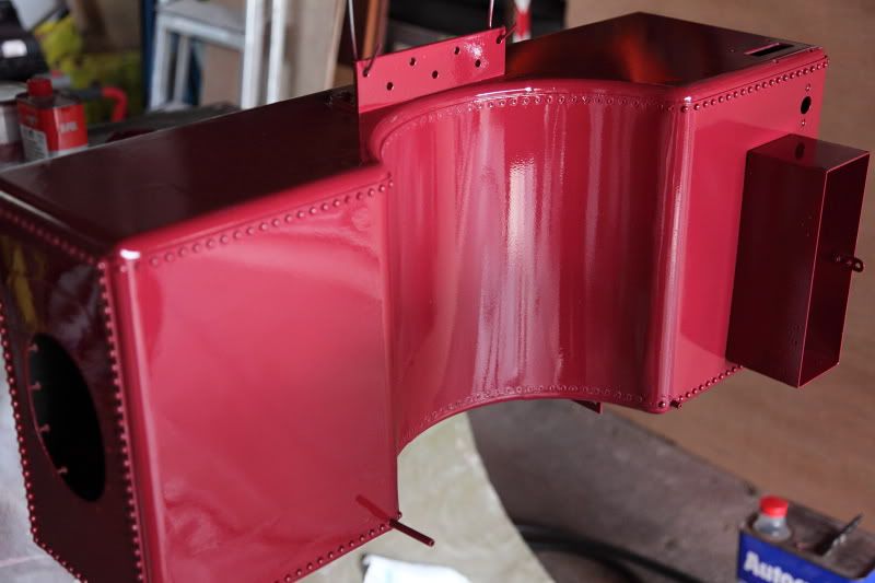

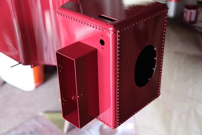

Got the tender and belly tank built up. Painted the tanks in Isoflex today so stinking the house out Twisted Evil
Hope to finish/refine the edge grinding tomorrow then I should be able to fit the side panels on the belly tank and finish the isoflex. I have not put one panel on the tender to allow easy access for painting.
Will try and get a few pictures tomorrow.

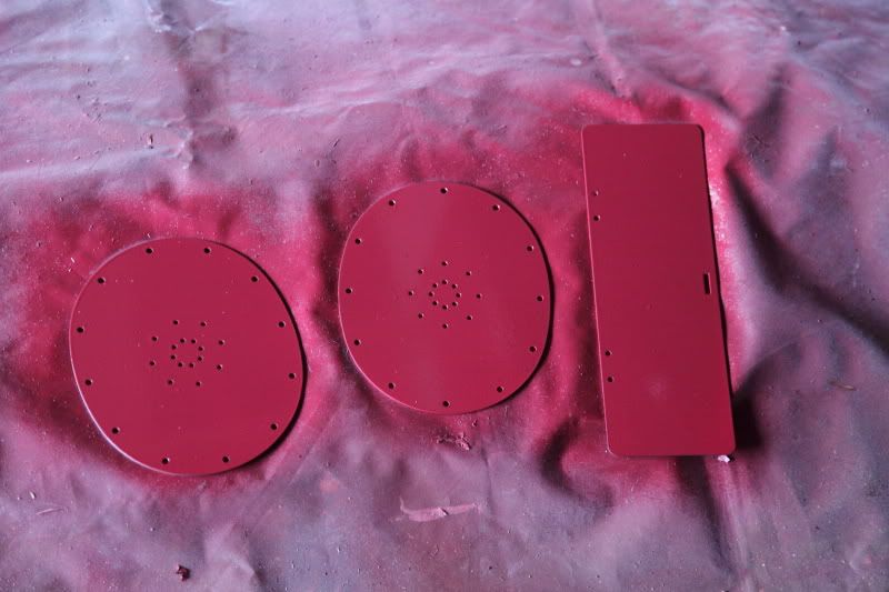

Yipeeeeeeeeee.
Tender and belly tank now in first top coat. Looking quite good. Couple of sags due to the low temperature but will buff out before second and final coat.

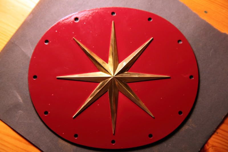

Though I would share how the stars are coming on. Spent lunchtime polishing the stars on 500grit wet and dry. Then "dremeled" with green polishing compound on a cloth mop.
