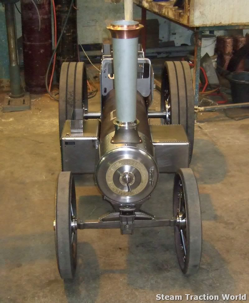

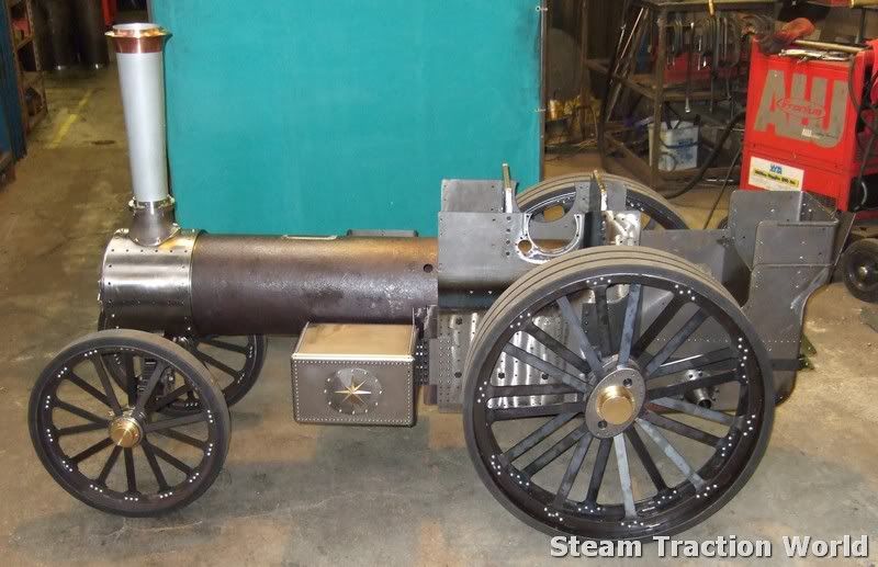

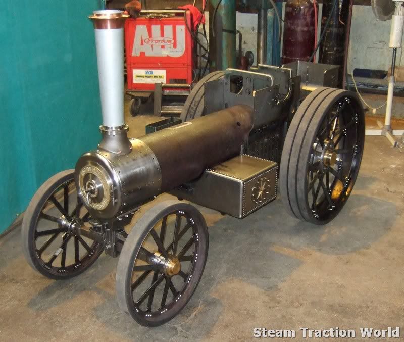

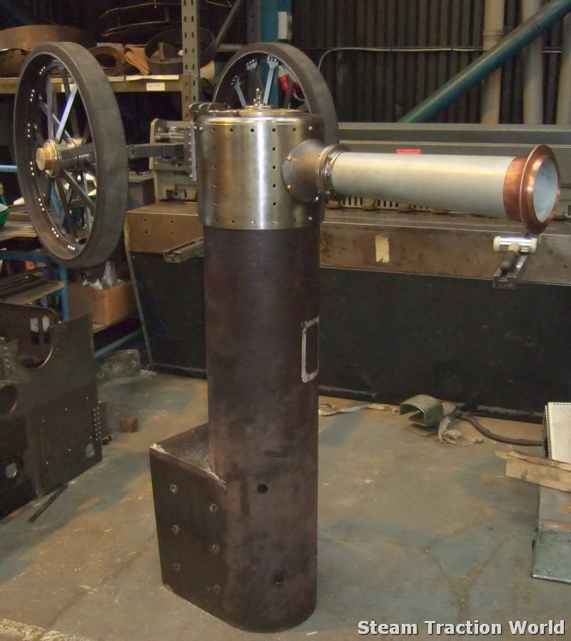

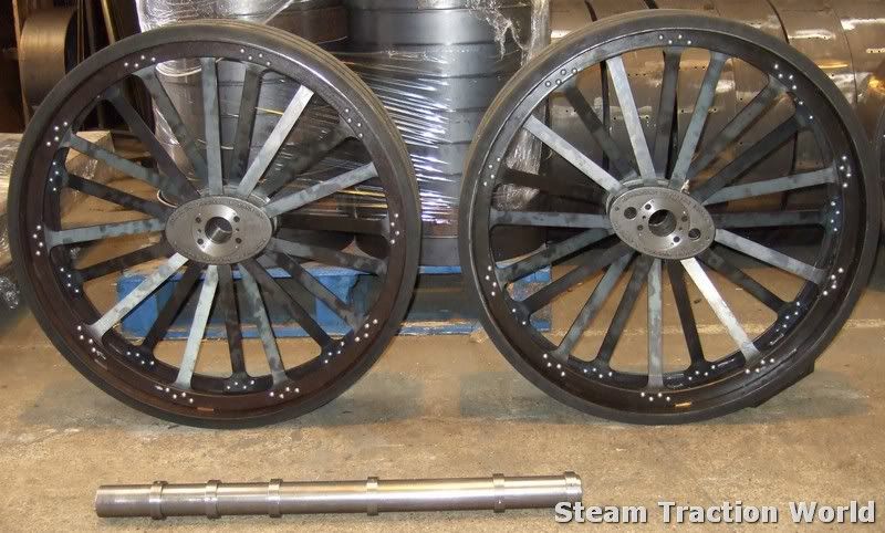

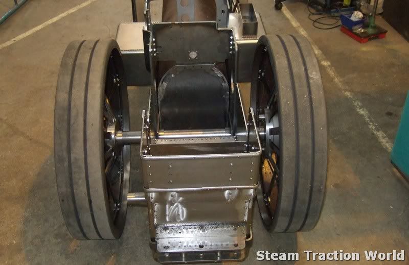

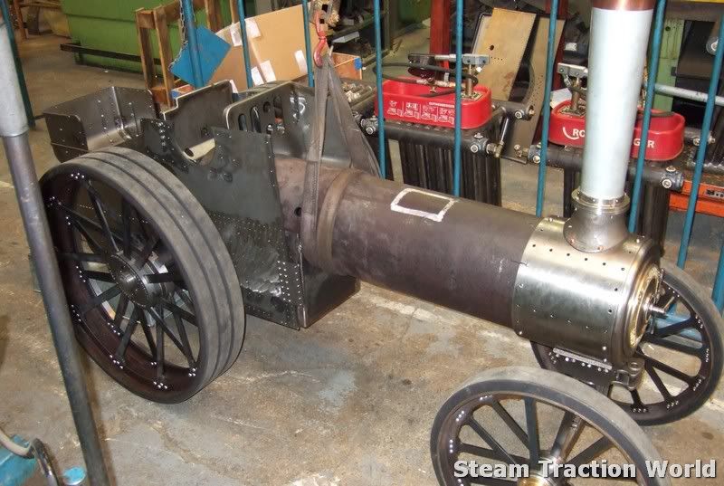

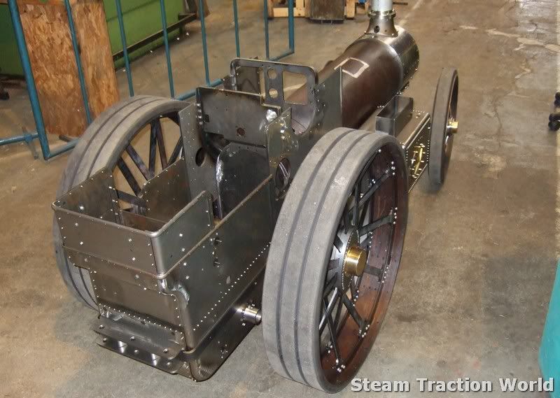

with the Dorset show out the way its now safe to post the photos of the rolling chassis on the forum Cool
we are using a dummy hollow boiler and a rather basic rear Axel but everything is set to the correct dimensions.

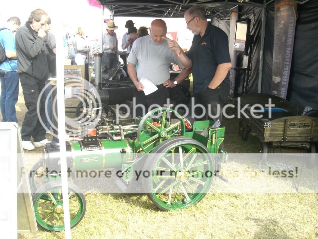

Here is a picture of the STW stand when at about 6.30pm a gap appeared (for a millisecond!) in the crowd for me to take this picture. The stand was busy all day every day. The Showmans/Road Loco mock up was very impressive & received nothing but praise from everyone. Having looked at it for 5 days and from every angle I don't think there is any way of improving it, everything is spot on. Anyone interested in one should decide soon as with the ones we sold at Dorset there's only a few left of this extended run and when 'they're gone they're gone' as they say. Also the 'J' type Foden in SWB Artic form is going to be a 'hot' engine on the rally field as there is nothing like it out there & will be a real head turner.
ps Can anyone spot the deliberate mistake on the stand?!!

The stand looked fine to me although I'd had quite a bit to drink by the time i made it over to the stand.. drunken
Is the left hand tent the wrong way around?
I was impressed to see how busy the stand was from first thing all the way through the afternoon.
i even caught the tail end of a conversation over by the showmans line later on in the evening talking about the DCC and how impressive it will look when finished so i'm happy i've made the right decision to build an STW model.
Here is another view of the stand.
img][/img]
Just one word of advice if you are thinking of going to Dorset next year.. Cover your car?
The dust is unbelievable and due to all the heavy haulage movement in the play pen it is kicked up is great clouds.
I had to literally scrape my way down to glass on the windscreen and there wasn't one part of the car that didn't have a chalky white film on it.. Other than that seeing the rolling chassis in the flesh and surmising over the possibility of a double seat arrangement on the back well and truly made up for it.
Many Thanks for the IPA.. Smile

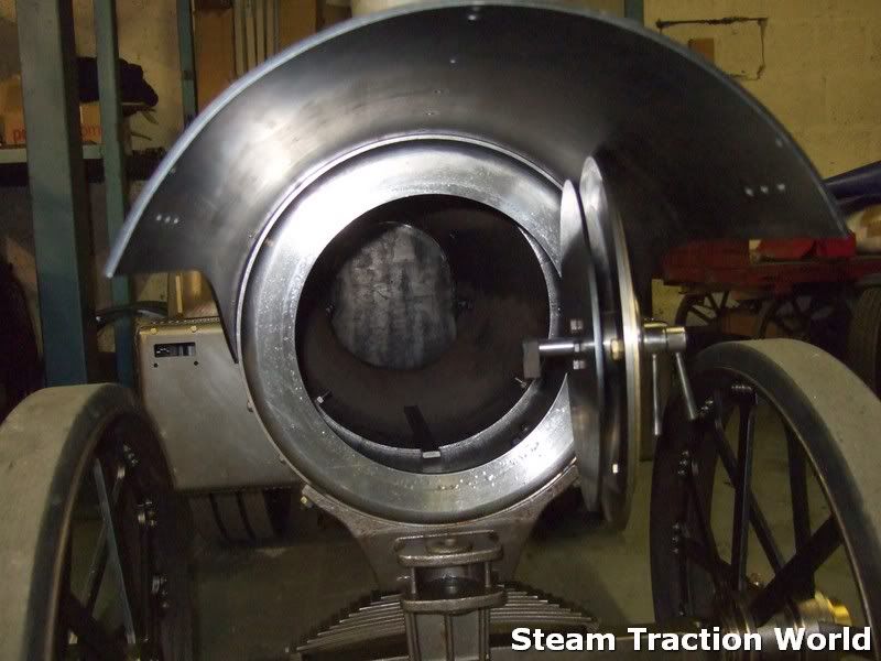

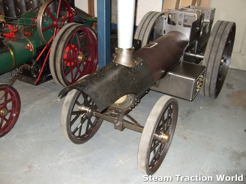

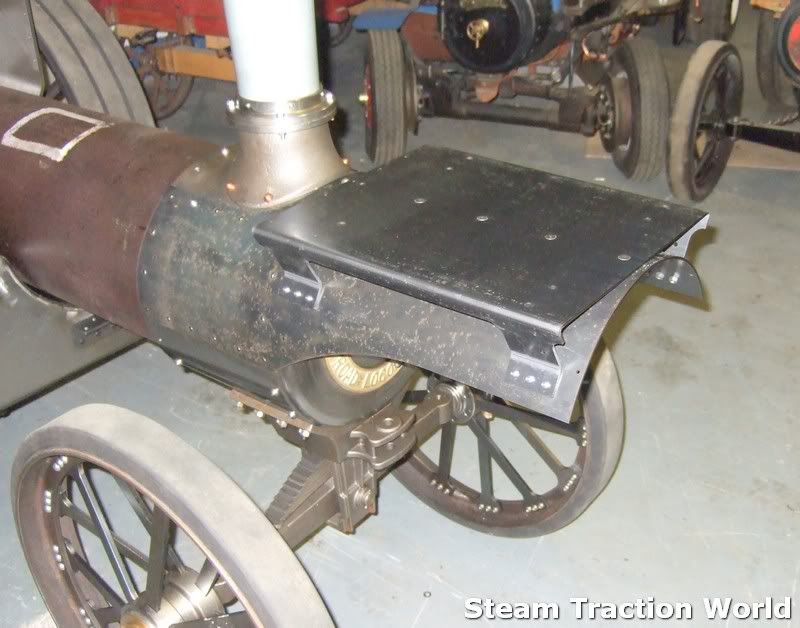

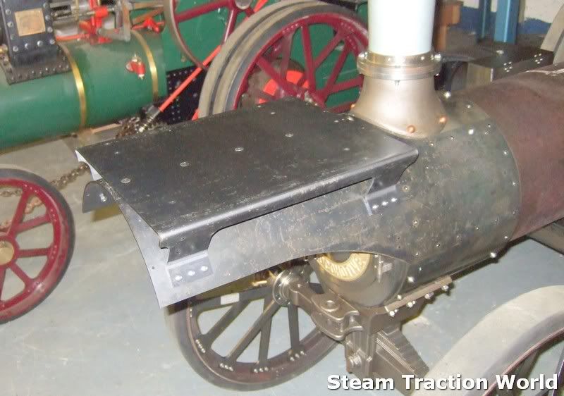

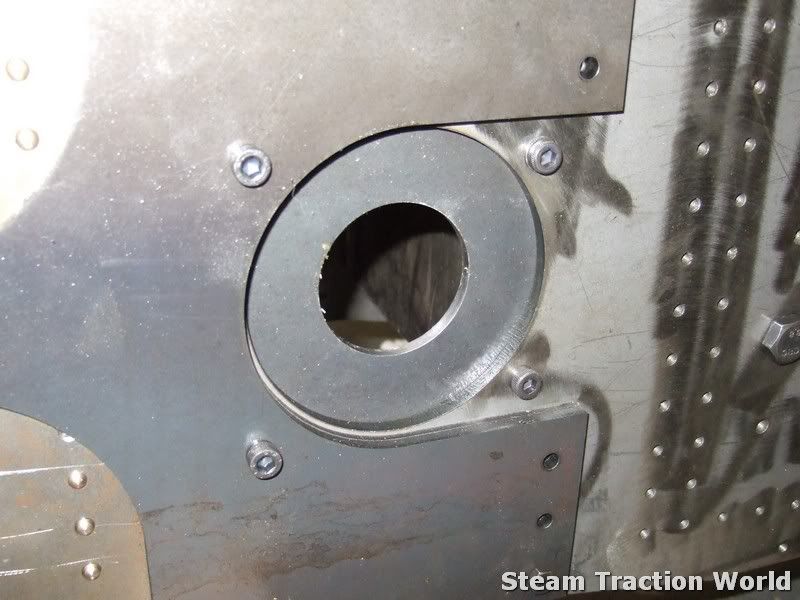

the prototype laser cuts for the dynamo mounting arrived this week and have been rolled and fitted to the chassis...
all that work on the smoke-box and now you can hardly see it Rolling Eyes Rolling Eyes Very Happy
Number of posts : 1256
Hiding
Post  lynnr on Fri 10 Sep 2010, 9:14 am
Looking good on the extension for the dynamo. I take it that the smokebox door does not get impeded by the extension?
Number of posts : 2915
Re: Showmans / Road loco rolling chassis
Post  craig@STW on Fri 10 Sep 2010, 11:49 am
the door comes into contact with the mounting just before it reaches 90 degrees of "open-ness". still plenty of room to get in there but you cant open the door "fully and out of the way" any more.
I'll take a photo before the end of the day Cool
Post  craig@STW on Fri 10 Sep 2010, 12:00 pm
may actually give a prize out to anyone who can understand that last comment. i cant figure it out and i wrote it Rolling Eyes

craig@STW wrote:may actually give a prize out to anyone who can understand that last comment. i cant figure it out and i wrote it Rolling Eyes
Yes it makes perfect sence

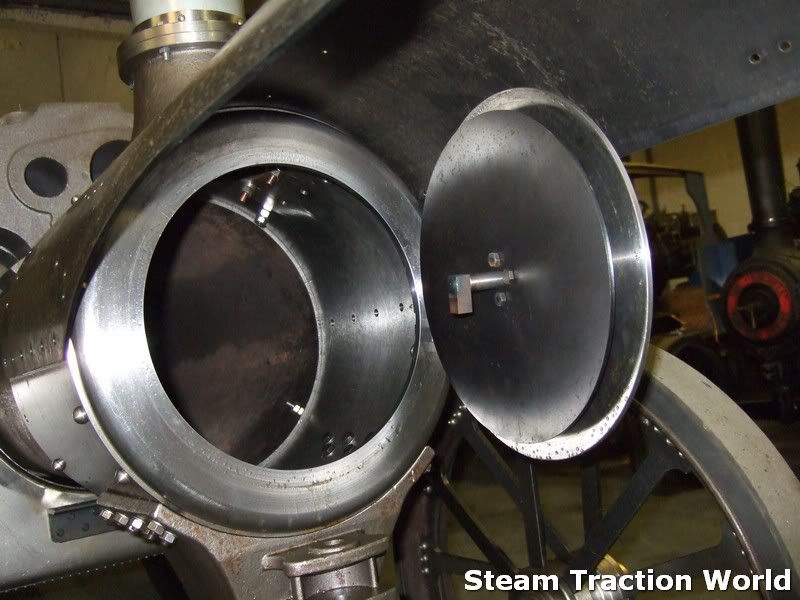

Post  Tony King on Fri 10 Sep 2010, 1:43 pm
You may be able to open the door, but I don't think it'll will be possible to remove the door hinge pin unless it's modified or put in from the bottom & held in place somehow. ( with split pin at the top, perhaps?)
Just a thought for those who will want to remove the door without taking the whole engine to pieces after it's built!!
Post  craig@STW on Fri 10 Sep 2010, 3:00 pm
here's the photos of the door open...
and no, you can't remove the hinge pin.

Post  forge on Fri 10 Sep 2010, 6:57 pm
would an extra hole in the dynamo mounting plate be useful for removing the door hinge pin?

Post  lynnr on Fri 10 Sep 2010, 8:09 pm
Hummm. Think I may just put the hinge pin up side down and secure with a R clip.

Post  craig@STW on Sat 11 Sep 2010, 8:08 am
well there's a lot to go on top of the mounting so im not sure there would be clearance to pass the pin up into a hole, but good idea, worth looking at Cool
another alternative would be to have the top hinge block threaded and end of the pin threaded so you can "screw" the pin in place, but then we are moving away from type Neutral

Post  greystones on Sat 11 Sep 2010, 10:06 am
Looks to me as though you can get a tube brush in OK so why would you need to remove the door apart from repainting the name rings when the paint tarnishes.

Post  Tony King on Sat 11 Sep 2010, 11:28 am
On my engine the hinge is polished metal so will need to be removable to keep that proper showmans "wow factor". I have actually made a small collar & drilled through hinge pin & collar & fitted a taper pin. There is a fabulous showmans engine "Dolphin" near here which I'm sort of copying. The same man also owns the "president" which I took the pictures of, which you see from STW.

Post  Steve Traill on Sat 11 Sep 2010, 9:40 pm
I noticed up at Dorset this year at least one Burrell Showmans had the smokebox door hinged from the bottom so it drops down. Whether this was done by Burrells or later on I couldn't say but it would alliviate the hinge pin problem. The hole in the dynamo bracket might not work anyway depending on where the dynamo sits. Other options are two small hinge pins, stick it in upside down with an R clip, unbolt the door from the hinge, unbolt the hinge from the smokebox or crack open another tinny and leave it as it is! pirat

Post  lynnr on Mon 13 Sep 2010, 12:46 pm
Just been looking through the pictures of ex-mayor Here and I think the smokebox door pin is in the upside down position!

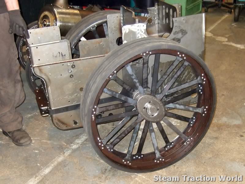

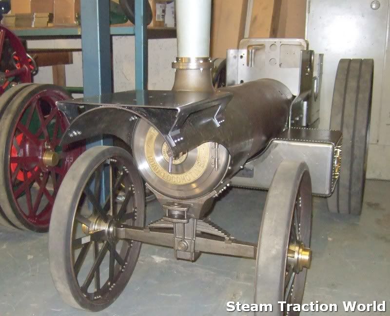

Post  craig@STW on Thu 16 Sep 2010, 8:07 am
yes Lynn, looks like your right Cool

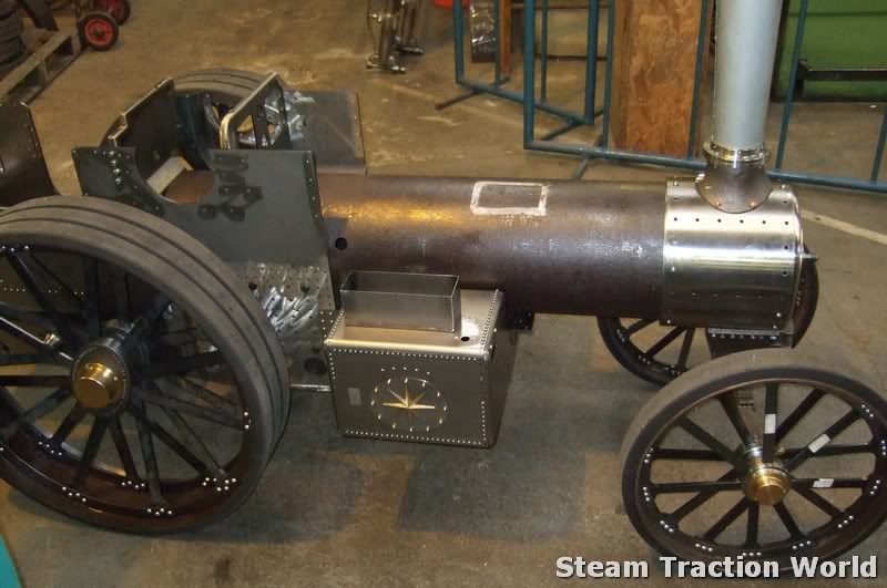

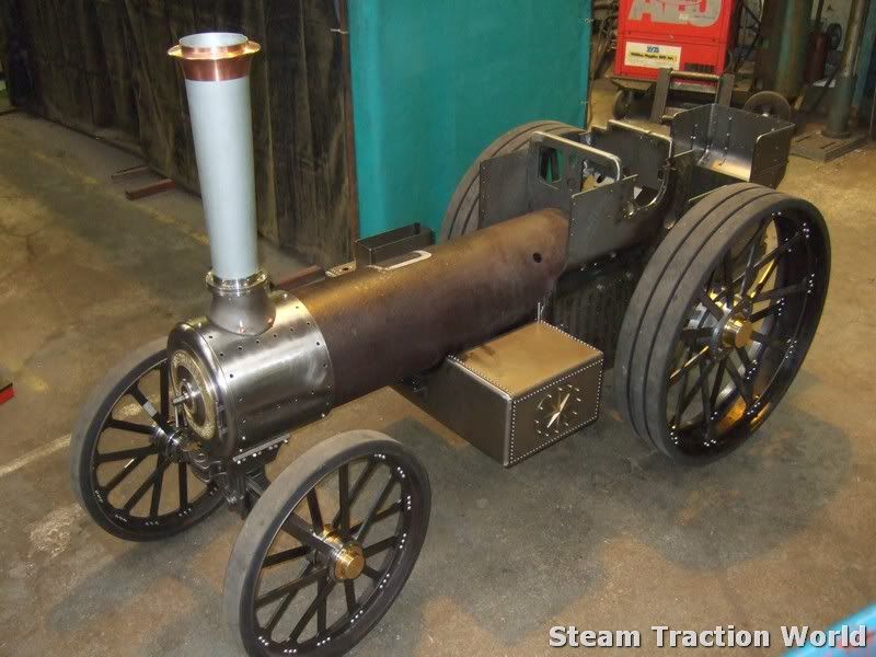

OK, the next section of the prototype dynamo mount is now bent and fitted, ready for the show at the weekend. here's the photos...
