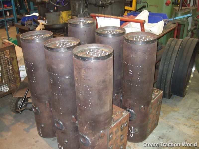

Post  craig@STW on Mon 14 Feb 2011, 9:27 pm
the boilers linked in series for testing...
and after testing, being drained of the water...

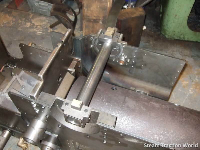

just wanted to say... as some of you are getting close to putting your rolling chassis together its time for a warning.
as you know, just about all the parts you have already are very heavy. and the boilers are really heavy. please be careful when putting all this together at STW we have a large engine hoist to do all the lifting and we have at least two people working to get all the sections together.
the front Axel/smoke box/ front wheel section is able to twist in any number of directions and needs to be handled with care.
if you dont have an engine hoist i would recommend at least three strong helpers when putting it all together.
im not sure what the official STW instructions will say but this is just a personal warning from me. take care Cool

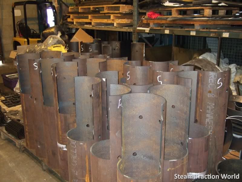

Post  craig@STW on Tue 15 Feb 2011, 8:04 am
if you look close they are marked up S and RL in white paint.

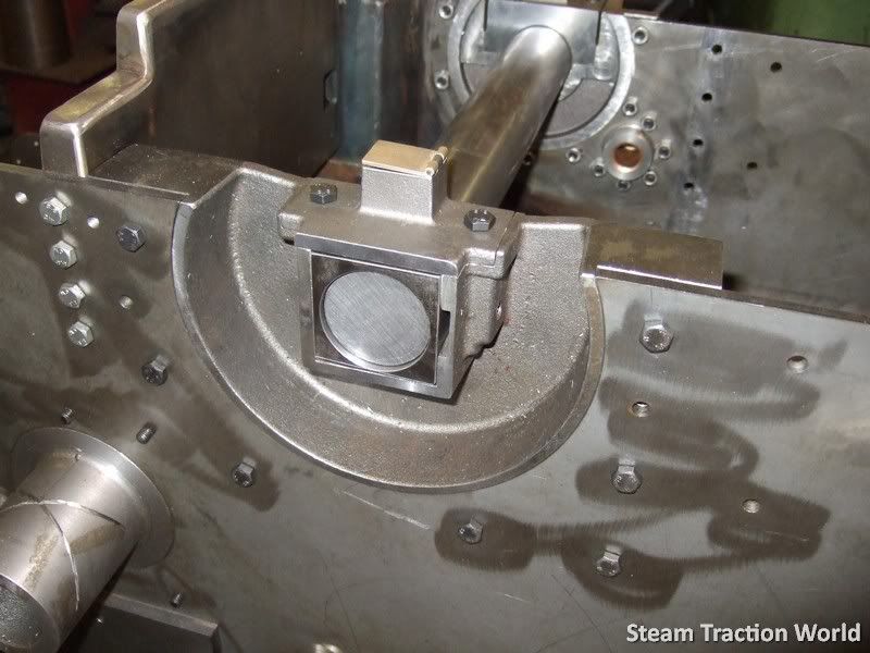

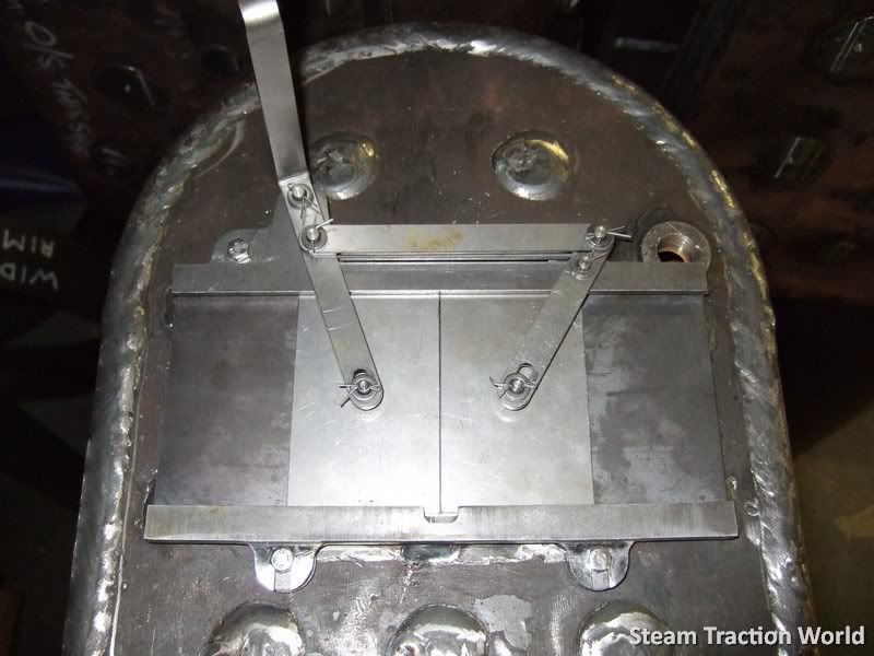

been working on the boiler accessory kit this week.
got all the horn-plate alignment tools done...
and now working on the fire-doors...

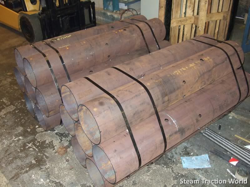

the next batch of boilers is nearly done...
Number of posts : 1336

Post  craig@STW on Tue 15 Mar 2011, 9:29 pm
and the barrels for the next batch of boilers arrived this week !!!!
