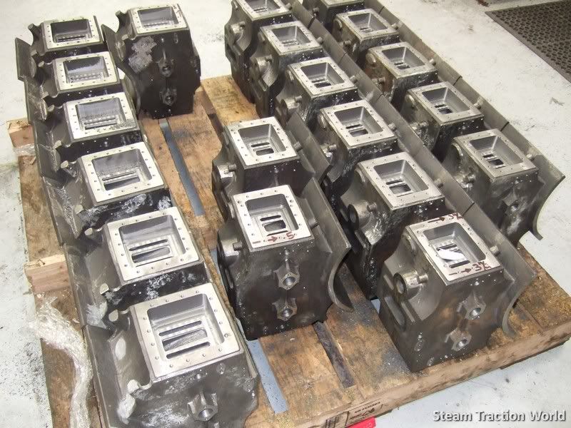

Post  craig@STW on Thu 14 Apr 2011, 9:22 pm
good news...
we had 8 more castings arrive and mark has actually started machining the first batch cheers
the first op was a minor prepping op and the second involves the machining of the main bores and saddle...
hopefully this op will be done before the machine needs moving.

just a quick one...
the cylinder blocks are back in production, now on op 5...
full production up-dates all round as things get sorted towards the end of the week

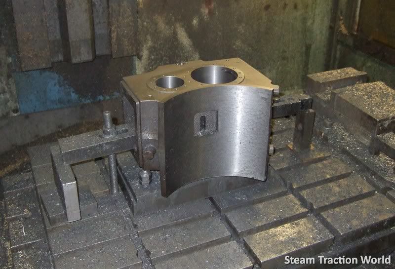

Re: showmans cylinder block !!!
Post  craig@STW on Tue 17 May 2011, 5:55 pm
to answer that... yes. trust me, we don't always get things right Rolling Eyes
so far on these, the only problems have been with the actual castings themselves (thin bits etc). we do have one that we use as the "set up" block to help us avoid these. run the program, adjust etc. i think we can say this one may be scrap by the end of the run.

Post  craig@STW on Sat 21 May 2011, 10:41 am
spent yesterday trying to get the cylinder block on the 4th axis so we can drill all the mounting holes in one hit. the main concern was whether the machine could cope with the weight of the block and repeat the hole pattern accurately.
this will save us a huge amount of time on machining.
seems to be working so far...

Post  craig@STW on Sat 21 May 2011, 8:40 pm
yeah i can do more clips, but it all takes time out of the day when i could be doing other things. i'll try and get more done.
i will post the pics separately and i have proper production updates to post before the end of the weekend Cool
we will be using this process for all the blocks, but not just yet. as you can probably make out this block has "set up only" on it and is the scrap "setting" block that has a casting fault.
the main reason i did this now was to check that we could mount the blocks solidly, the 4th Axis could cope with the weight, and the holes would be accurate. otherwise we are going to have to set up each "hole angle" separately, and thats going to take some time.

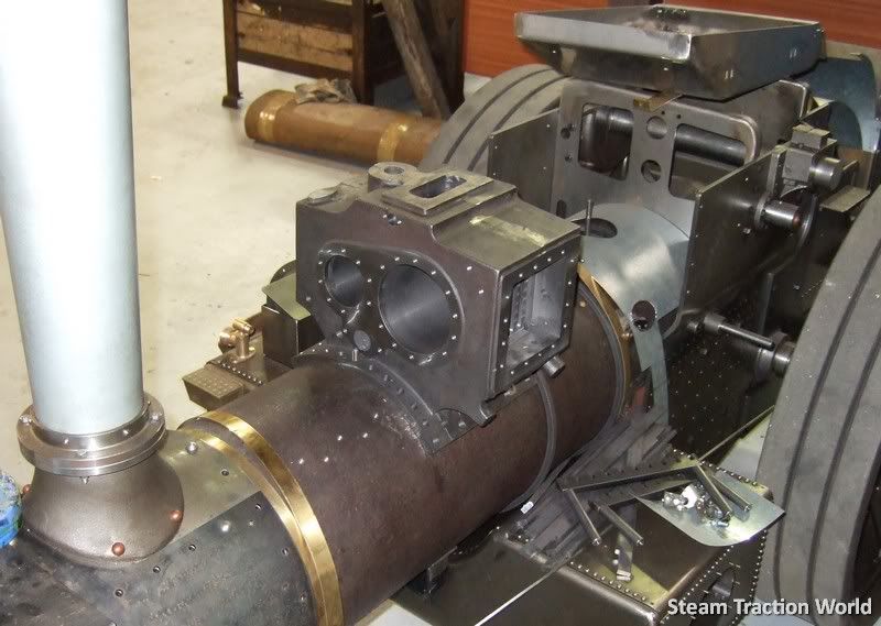

Post  craig@STW on Sun 22 May 2011, 6:53 pm
photos as promised...
the block is only sitting on one stud at the moment as we have to unpack the gaskets before we can bolt it down fully. its looking good though.
