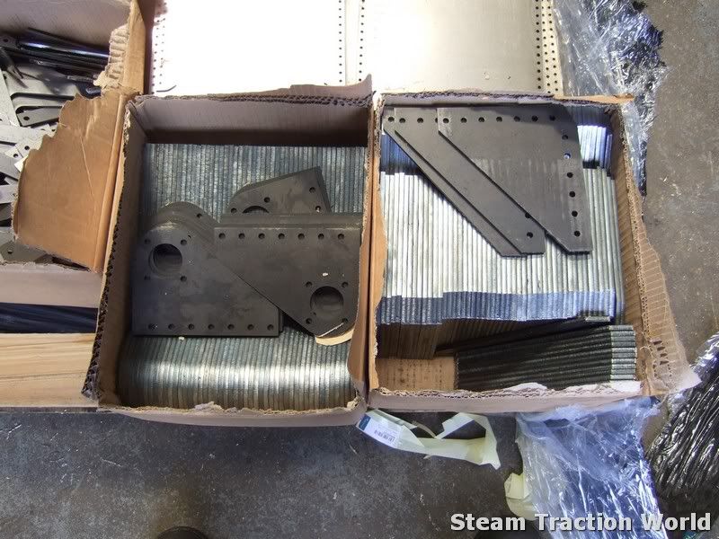

starting work in this kit now. most of this kit is laser cut sheet but we need to mill a few brackets and those bloody star things Rolling Eyes
here's most of the brackets done...

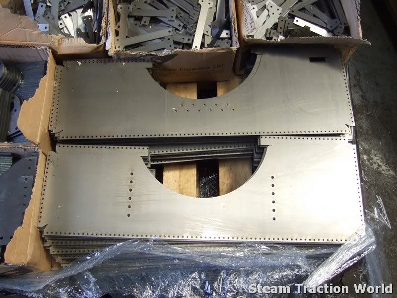

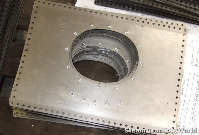

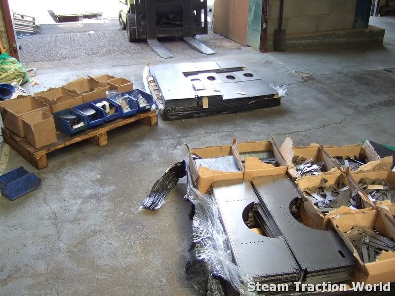

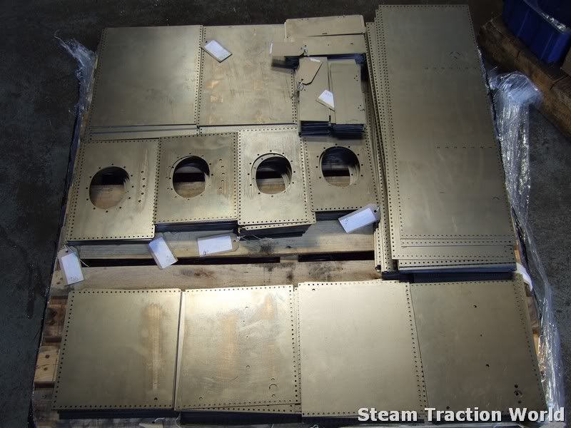

had all the laser cut parts for the belly tank arrive on Friday so we can start getting our teeth into this kit properly now...

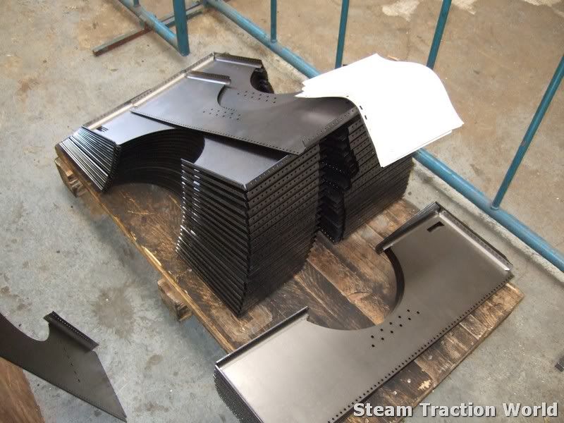

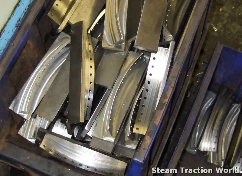

tank fillets...
what ??? all will be explained at a later date Cool

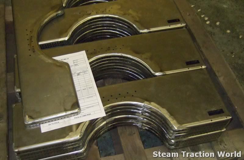

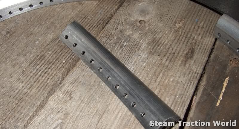

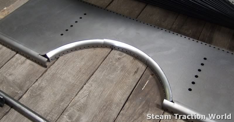

Post  craig@STW on Thu 15 Jul 2010, 8:02 am
well if you look back at the photos of the laser cuts you will see the tank "front and back" plates with a big semi-circle cut in them.
these fillets create that lip which is bent and curved so would be hard to form any other way. they also provide the lip for the rivets/bolts.
we had similar things on the tender but these were turned. the radius on these is so large that it would be like turning a spaghetti hoop, it would just get crushed by the chuck, so we have had to mill them in sections.
they are not finished yet but i should get the other side done soon

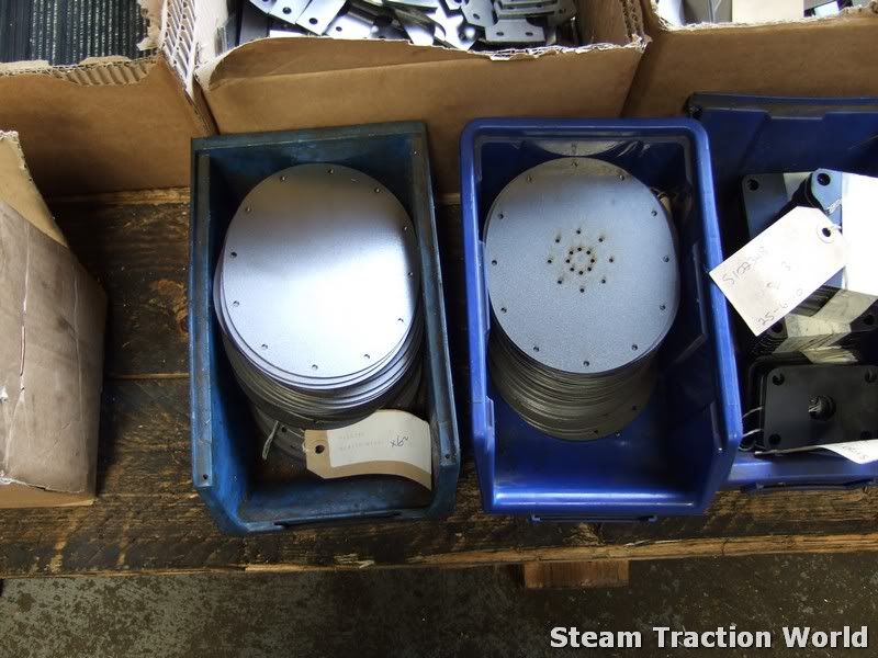

Post  craig@STW on Sat 17 Jul 2010, 8:56 am

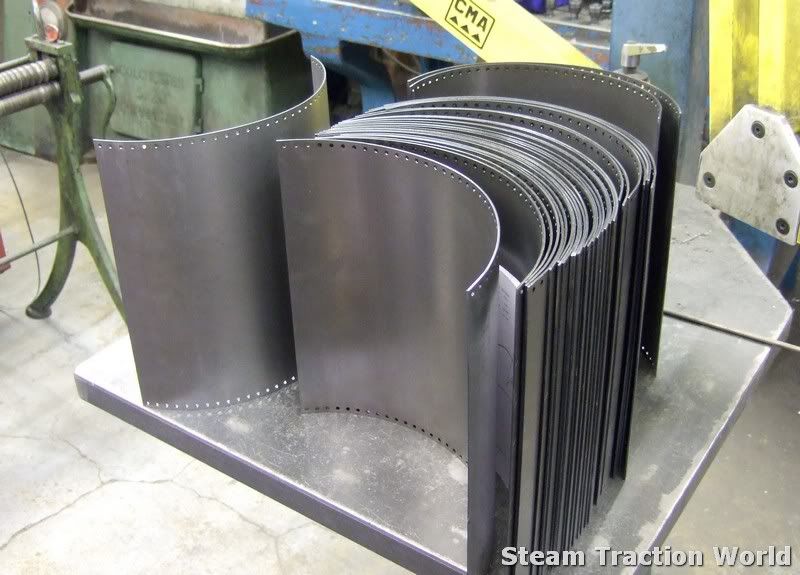

got the other side of the fillets on the machine now, as you can see, this side has a radius...
and this is where they go. they form the centre curve on the front and rear sections of the tank. the part that goes around the boiler...

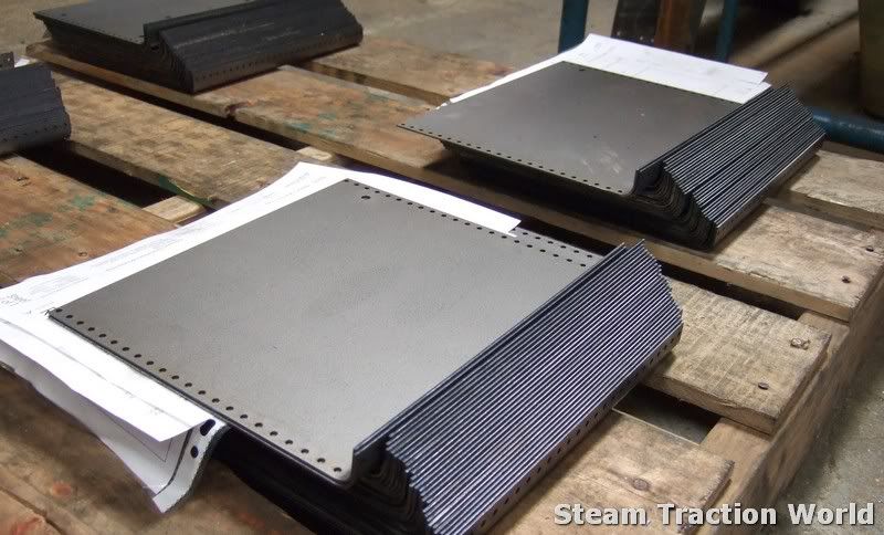

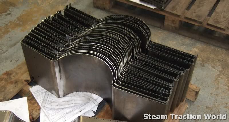

and this is the section of the tank top that goes in the curve...
and the end sections for the tank top...
the tank bottom...
and the tank front and back...
the good new is, so far this seems to be going together very well with no "design issues" in the sheet work at all. fingers crossed Rolling Eyes
the first trial assembly of the bent plates is nearly together so i should have a photo for you on Monday Cool

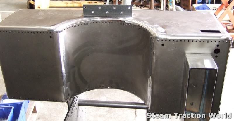

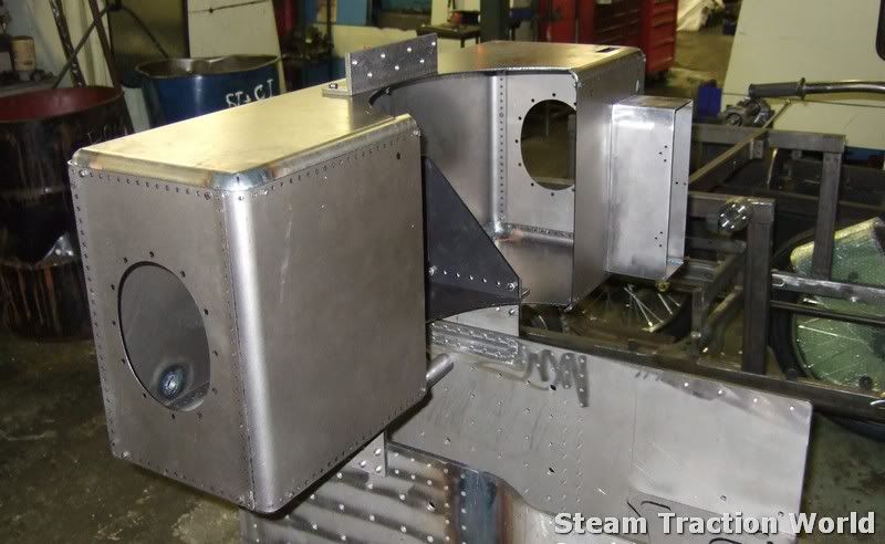

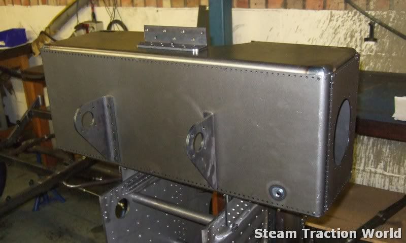

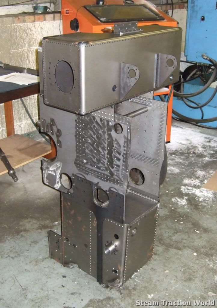

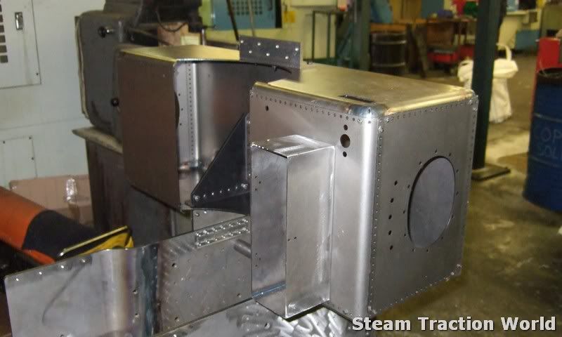

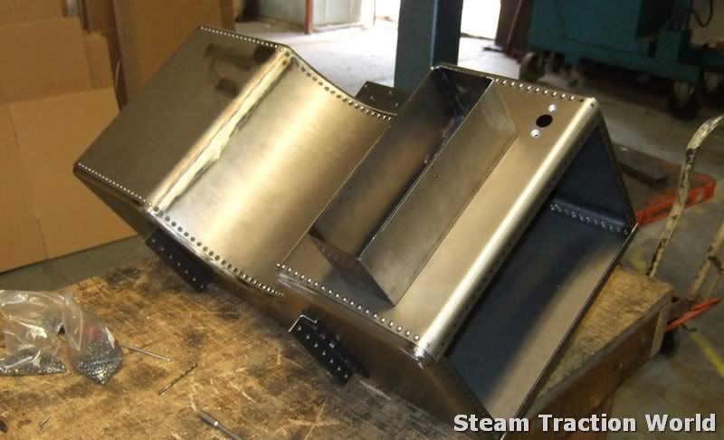

Post  craig@STW on Mon 19 Jul 2010, 7:31 pm

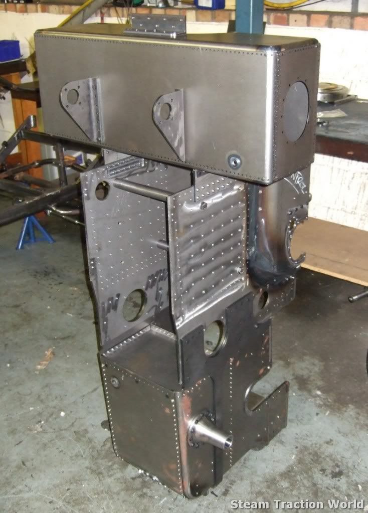

managed to get some photos of the half assembled tank although they are a little strange looking.
we found the best way to work on the control model was to stand it up-right, so it sort of makes the pictures hard to make out but hopefully you can see the progress we are making.
still going together well with no problems, design or production wise Razz lol! lol! i bet it will be packing that lets us down again Wink

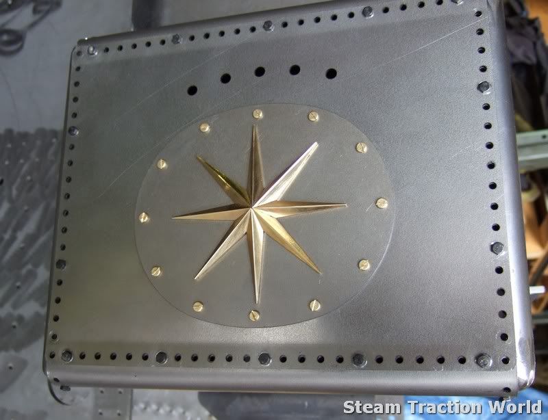

Post  craig@STW on Fri 23 Jul 2010, 9:10 pm

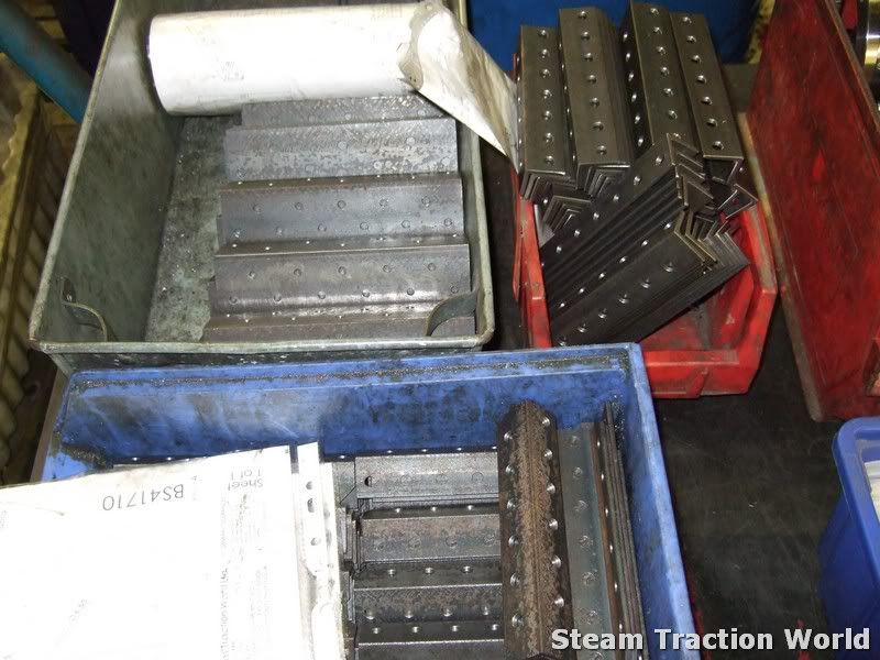

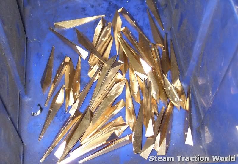

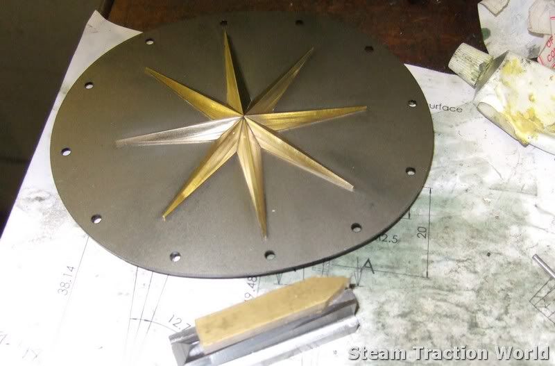

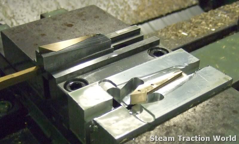

started work on the stars now. the brass blocks are cut to shape, drilled and tapped in the front of the vice and then bolted to the steel block and cut with a 45 degree cutter in the rear of the vice...
only 500 or so to make...
the first 8 bolted to a cover...
and fitted to the end of the tank...
clinch nuts pressed in the tank ends...

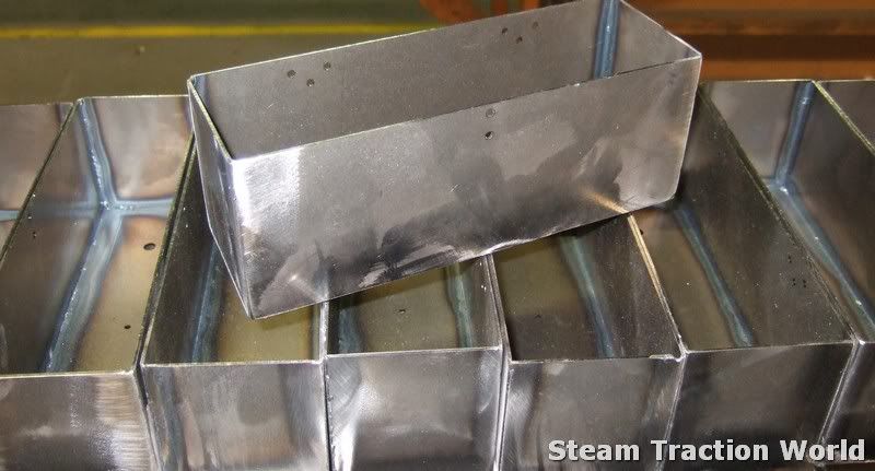

tool boxes...
first tank wielded and fitted to control model ready for the show this weekend...

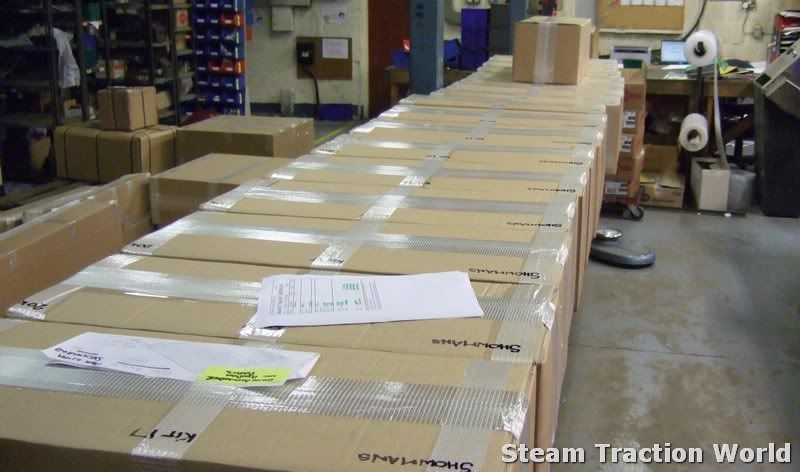

this kit will be going out tomorrow (Wednesday)
Number of posts : 1310
Re: showmans belly tank kit
Post  craig@STW on Wed 04 Aug 2010, 9:07 pm
kit went today Cool
