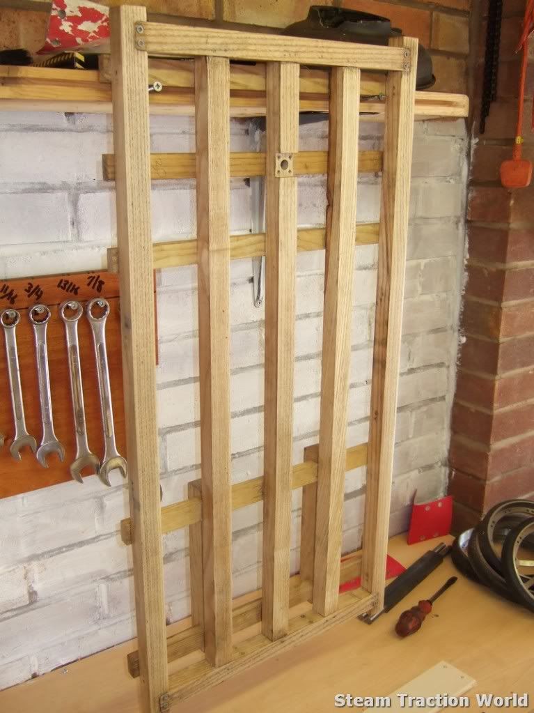

our control models only ever get put together to the point that we can be sure things fit, but at the end of it all we also like to use them to help sell the remaining stock, so someone has to go back, take it all apart and paint it all up properly.
so, im going to be doing the honors and i'll be posting photos as i go.

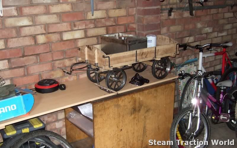

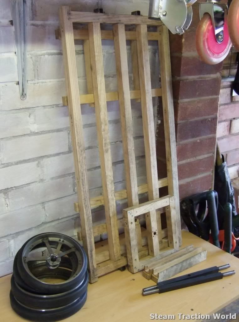

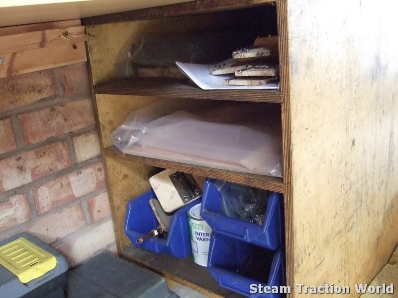

i took the model home last weekend and spent the rest of the day making a work bench...
started stripping it down today.
just have a few rounded off heads on the spokes of one wheel to sort out but apart from that it's back in bits.
going to enlist the help of a power tool to clean up the wood before its varnished and i may take the wheel components back to work and "rumble" them clean which should also provide a good key for the paint. will have to do the rims by hand.
i have new/clean wood for the drop-down sides.
going to be using clear varnish on the wood, a maroon colour on the wheels and black on all the other metal work.

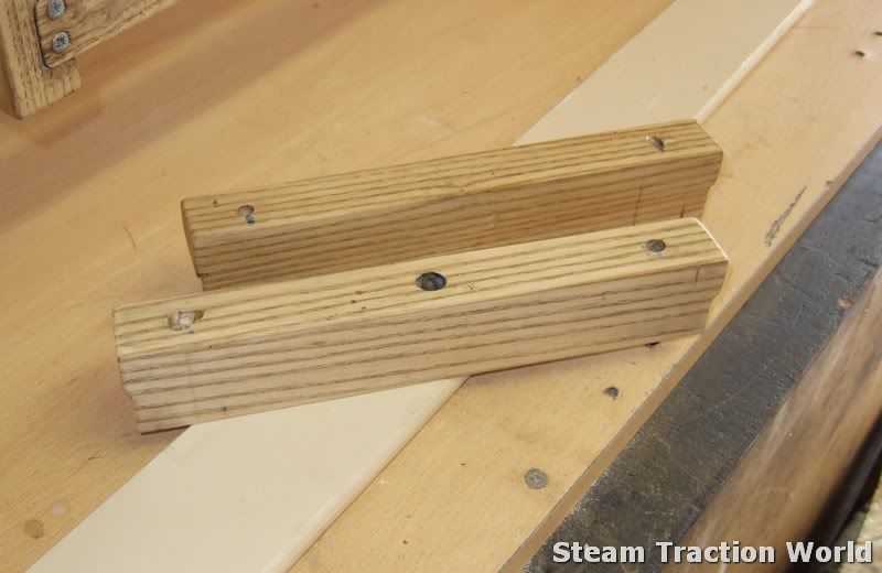

Post  craig@STW on Sun 11 Jul 2010, 6:56 pm

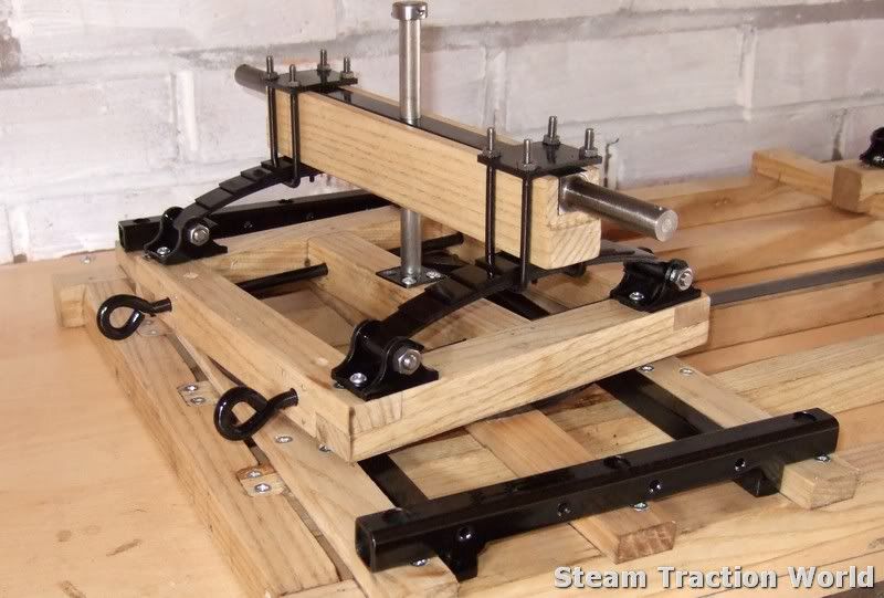

finally got some time to work on the control model.

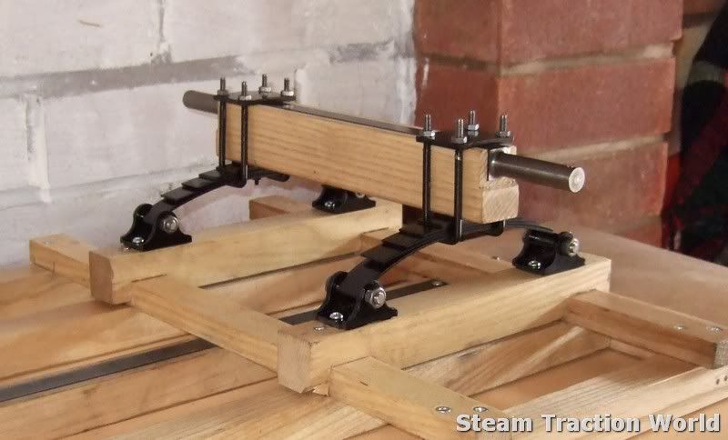

sanded down all of the wooden chassis and managed to get two coats of varnish on.

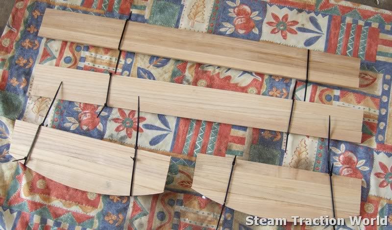

and started gluing the new sides ready for sanding and varnish...
going to start painting some of the more basic parts next week (foot rest sub-frame, axles, springs etc) so i can start reassembly.

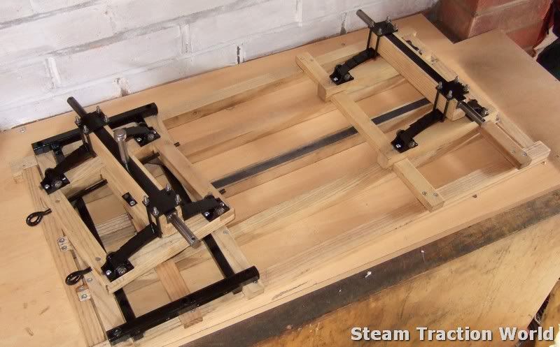

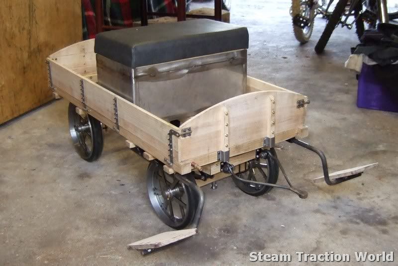

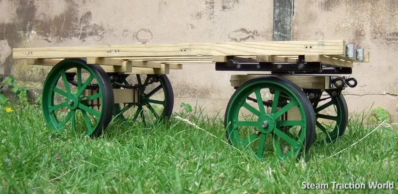

got some parts painted yesterday and managed to start reassembly today.
i've probably done the equivalent of kit two. deliberately leaving the wheels till last Rolling Eyes
not looking too bad...

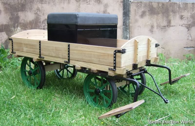

Post  craig@STW on Sun 05 Jun 2011, 6:34 pm

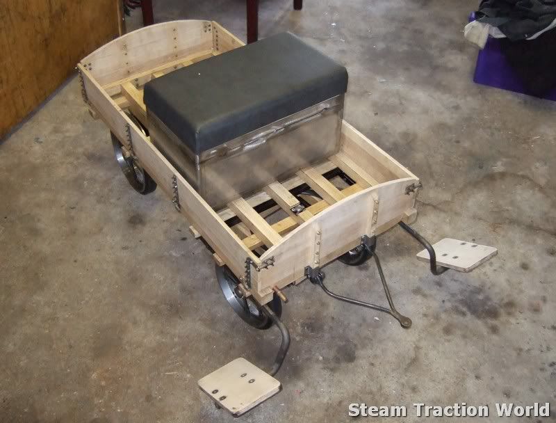

anyone remember the driving truck project i was doing ???
well with the open day next weekend it was time to get it done, so i've spent the weekend finishing it off...

Hi Craig,
Have allen head bolts been used instead of rivet bolts on the wheels?. Truck is looking good though, don't suppose there's any open day special deals on one ??.
regards
Andy
andyc
Number of posts : 43
Location : cambs
Registration date : 2010-03-02
Re: STW 2inch wagon control model project
Post  craig@STW on Mon 06 Jun 2011, 6:22 pm
the bolts on the wheels are dome headed with the Allen key holes in them (not sure what the proper name is.... dome head socket ???)
most customers would probably fill these in but the idea with this one is to let the customers see what they are getting and not over work it.
the paint is really just there to keep the rust away, you would be surprised at how quickly the unpainted control models start to rust.
