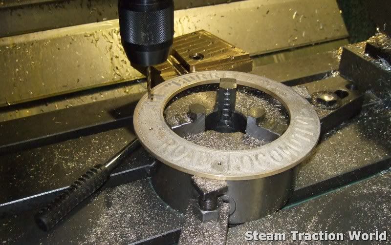

Post  craig@STW on Mon 24 May 2010, 7:21 pm
work started on kit 3.

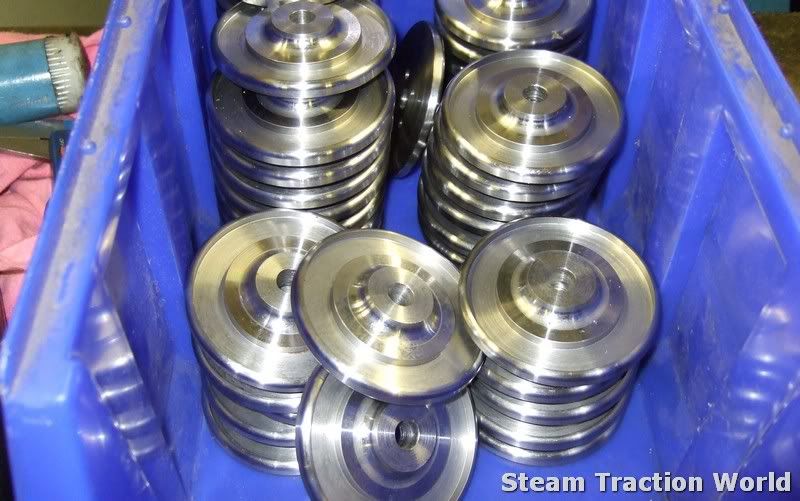

these are the small nameplate bosses. these need drilling to match the small nameplates then we will have the smoke-box door to drill to match the large nameplate.

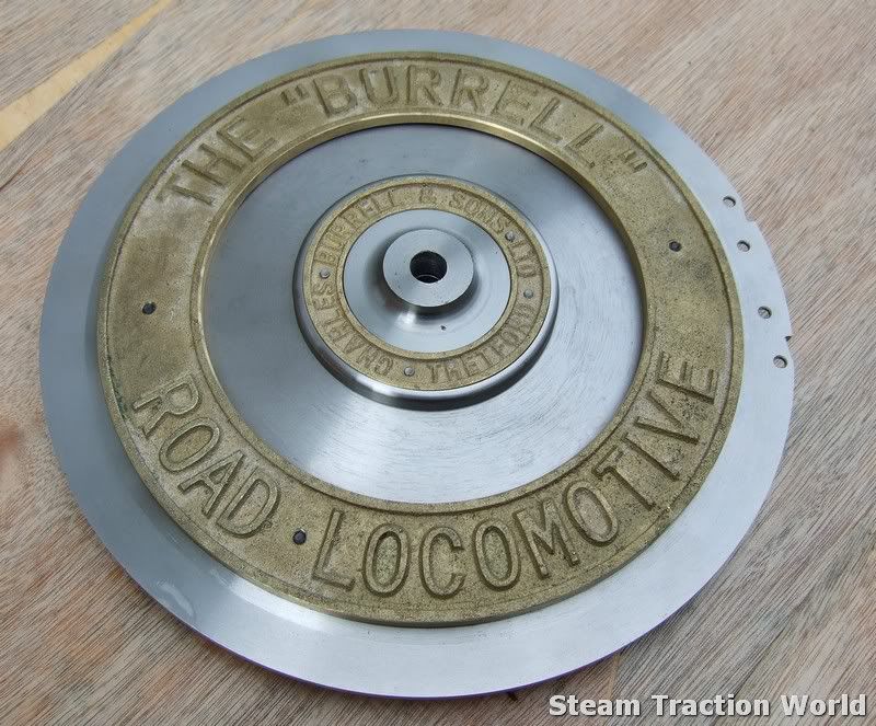

Post  craig@STW on Wed 02 Jun 2010, 7:00 pm
more work done on kit 3....

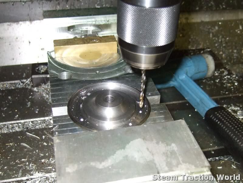

small nameplate boss on the mill today...
drilling the mounting holes for the small name plate...

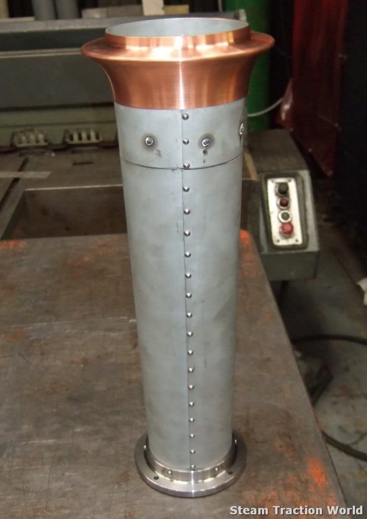

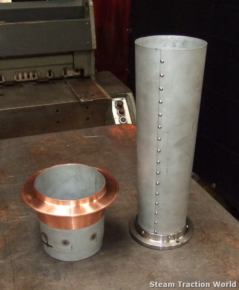

"trial run" chimney put together to prove the sheet metal pattern for laser cutting...
with removable top...
large name ring and smoke box doors following soon Cool

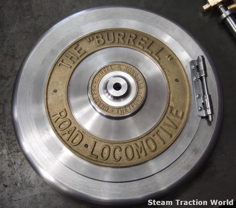

Post  craig@STW on Mon 07 Jun 2010, 9:55 pm

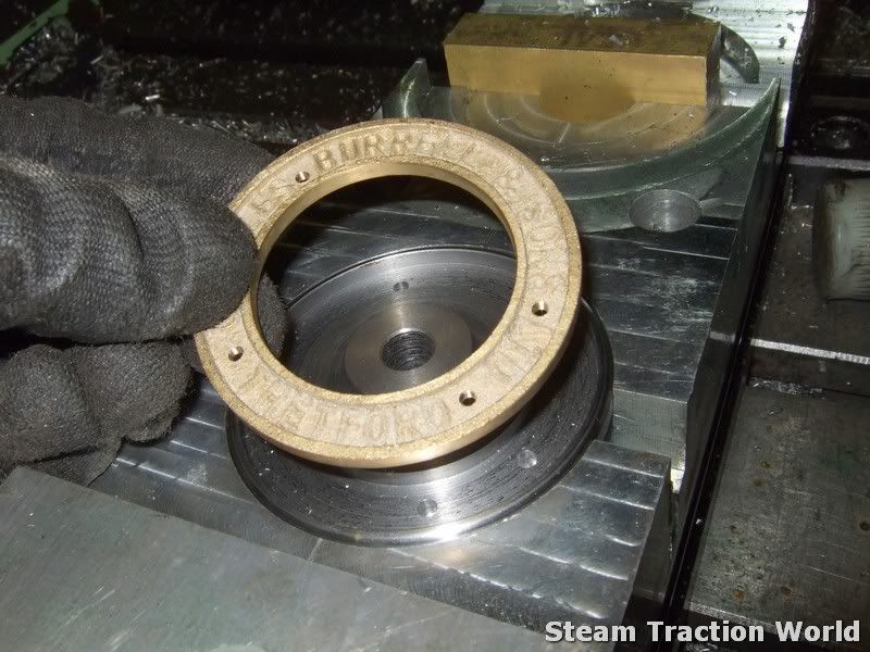

more work done on this kit...

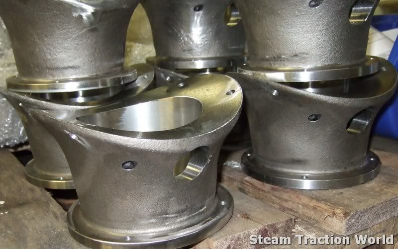

chimney base castings all machined...
large nameplate on the CNC for drilling...

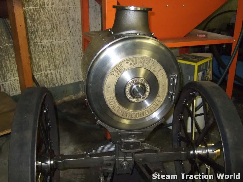

and the smoke-box door on the CNC for drilling...

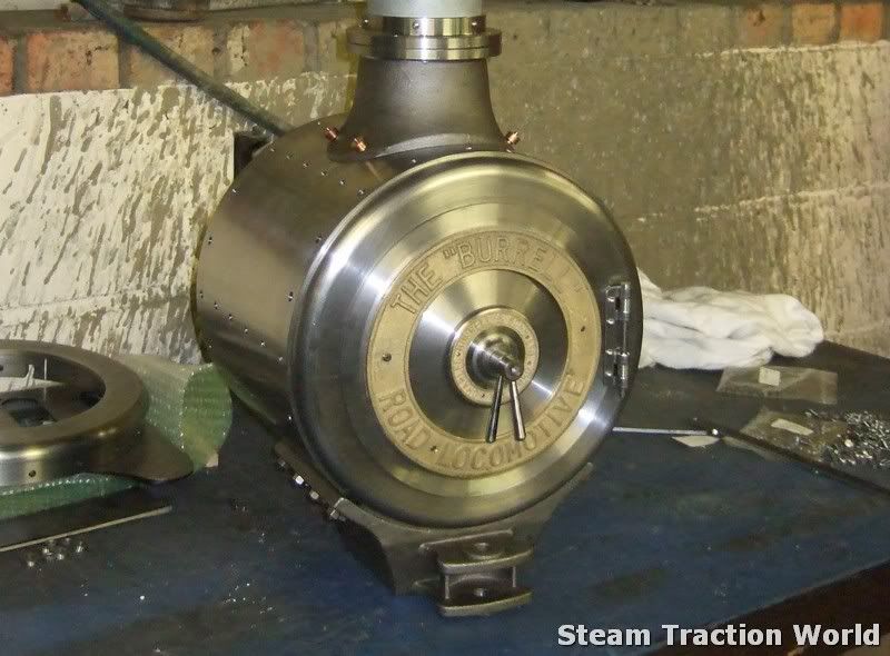

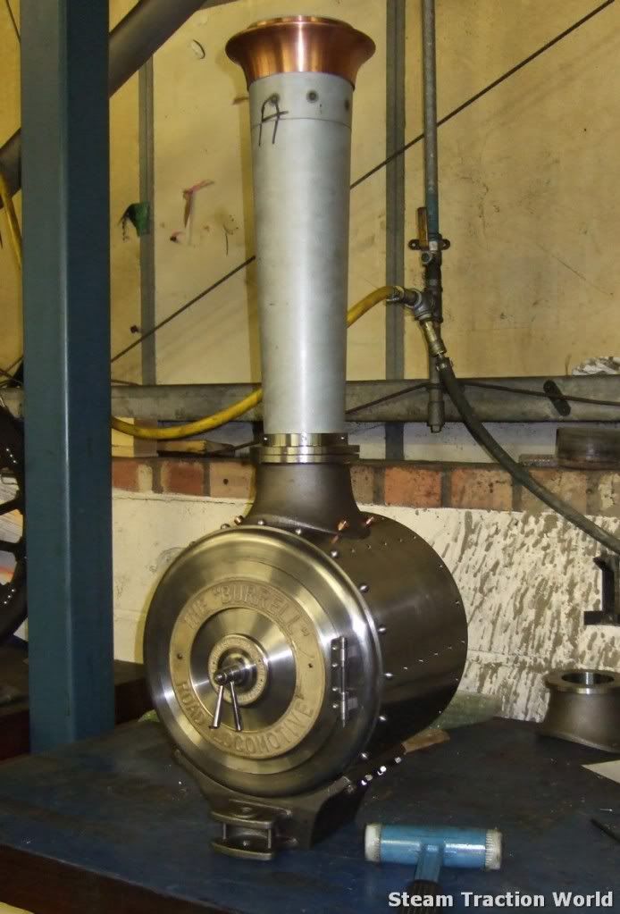

the door so far, complete with large and small name plates and nameplate boss...

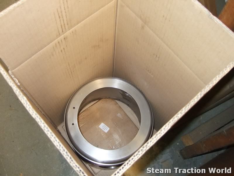

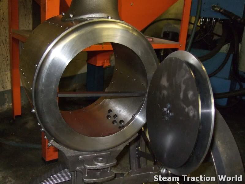

more progress with this kit. the smoke box rings and the door hinges are started/done. the hinge blocks are just prototype ones and we need to make them a little bit longer (you may be able to spot a couple of washers packing them up to the correct height)...

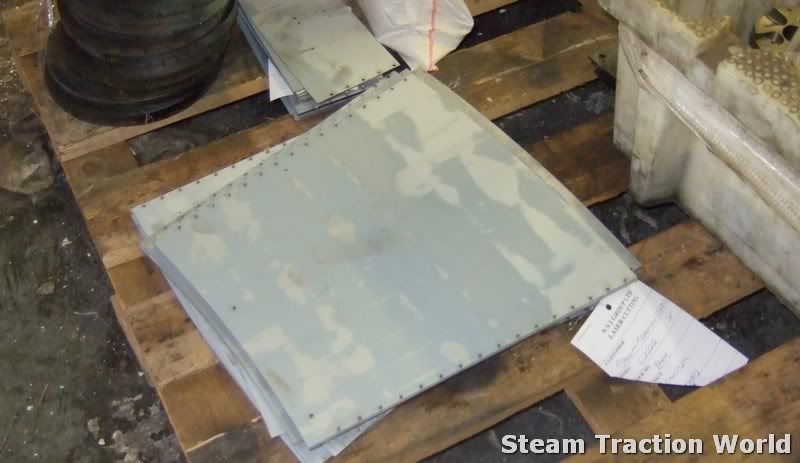

Post  craig@STW on Sat 19 Jun 2010, 6:11 pm
more progress.

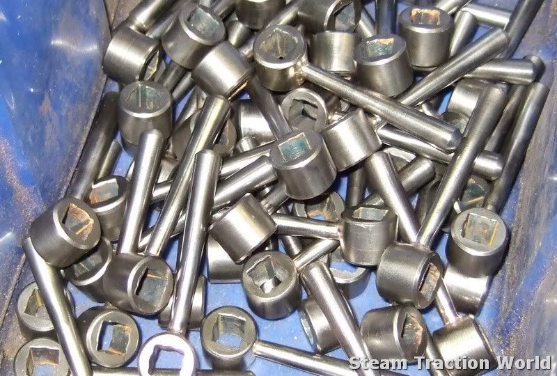

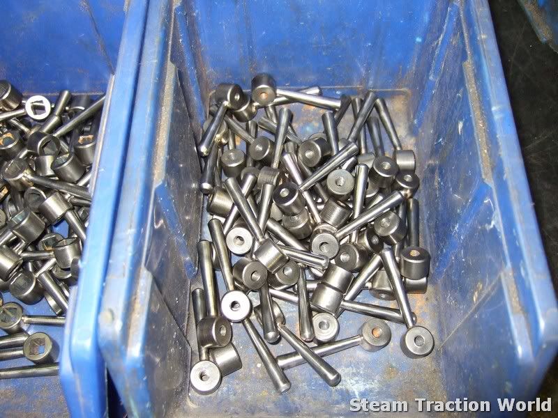

door handles...
and the outstanding laser cuts arrived on Friday...
and the smoke-box material has arrived !!!! Cool

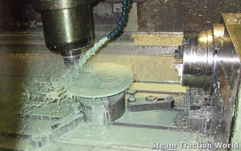

Post  craig@STW on Wed 23 Jun 2010, 9:35 pm
very close to getting this finished now cheers

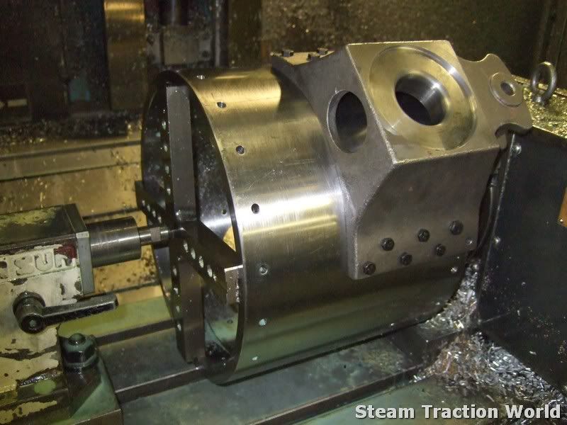

i got the smoke-box on the 4th axis mill today and full production will start in the morning. here's the first one...
the smoke-boxes will take a while to do so we have plenty of time to finish the last few parts. this includes rolling the chimneys (already started), final "scooping" of the chimney base to match the smoke-box (already started), 2nd op on 1000's of rivets (already started) and wielding the lug on the end of the dart.
can't see this going out this week but it should be done next week Cool

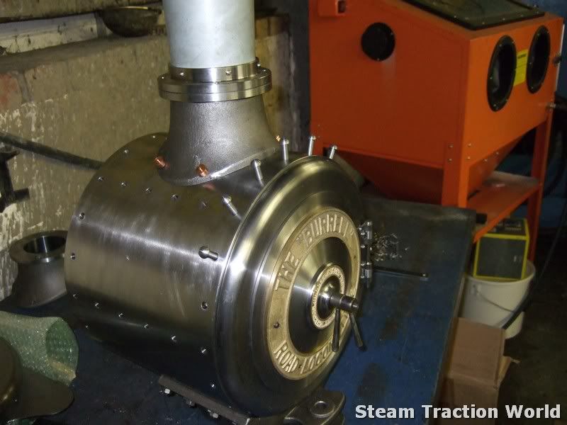

Post  craig@STW on Fri 25 Jun 2010, 10:01 pm

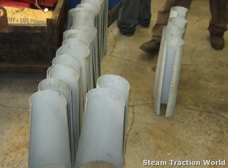

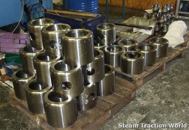

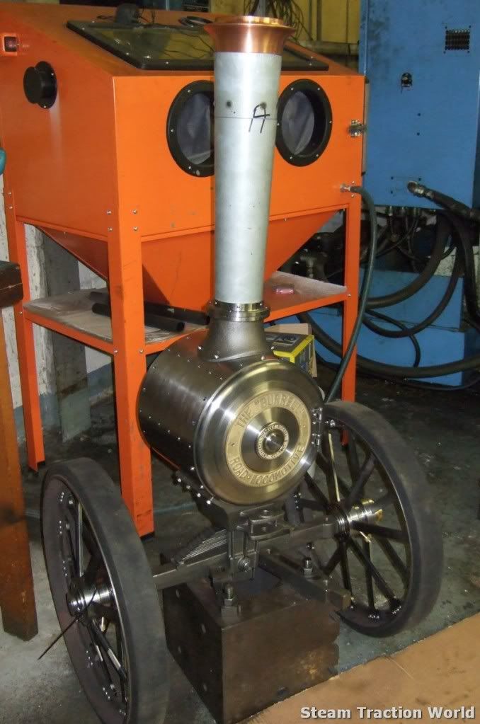

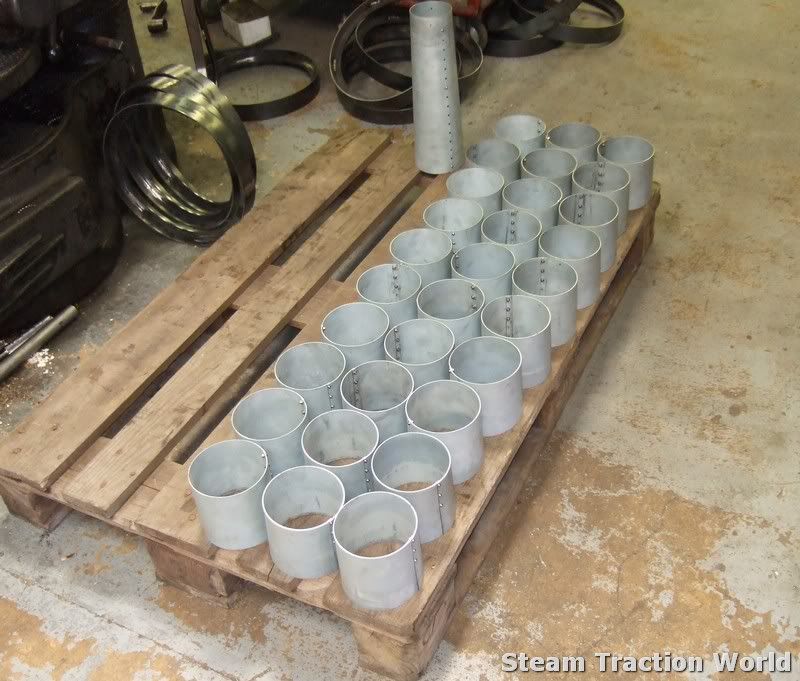

most of the smoke-boxes are done. showman's at the front of the pic and road loco behind. you can also see the chimney bases at the back...

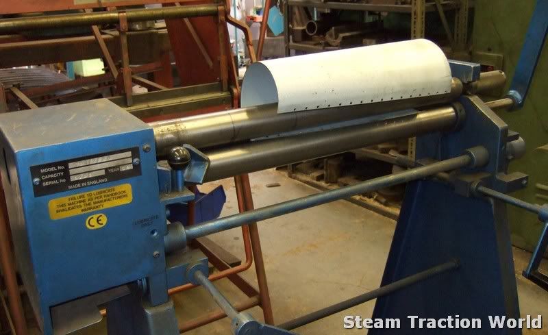

chimneys (or parts of chimneys)...
and being rolled...
and we mounted the kit on the front axle...

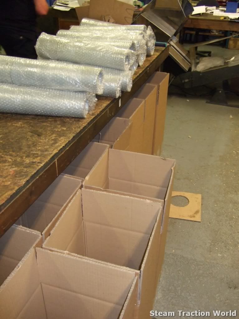

chimneys at various stages of rolling...

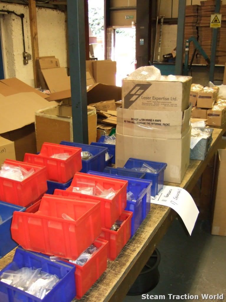

parts "are" going in boxes...
nearly there now, this will be going out Friday.
