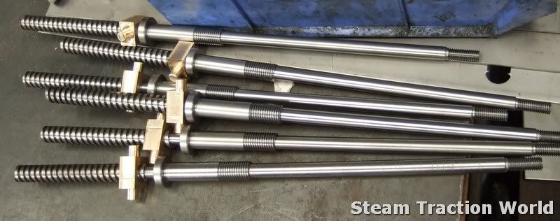

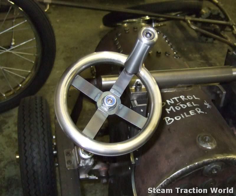

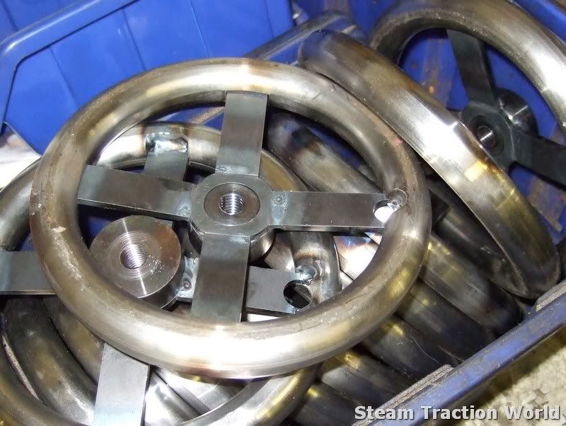

a few more parts made, steering shafts and nuts...

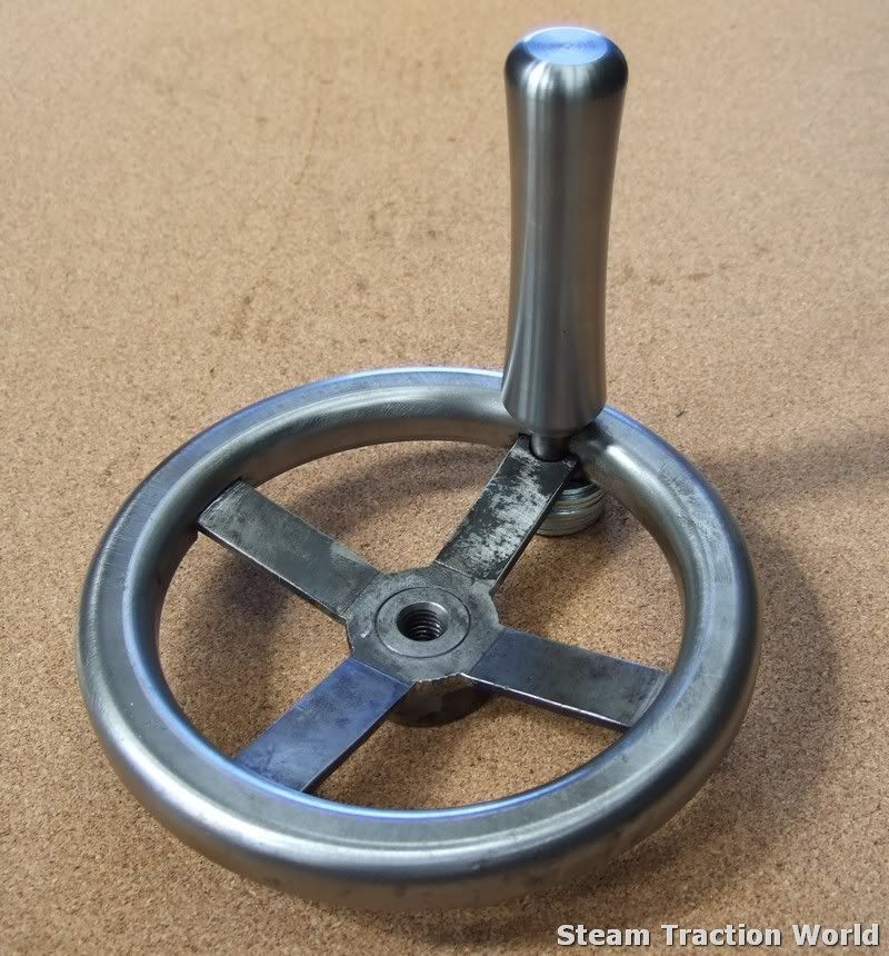

steering wheels now welded together. just need to mill them out for the new "bigger" handle boss...
and we have started turning the new handles. Steve thinks you can retro fit them to an old steering wheel by drilling out the old boss and tapping it to M8, so we will be making extra... PS: this is just a quick mock up

Post  tef 20 on Wed 16 Jun 2010, 7:34 pm
Craig is the steering wheel still the same diameter then? just a better handle
Re: Foden Kit 7
Post  craig@STW on Wed 16 Jun 2010, 9:22 pm
yes, but we are using a larger handle mounting boss.

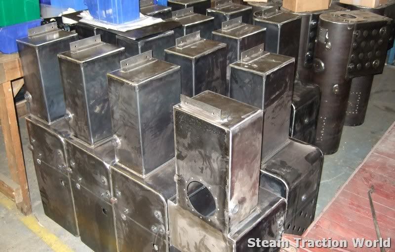

nearly finished this now.
all the tanks are done...

Post  craig@STW on Wed 23 Jun 2010, 9:19 pm
this kit is now complete, we are just waiting for the boxes to arrive and then the kit will be packed and sent out Cool
here's the finished steering wheel mod...
Number of posts : 1252

Craig,
My new steering wheel handle turned up today Very Happy that handle should make a hugeeee differance might actually manage to turn the foden around now whilst on the move.

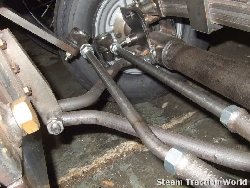

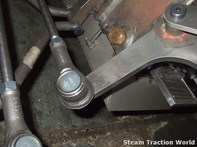

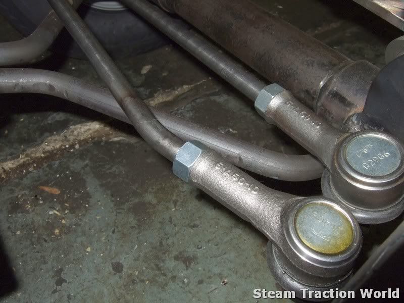

Craig

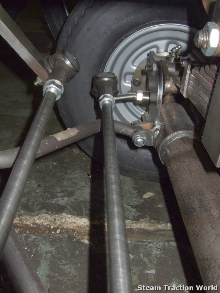

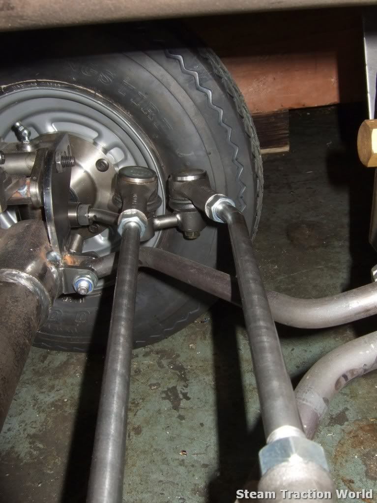

Can we have some pics of the steering assy as the build sheets refer to ISO 2 but looking at this sheet does not show the steering joints at all.
Age : 107

Post  craig@STW on Mon 05 Jul 2010, 6:27 pm
here are some pics of the steering joints. i hope they tell you what you need to know, if not just say and i'll take some more...
Re: Foden Kit 7
Post  Vapor on Wed 07 Jul 2010, 10:08 am
Thanks Craig, looks like they'll do nicely, give my thanks to Isobel the replacment bolts I buggered up (cut short) arrived Monday, Very Happy

Post  tef 20 on Wed 07 Jul 2010, 10:24 pm

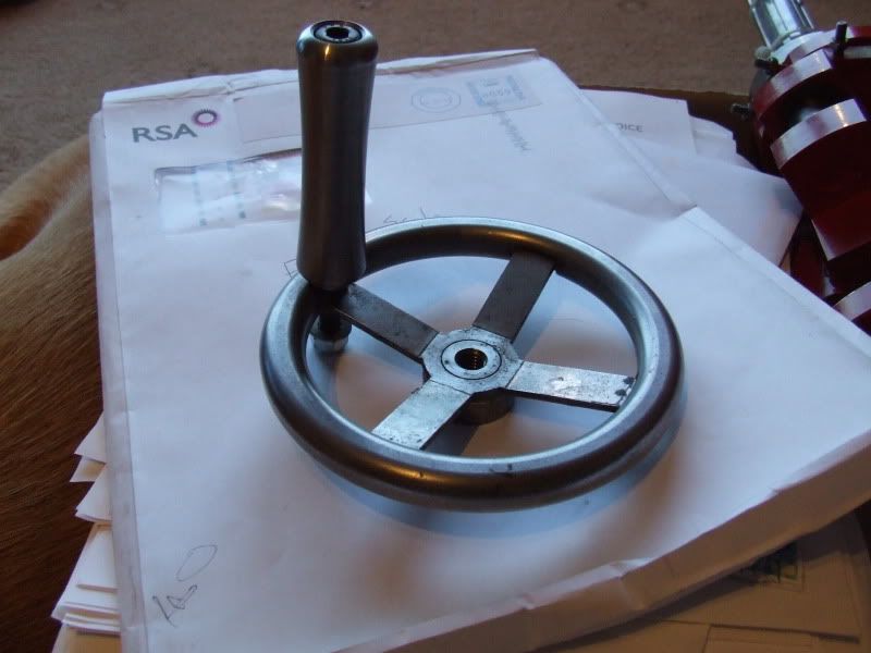

craig@STW wrote:r" handle boss...
Steve would be right then Very Happy
My handle turned up the other day and today i finaly got to the foden to get the steering wheel off!
I bored the old boss out a bit and tapped it M8 and filed the boss a bit to get the handle to fit flush all round, it works very well the only thing i would say is if you are like me and cant drill sqaure and dont have a milling machine just take an extra few minutes to try and get the drill sqaure as my hole went a little bit on the piss and the edge of the boss is now a little thin!
Pic to prove it works on the old steering wheel Very Happy
