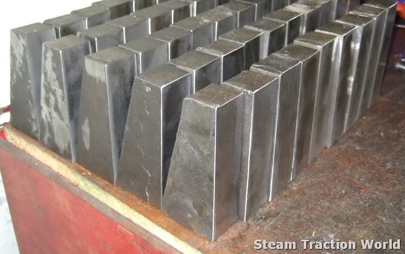

the next foden kit will contain the steering parts and the water tanks (originally kits 9 and 10)
i have ordered the material for this and there are a few parts that we have started as we wait for the next showman's kit to be sorted.
these are tank mounting brackets.
more news on this one as i get it

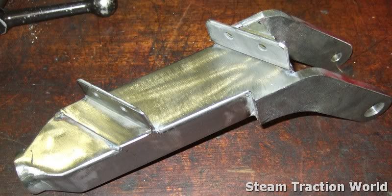

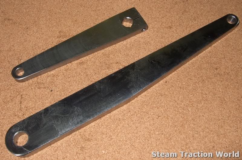

a few more parts done on this.
brake pedal and lever...

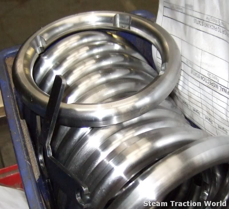

OK, photos...

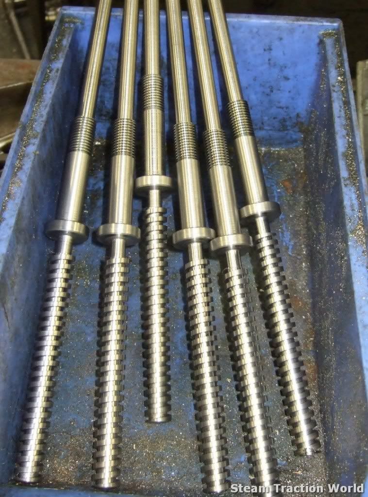

steering shafts...
steering wheel rims...

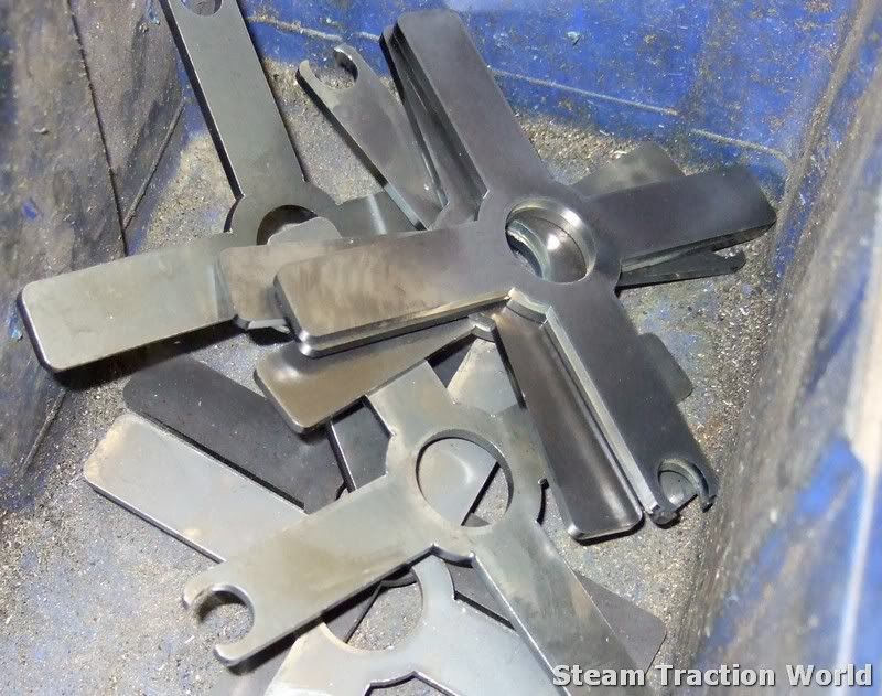

and spokes...

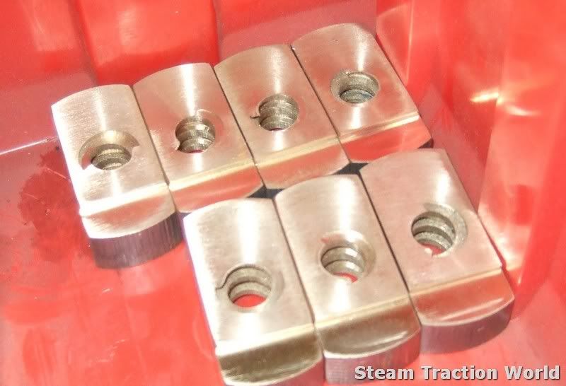

steering nuts halfway through machining...

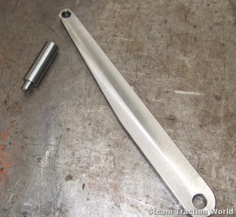

brake pedal parts...

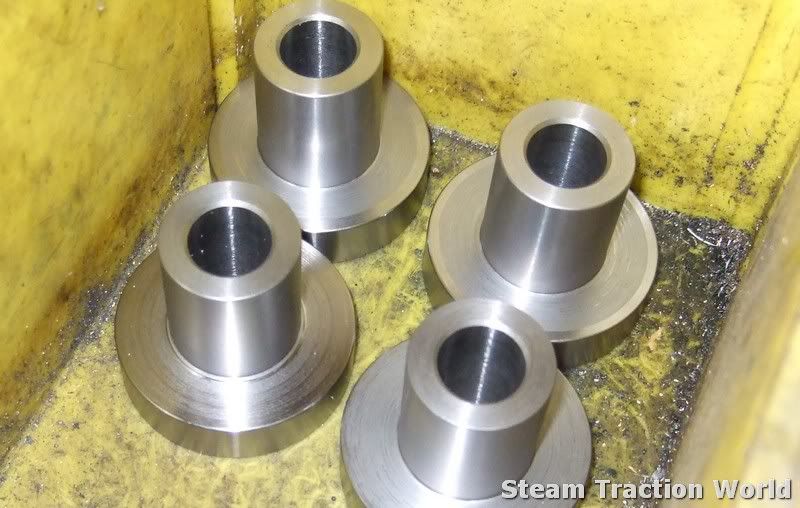

and brake pedal mounting boss...

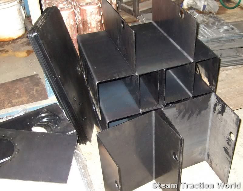

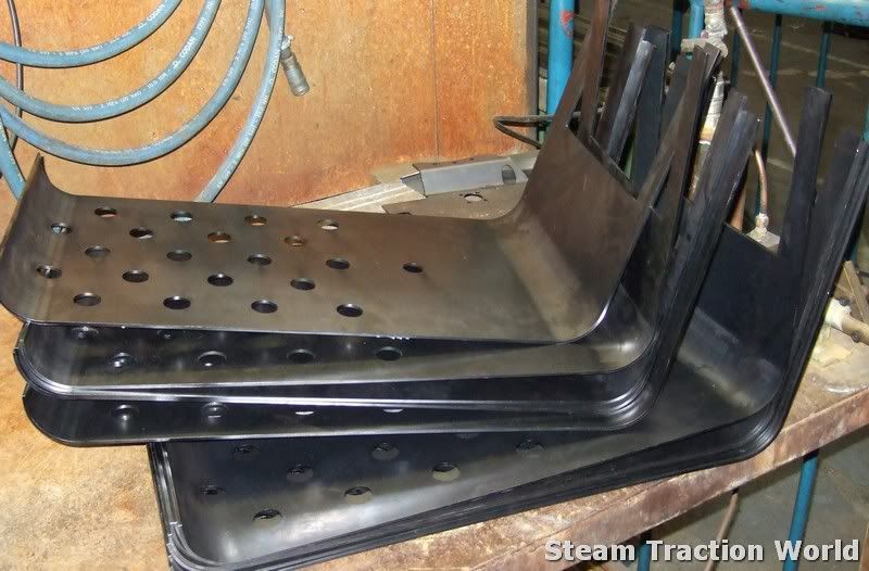

and water tanks parts during preparation...
im actually kicking my self now as the first of the tanks was completed at 3.30 and we mounted it straight into the control model. yes it fits Cool but it seems i forgot to take a photo Embarassed Mad Neutral . i'll get one for you on Thursday (day off tomorrow Very Happy )

After having my foden c type in steam all weekend i can definatly say Steve is right about the front brakes being over the top. Not once did i use the brake pedal, just shutting the regulator and a bit of planning was all that was needed.
Have you made the steering shaft plus nut any different to the c-type? the reason i ask is the foden's are a bugger to steer as you need two hands to turn the steering wheel because it is so tight maybe needs geared down a bit.

the steering is just about the same really apart from the tie bar and steering rod being shortened a bit. i wonder if the lack of weight from the brake drums will help any ????

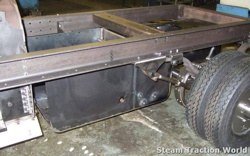

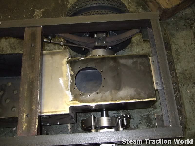

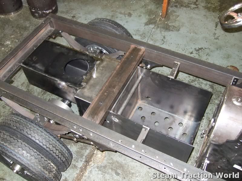

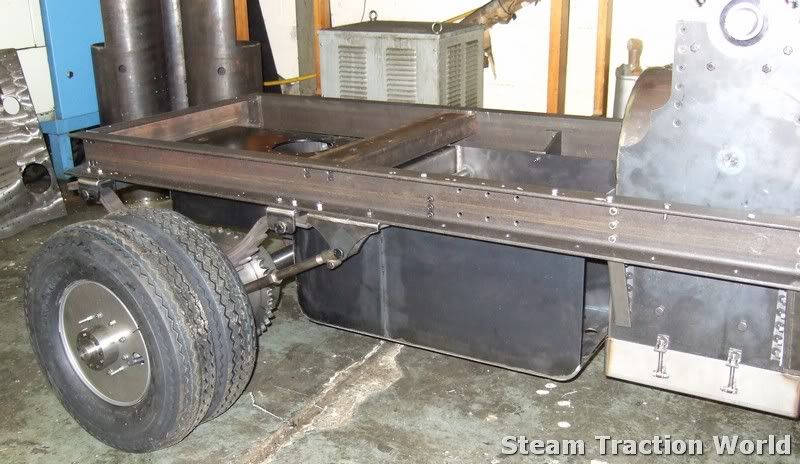

Post  craig@STW on Thu 10 Jun 2010, 9:13 pm
OK, here's the photos of the tank in place...
and steves looking at re-working the handle on the steering wheel to hopefully make the steering at least a little more comfortable to operate Cool
