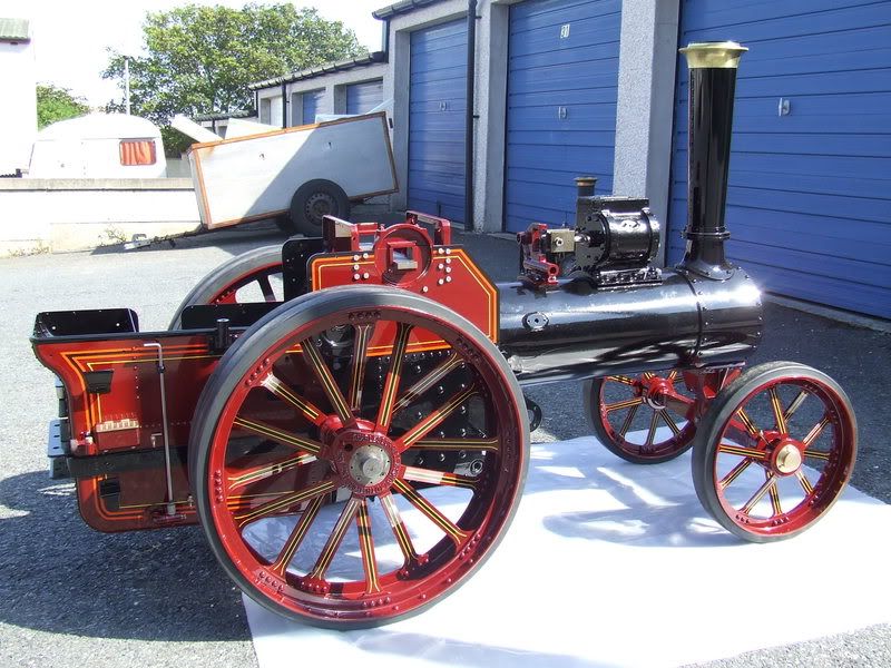

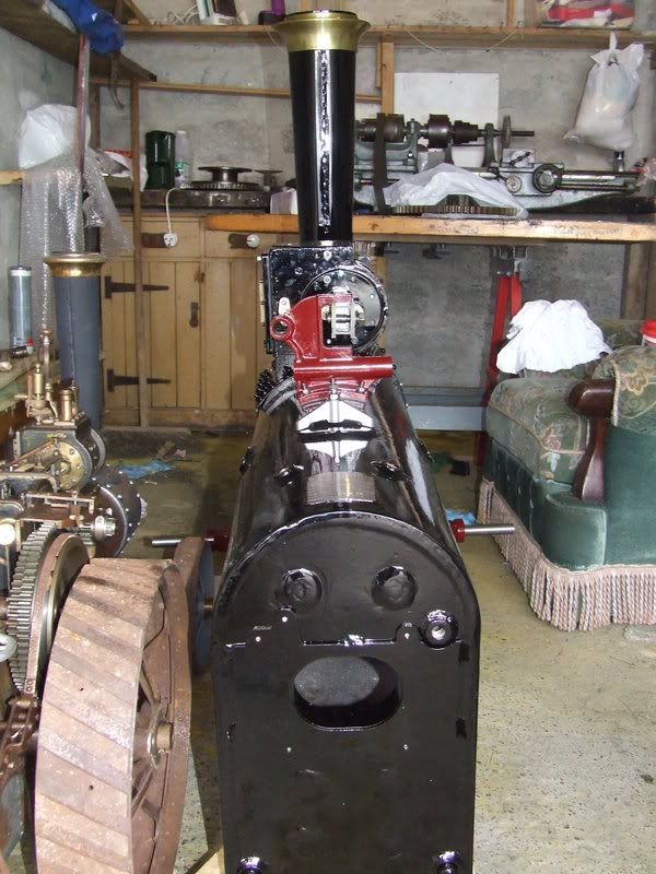

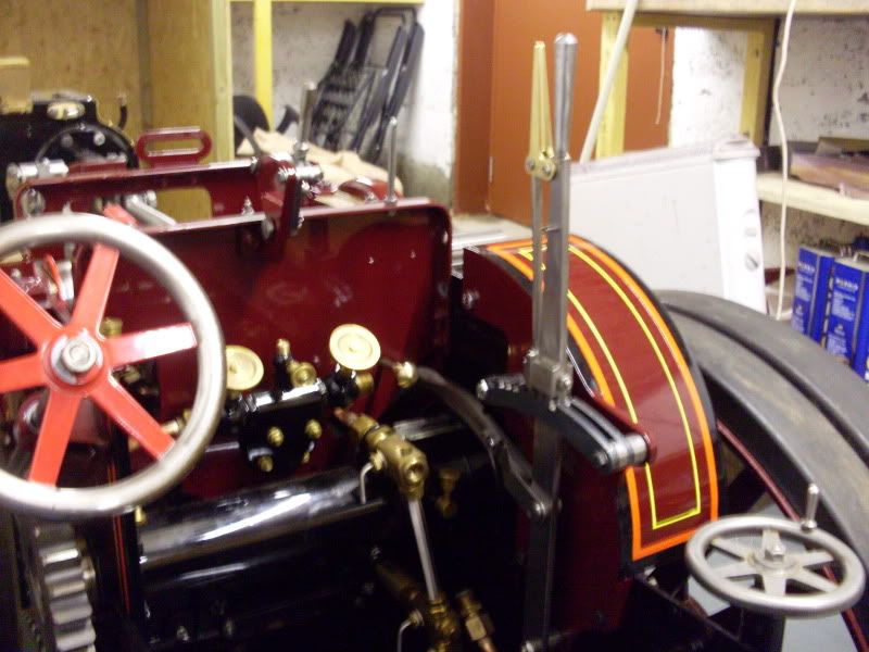

Post  tef 20 on Thu 19 Jun 2008, 8:43 pm
Here is some pictures of my 4" burrell under construction

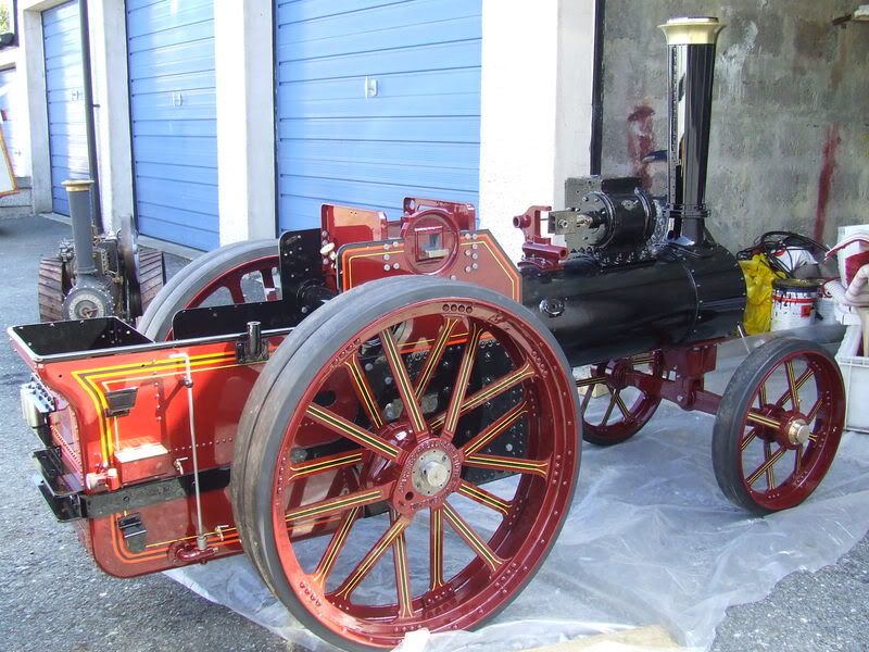

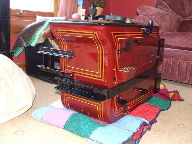

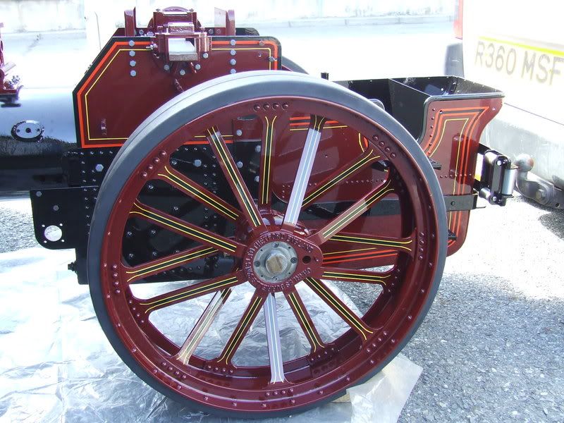

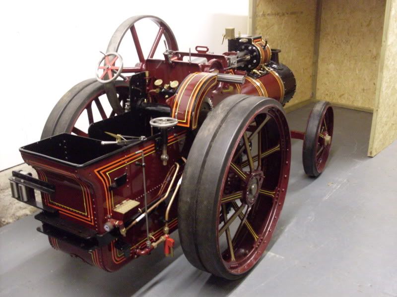

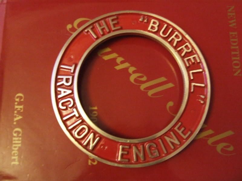

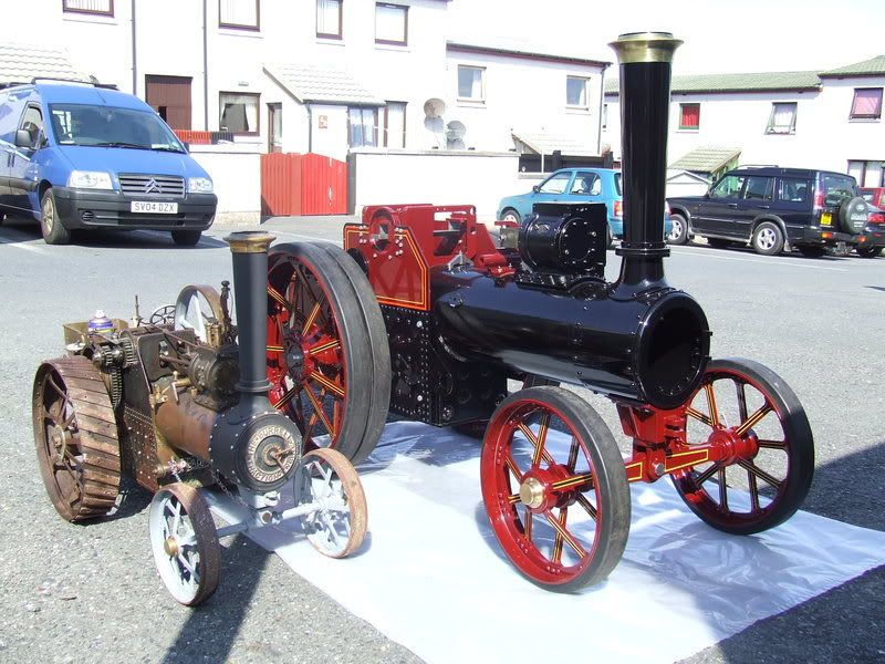

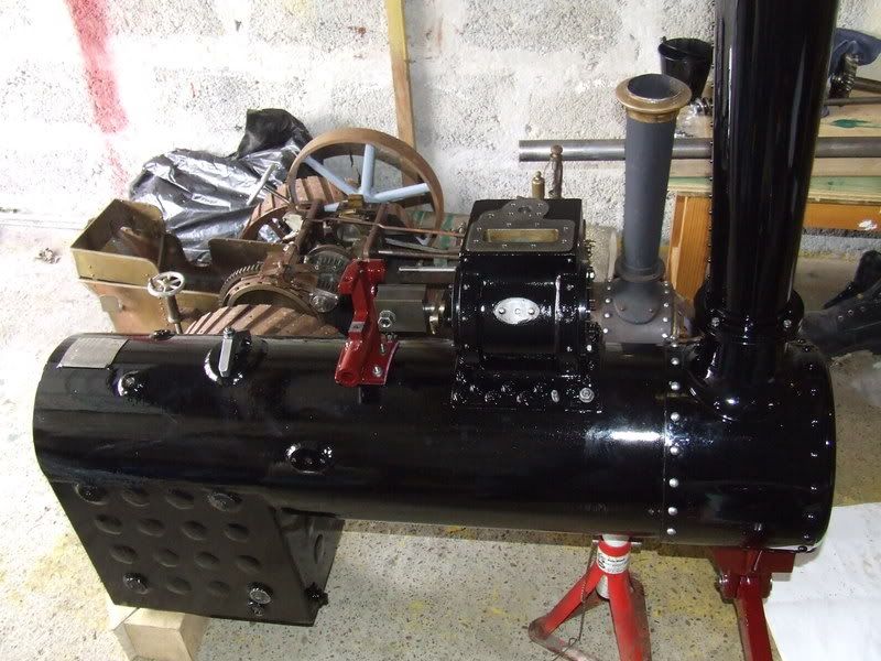

Post  tef 20 on Sun 02 Nov 2008, 2:00 pm
I thought you all might want to see an update as to how my burrell looks now. Its been a lot of hard work but i think its all paying of.
Has anyone got any tips on painting the front name rings and keeping the paint of the letters (apart from being cafefull with a paint brush)
mark Very Happy

Re: Photo's of 4" Burrell's
Post  Julia on Sun 02 Nov 2008, 3:46 pm
Mark, I cheated!
I sprayed everything an removed the paint from the letters. The top of my letter were flat and all it took was a rub with fine wet n dry.
Julia
Number of posts : 71
Location : South East England
Post  tef 20 on Mon 03 Nov 2008, 10:01 pm
Thanks Julia.
I think thats what the previous owner tryed exept it looks like he used something like a screwdriver to scrape the paint of the letters which has resulted in lots of deep scratches which i have been try to wet n dry out but it does'nt seem to be working so i will give it one more go and if it does'nt work i will order a new one.
mark
tef 20
Location : SHETLAND 4 1/2" foden
Post  tef 20 on Sun 30 Nov 2008, 6:37 pm
I got all the deep scratches out Cool and resprayed it the same way as Julia and it works very well a lot better than trying to brush paint between the letters.
Thanks again Julia Cool
mark
tef 20

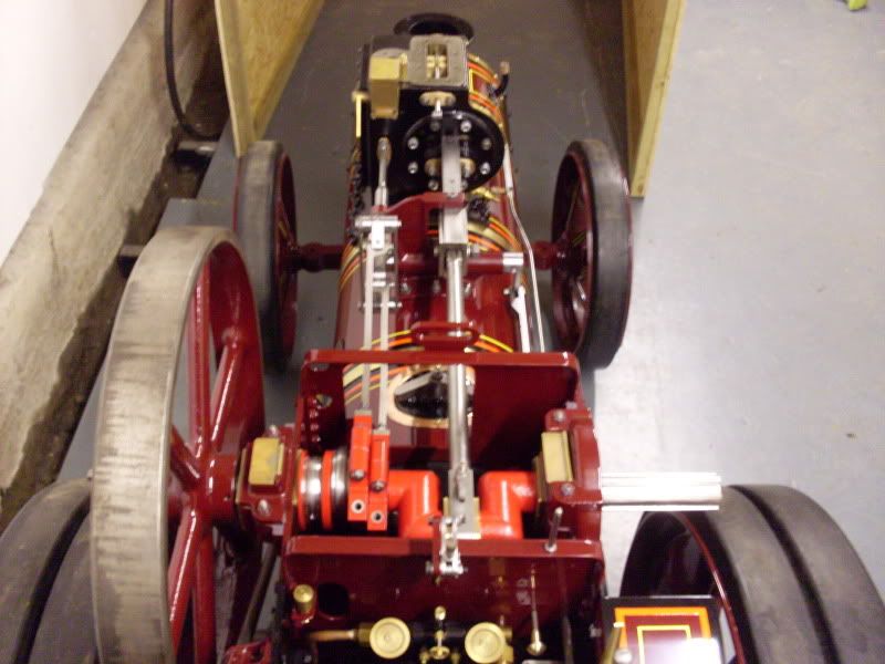

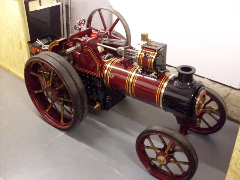

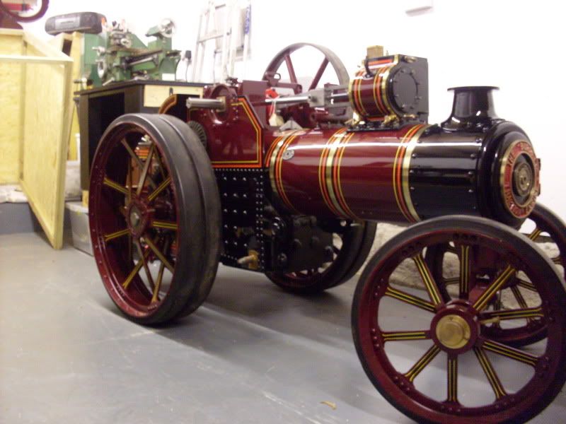

Post  tef 20 on Fri 27 Nov 2009, 3:33 pm
Here is a picture of how my burrell is looking as of yesterday Very Happy Hows yours coming on waterways?
