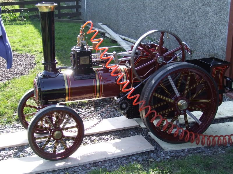

Here's where I'm up to in case anyones interested.. Smile a little way to go yet but it's starting to look like an engine.., the tender isn't bolted on yet because it's just personal preference to make that one of the most last items to fit to prevent scratching it up n stuff. the rear wheels are as you can see, a work in progress.

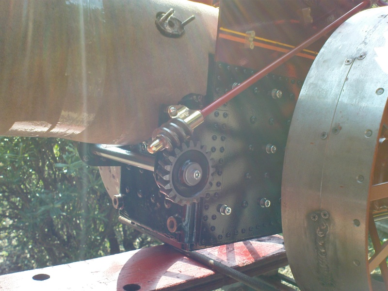

See now I looooooooooooooove da shiny stuff so decided to make a brass steering wheel handle, locking nut and bottom locking not at the worm gear, took a little while knocking the brass bits up but once on n shiny, in MY opinion, well worth the effort..
May all your linkages be well oiled and your fire burning hot..

I only picked my kits up a month or so ago so i am a fair way behind you all, but it's good to see some photo's for refence of an engine thats not nearly finished. After studying the photo's ( probably for far too long ) i have the following questions i'd like to ask.
I like the chequer plate floor in the tender. Did your's come like that or have you added that yourself.
Have you tac welded your back wheel rims together ?. Seems like a good idea.
I wondered about painting the wheels before putting the tyres on. How easy is it to clean isoflex off paintwork.
Your wheel rim joiner fixings seem to be staggered on the rim ( hope my description makes sense ) where mine are next to each other ?. I was going to araldite my wheels this afternoon. Think i'd better check i haven't cocked them up first as mine look different.
Have you tac welded your back wheel rims together ?. Your wheel rim joiner fixings seem to be staggered on the rim ( hope my description makes sense ) where mine are next to each other ?.

How do Andy, okay firstly the chequer plate is of the very HIGHEST quality let me tell you.. Okay it's from B&Q really, nice n thin alli sheet so it's easy to cut and bend etc, secondly, yep, I used the works TIG to stick the rims together, was just a personal preference that's all mate, as for the joiners, yup you're right, in the picture they do indeed go straight across but mine wouldn't have fitted like that, I hazard a guess that those little cross straps were a couple of mm longer but staggered they are, on both wheels to so at least it's all matching, either way I'm not fussed, they do the job and they're painted over now so you dont really notice if I'm honest, as for cleaning goo shit off of paint, I gave/will give the paint PLENTY of time to cure nice n hard then mask off, that way, any dribbles of crud where it shouldn't be will come off just that little bit easier, course it's better to not rush and make mess in the first place that way this question won't be relevant.
