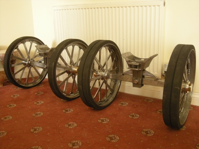

Post  Steam Traction World on Tue 16 Mar 2010, 11:31 am
Here's Steve Traill's and my Kit 1 & 2 assembled and put next to each other. Steve is doing the crane version which has slightly wider fronts wheels and double tyres.
