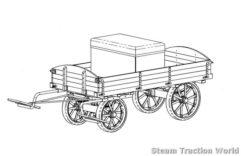

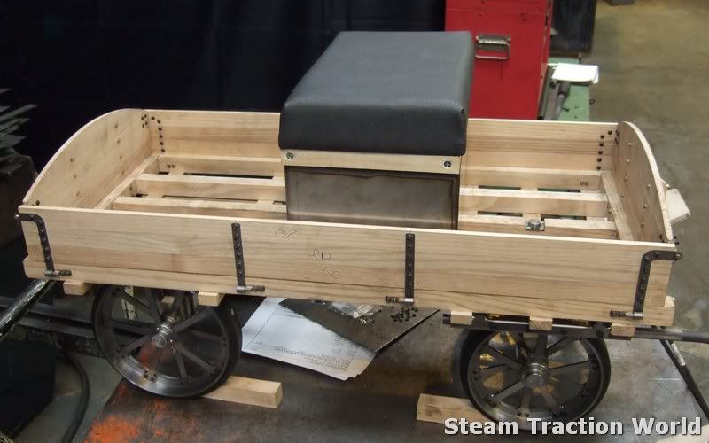

yes, the water is gravity fed. there is an outlet at the bottom of the tank and a pipe runs under the floor and out through the front cross-member, complete with a tap/valve...
basic kit will look like this. sides, front, back, tank, pipe and seat...

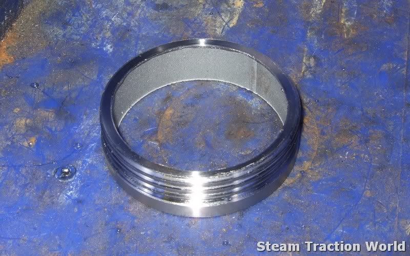

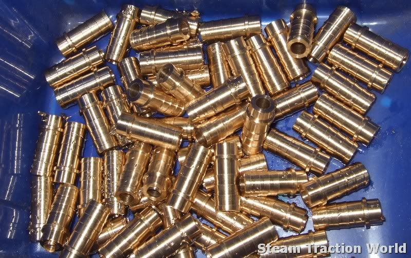

just starting to turn a few parts for this now.
this is the hose connection part of the water pipe...

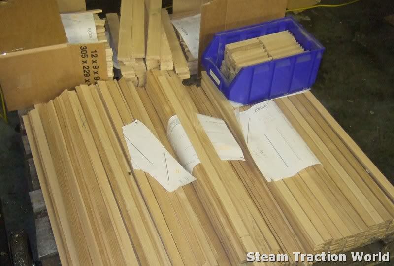

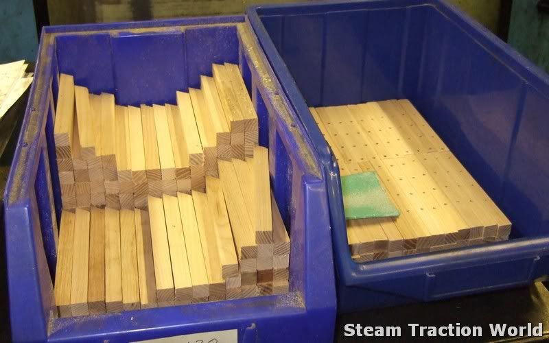

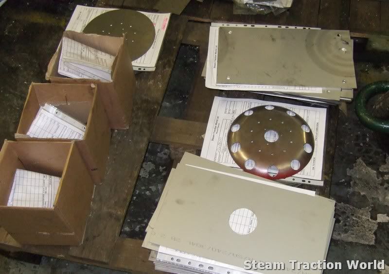

starting to get organised on this a bit more now.
we have the wood cut to length...
and the parts for the water tank are starting to arrive (along with foden hub caps)...

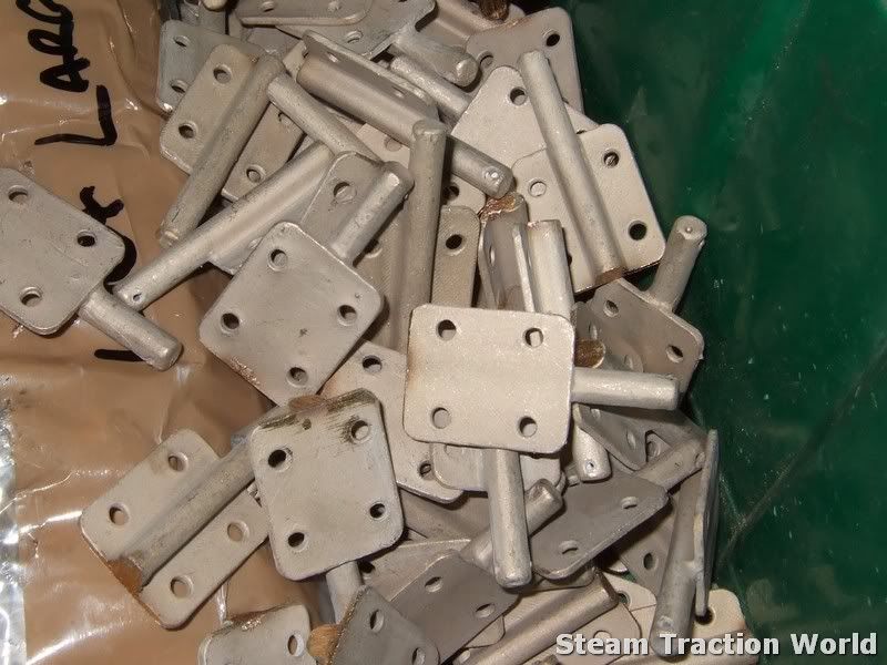

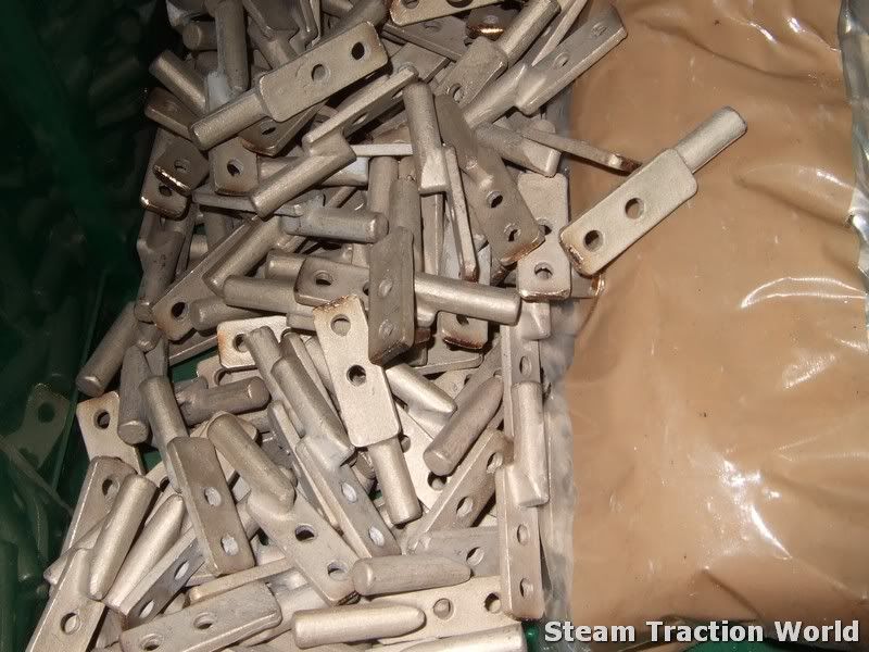

casting for this kit arrived today...
hopefully we will get this knocked on the head over the next couple of weeks

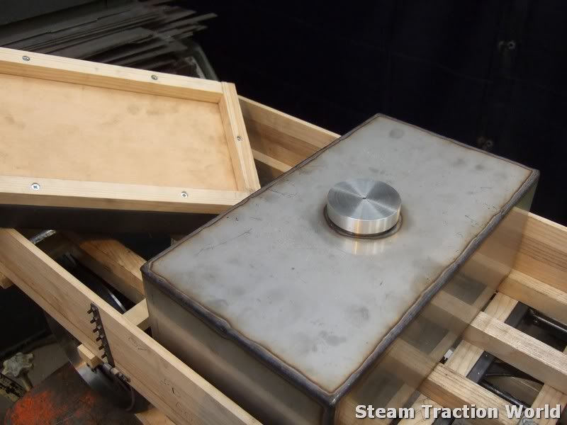

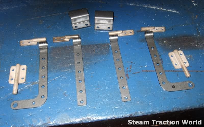

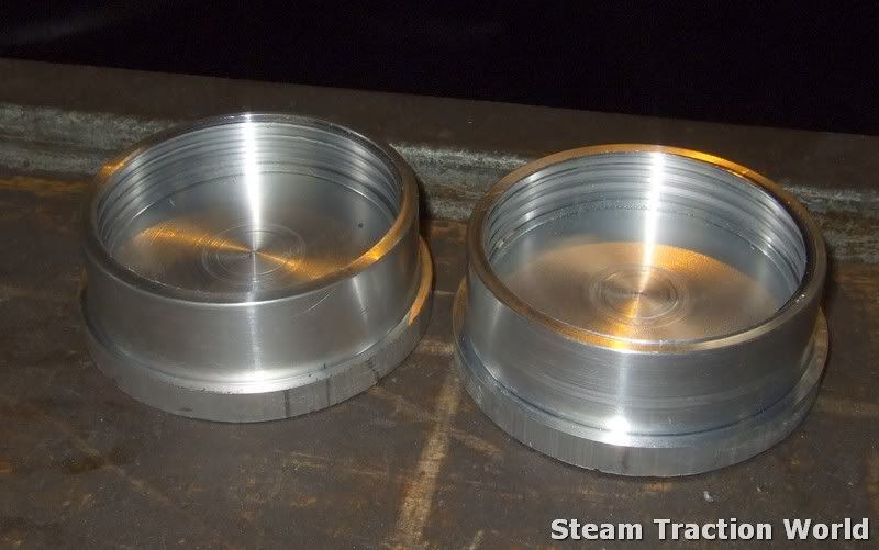

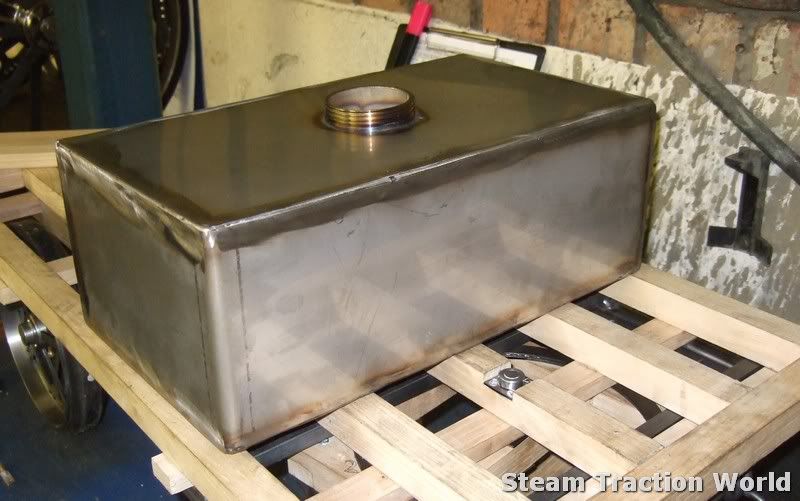

really getting on with this now. all the wood is done. all the brackets are done and the first water tank went together today.
gonna take a while to do all the tanks but should be done by next week sometime
first of the tanks...
filler neck...
and 1st op of filler cap...
filler neck...

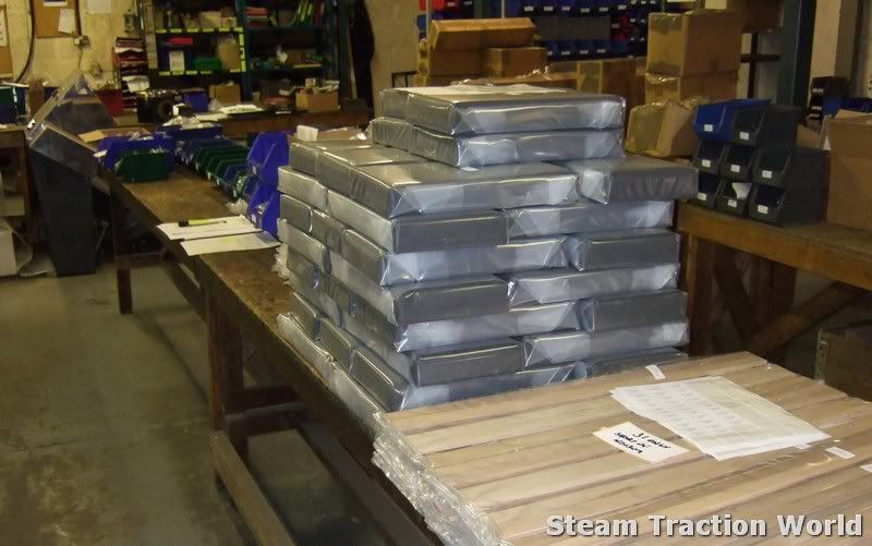

just waiting for the boxes to arrive on this one. should be here friday so hopefully this will go out then or maybe tuesday.
got some photos for you later

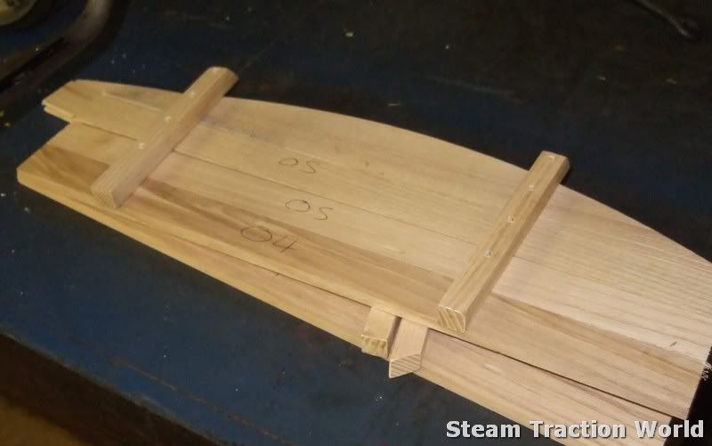

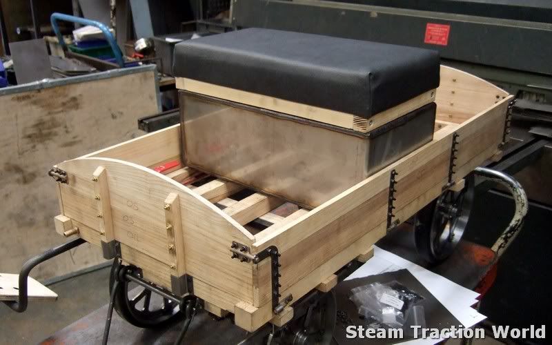

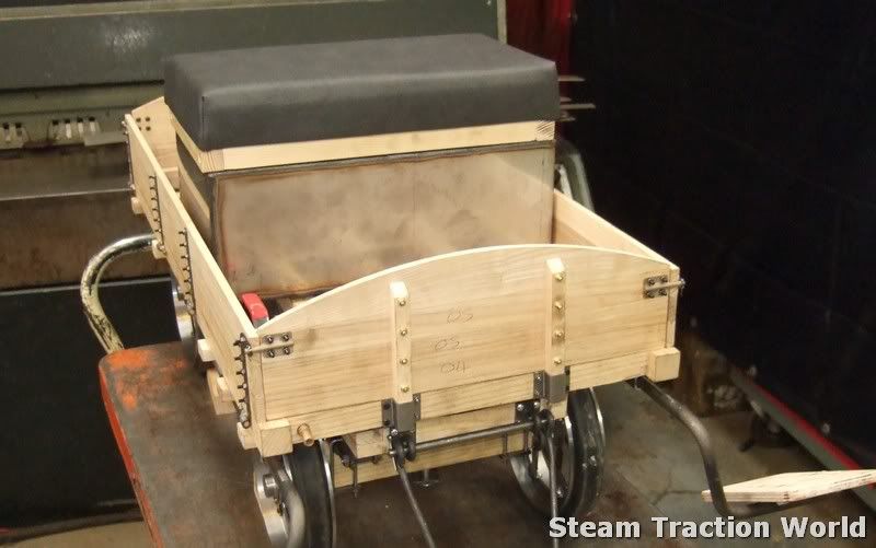

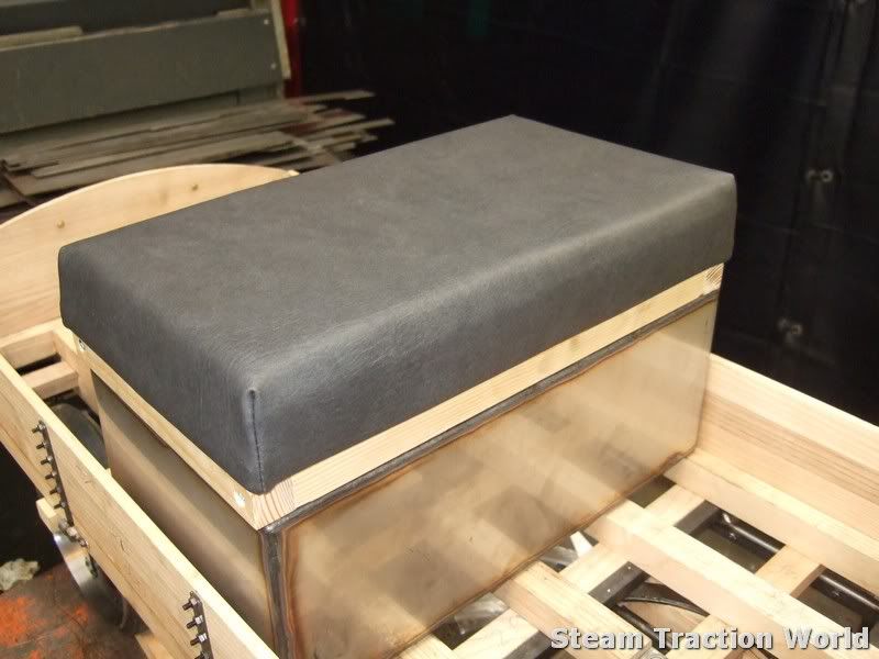

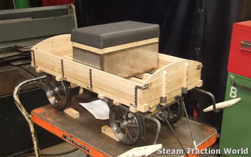

almost done on this now, just attaching the seat retaining parts to the water tanks and after getting the control model together and hooking it up to a 2inch burrell we have decided that the tow hitch/draw bar supplied in kit two is a bit too long, so we are going to be supplying shorter ones for you.
still planing on getting this out tomorrow.
here's a few photos, please note, you will not be able to see the wooden batons on the bottom of the seat once the retaining strips are on the tank.
just about ready to go...
