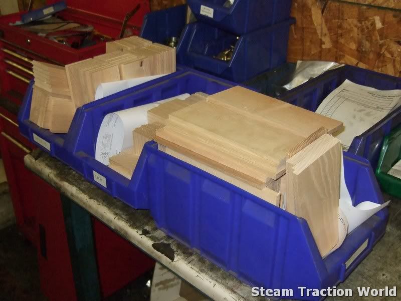

work has been started on kit 23 but we won't be able to complete things until the wood for the tool box arrives in a couple of weeks.
some of the parts for the seat assembly are done...
tool box mounting brackets...
and rear trim pieces...

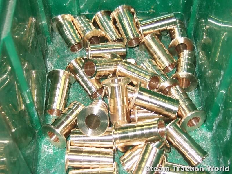

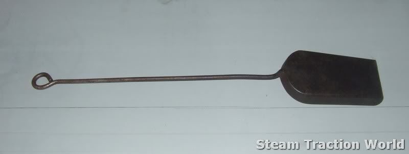

water lifter parts...

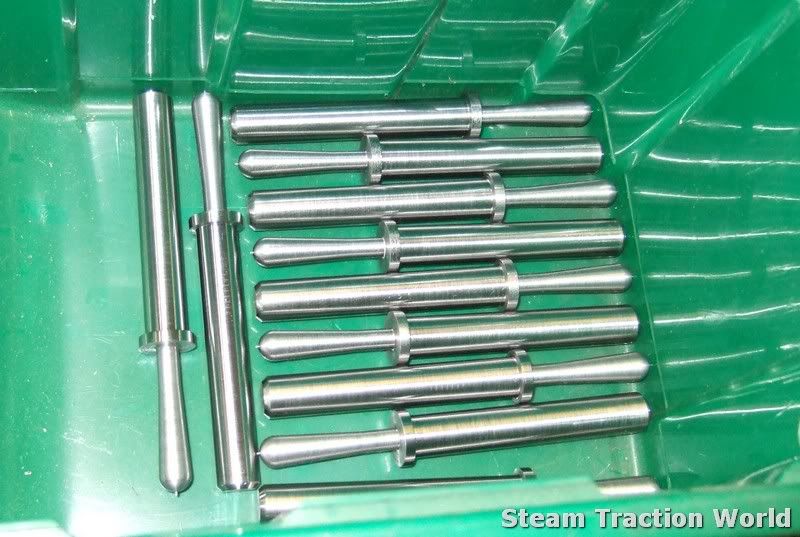

towing pins...
and shovels...

towing pins...

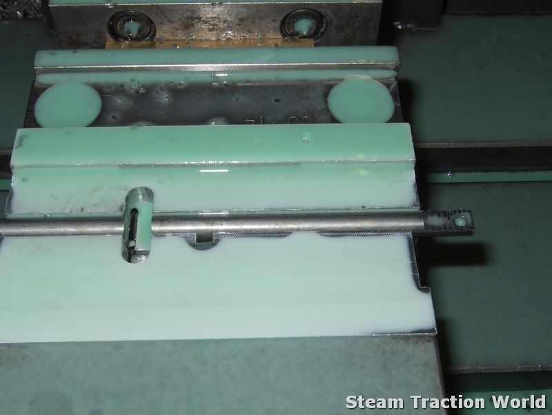

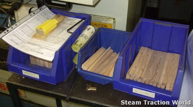

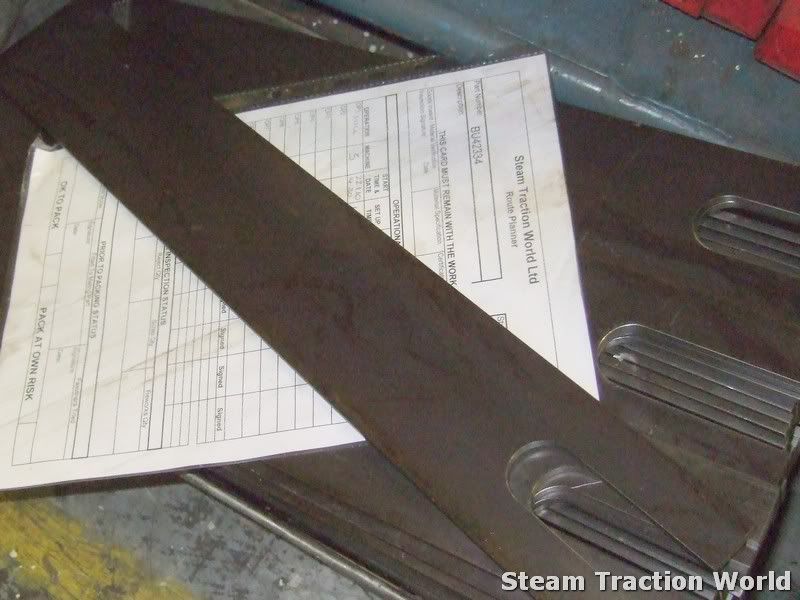

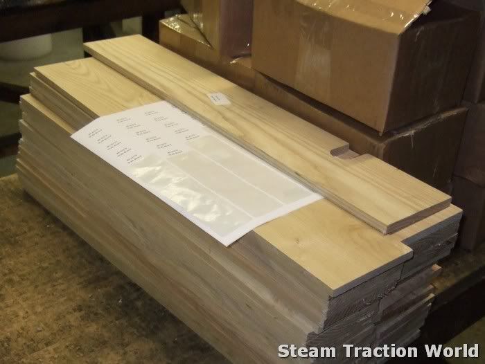

with the foden out of the way we are now back on this kit. the items below were actually photographed at the end of last week, hopefully all the rest of the work should also be done by now.

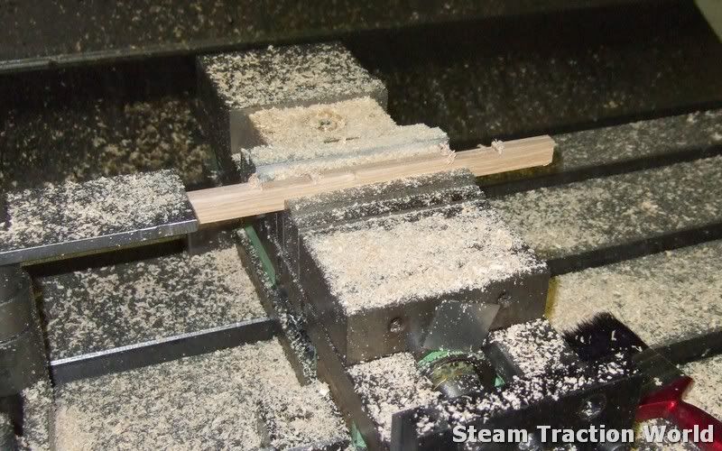

with the wood now here we can get the toolbox done...
it machines very well on the CNC as long as you have a nice sharp tool in the spindle...
these parts are having the lugs cut for the hinges. when we work on the wood we have to work very clean otherwise any grease on our hands will just contaminate the wood and make it look filthy. it can be ruined in a mater of seconds. it's best to have one guy working on the wood and nothing else...
tool box lock bar on the CNC...
and foot rest assemblies...

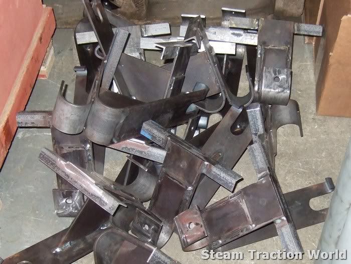

well the kit has gone at last

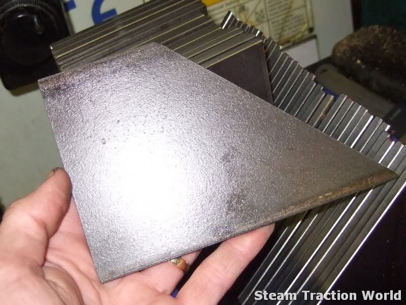

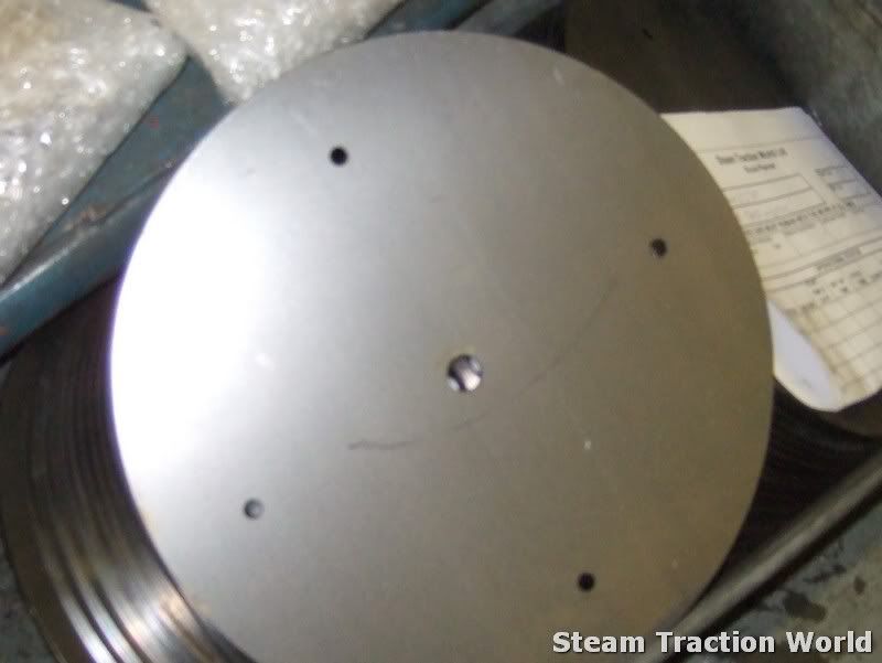

so what happened to delay things then ?? well basically the original laser cuts for the cylinder cladding was unexceptable so we had to make a few tweaks and re-order them. unfortunately this put us at the back of the Que at the laser cutters and this has held the kit up for the last week
we got the word that the new parts were ready on Wednesday and Steve went straight over to collect them

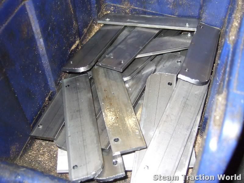

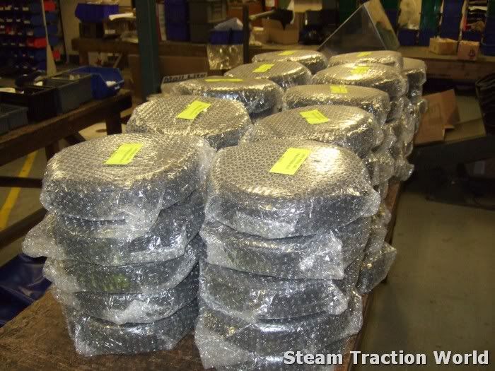

the rest of the parts have been sitting in the packing area for the last week. here's some more photos of what you can expect...

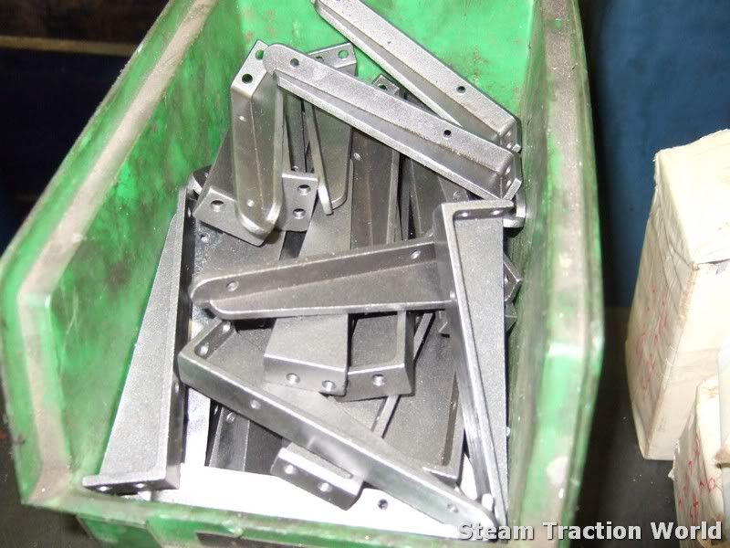

seat brackets during construction...
and seat tops...

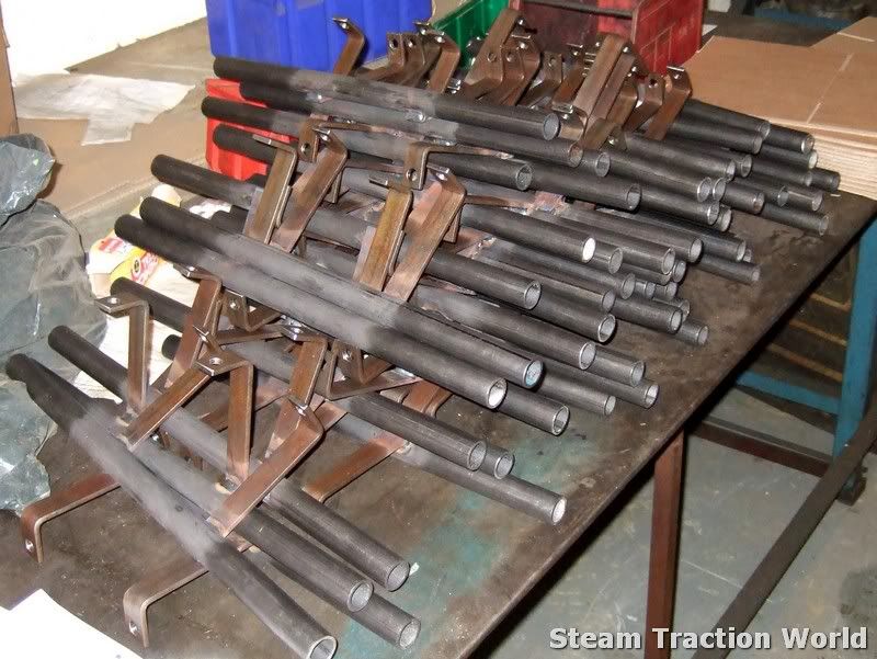

water lifter pipes...
chimney extensions...
walk-boards...
and some of the parts boxed up ready to go...

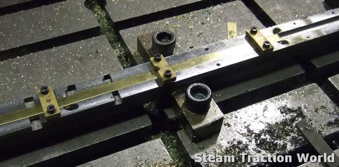

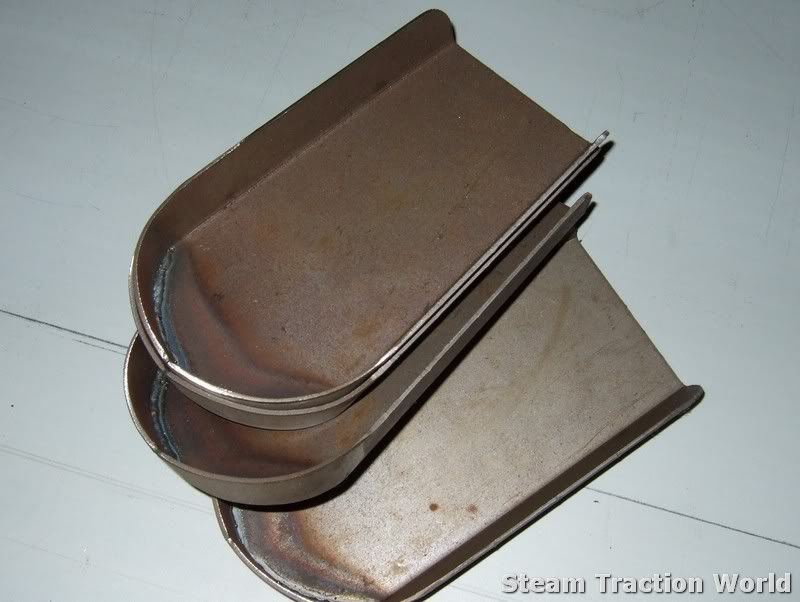

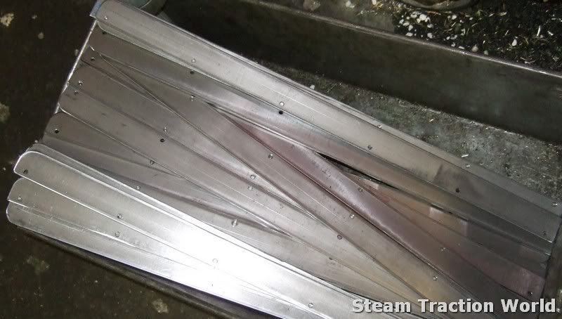

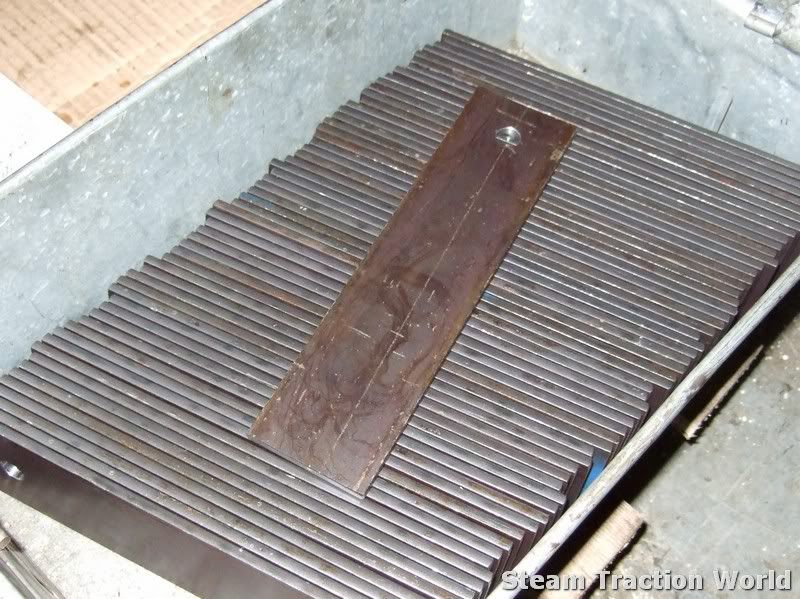

and the last parts to be made. as soon as the new cladding was formed we got the brass trim pieces done and the boxes were sealed
you can see the brass strips loaded in to the jig and clamped in place for machining, the jig is basically a big deep groove cut in a long steel bar, this allows us to stack the strips five high and get the work done a lot quicker...

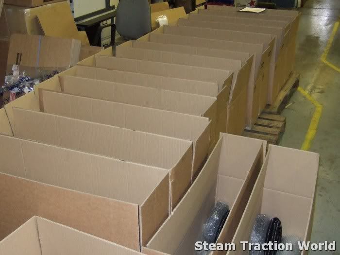

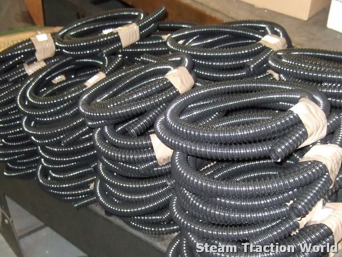

and seat tops...
walk-boards...

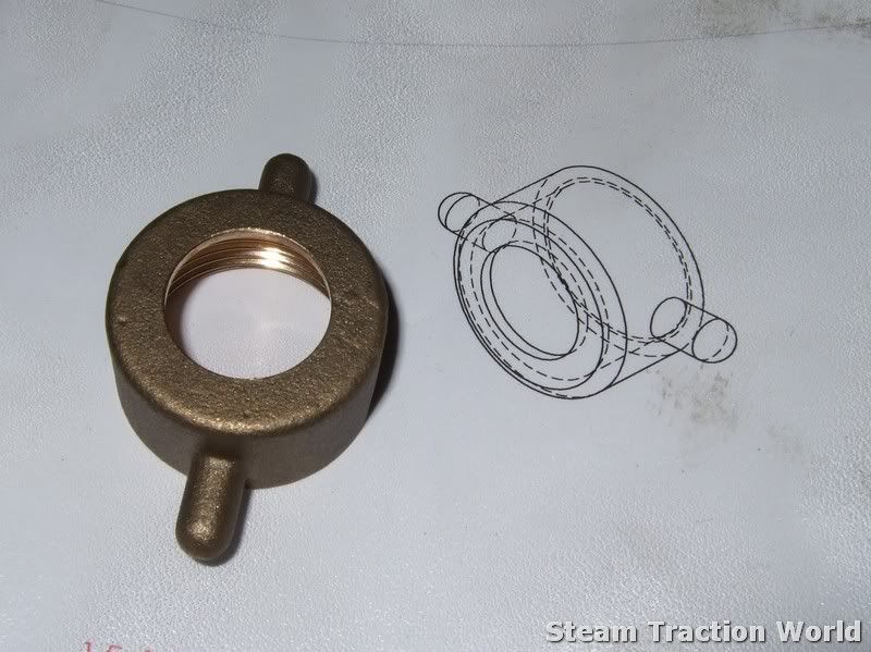

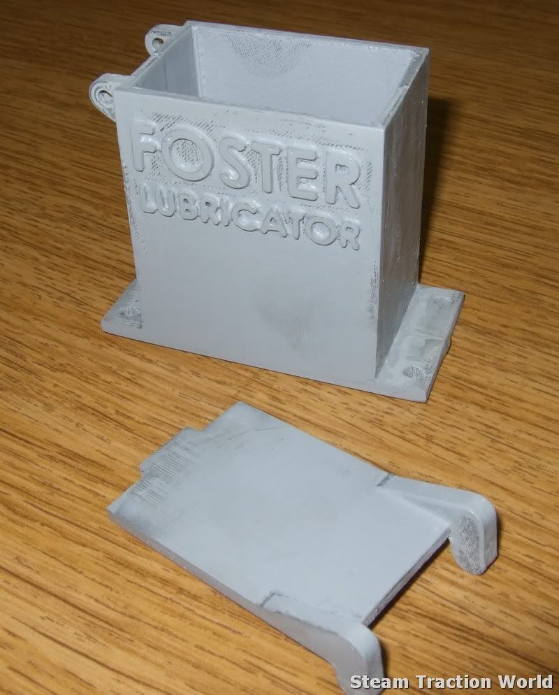

here's the pattern for the lubricator. hopefully you will agree that it's worth the wait.
Craig.
Craig.
