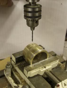

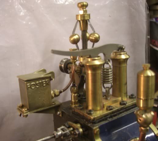

This is just to show how far I am now. I have done my lubcrater .This took some doing as First it did not work pluss I had no cut thred in my cylinder .pic Neutral HUM HUM
Then well all the time and done now LOOK Shocked I had to put on the fly wheel and yes lost the key for the 3 rd time so made another one

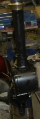

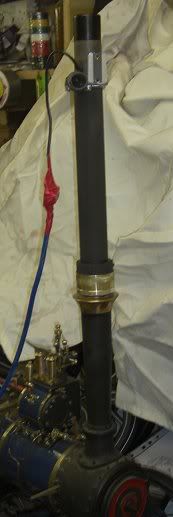

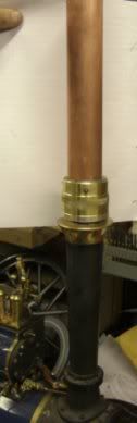

Then just a thort came to me as When I saw BUNGLE and Tonyt was told about taller smoke stacks .so here are the pics.Bits I have made.
The slot gose in on my rivets as I could not remove them ..A tril fit..Drilled togetherAnd bolt it upAnd WoW pluss the small hover it all looks ok to me after some paint ...............
But a thort is to me is HOW tall to make the new stack????can some one tell me.....
Good luck to one and all and Happy new year clown santa cherry sunny drunken affraid

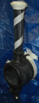

So here are some pics .First I tryed to paint it on by hand .All streaky and cr^p .
I also have been told that I can not do my engine in blue as none were made this colour Exclamation
Gess what I said to that Twisted Evil
So my smock stack is haveing a spiral on it this has lost me a frend but it is tough Very Happy

hi Hugh,
You wont need the extension if your using a fan (blower) this will be fine on the top of the chimney as it will suck air through the tubes drawing the fire.. you will need and extension if you not using a fan to increase the draft up the chimney and through the tubes.... once you have about ten psi on the gauge then the fan can be removed and the blower opened this will draw the fire allot better than the fan and you'll be up to steam in no time.. takes about 15-20 mins to get my lilla up to pressure and as we have copper boilers you dont have to worry about warming them up slowly. if it were a steal boiler with copper tubes then you would need to warm it up nice and slow so they dont start leaking.... not a good thing to do on a full size loco.. you tend to be shouted at! it can take from 1 in the morning or even earlier to get a cold coal fired loco warmed up and up to pressure ready for a 9 o clock train depending on it's size of boiler... if the loco was in service the day before then it's allot less time as there still hot the next day....
I want to see your chimney swirl....
And you might find a small extension is needed to stop the sinders from being blown straight into your face when driver the engine.. a curved piece of pipe can be used to blow them out to the side. it's not nice getting a red hot sinder in your eye... esp when the loco is working hard it will suck the fire through the tubes and out the chimney into your face...

Thanks for the INFO .I did not know that about the locos i thort it was all ready the night before and just lite it and go .HO that must be a bummer Twisted Evil If you are late .
By the way the chimney swirl was a joke .My mate is only now seeing the funny side of it .LOL
As for sinder in eyes that will be like my bonfiers Very Happy Not seen a curved pipe ??? I will hve to look in to this.

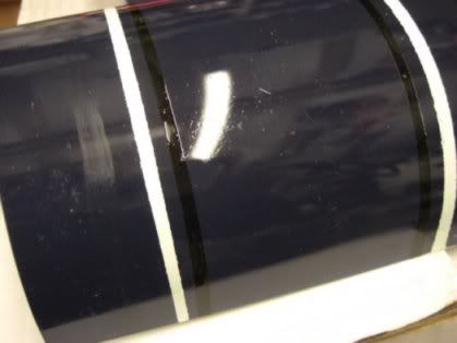

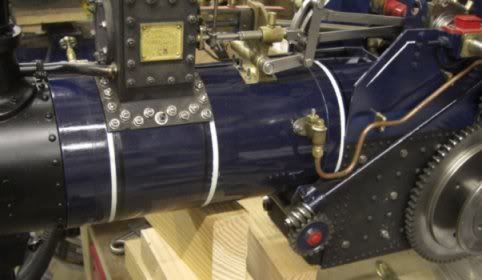

OK OK How can I respond to this ouch thet hurts and from there.
Ok guys here the pics
And when they were on the engine .
As you can see the lines are not in the right place.
The other line was going to be a light gray but I do not like it .
Hugh
