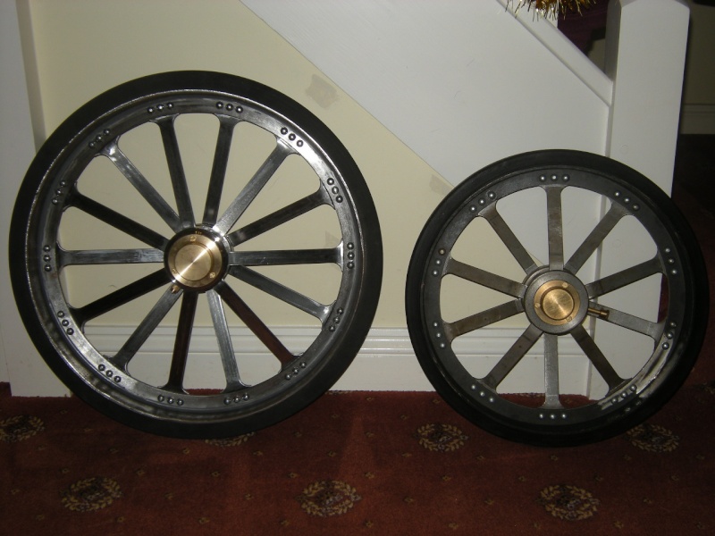

Post  Steve Traill on Sat 12 Dec 2009, 6:11 pm
Just so you can see the difference in size from a standard 4" Burrell front wheel and the DCC front wheel here's one I had lying about! As for getting the kit before everyone else I am chief guinea pig/test pilot for the kits so as to keep quality control to a high standard and save everyone else a lot of phone calls! (hopefully) I will be doing write ups of my trials and tribulations as I go, so hope it all helps.

Post  highpressure on Sat 12 Dec 2009, 6:14 pm
HOLY S**T!!!!! affraid affraid That wheel is enormous!!!!!!!!!!!!! This is gonna be one big engine when its finished!! How long do we have to wait for all the kits!!!!!!! lol! lol!
