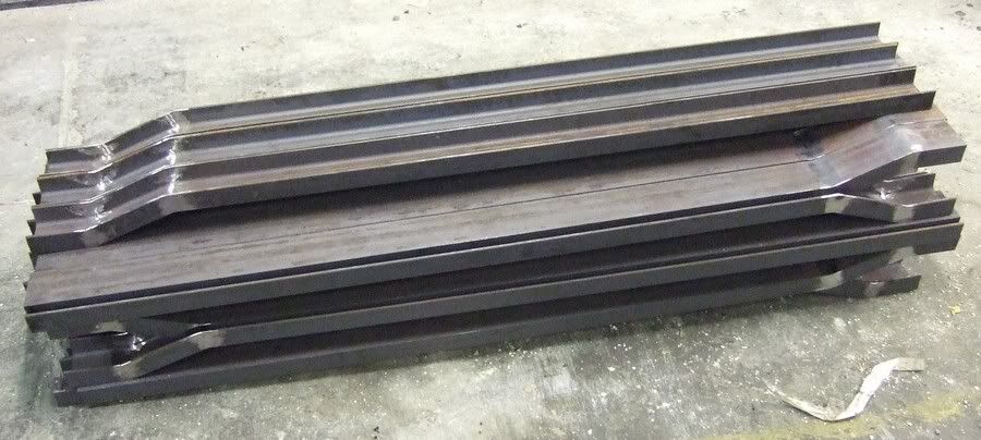

yes we have started work on the Foden chassis kits.

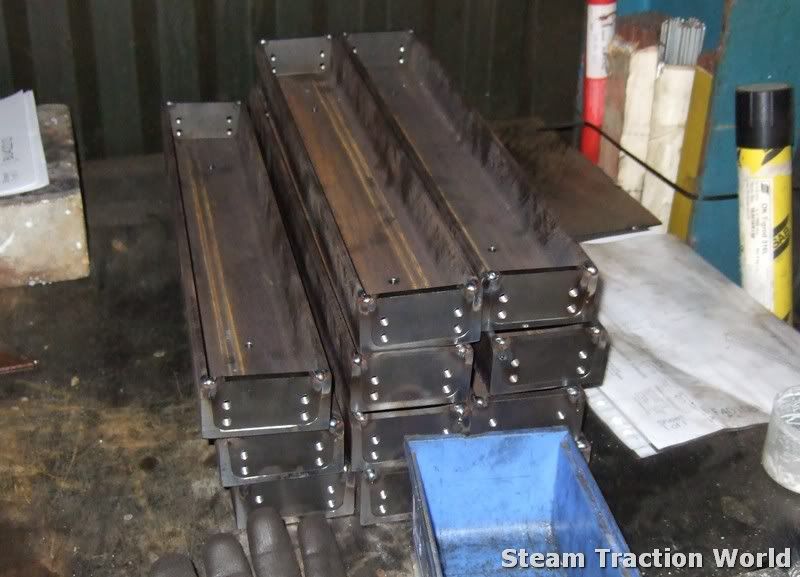

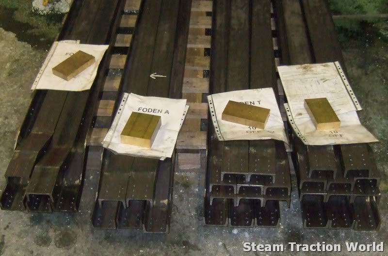

the main chassis frames have been welded and the cross members have been machined. some parts are actually available from old model-works stock so we just have to make up the numbers on them.
the rest of the material is due in next week.
main frames ready for machining...

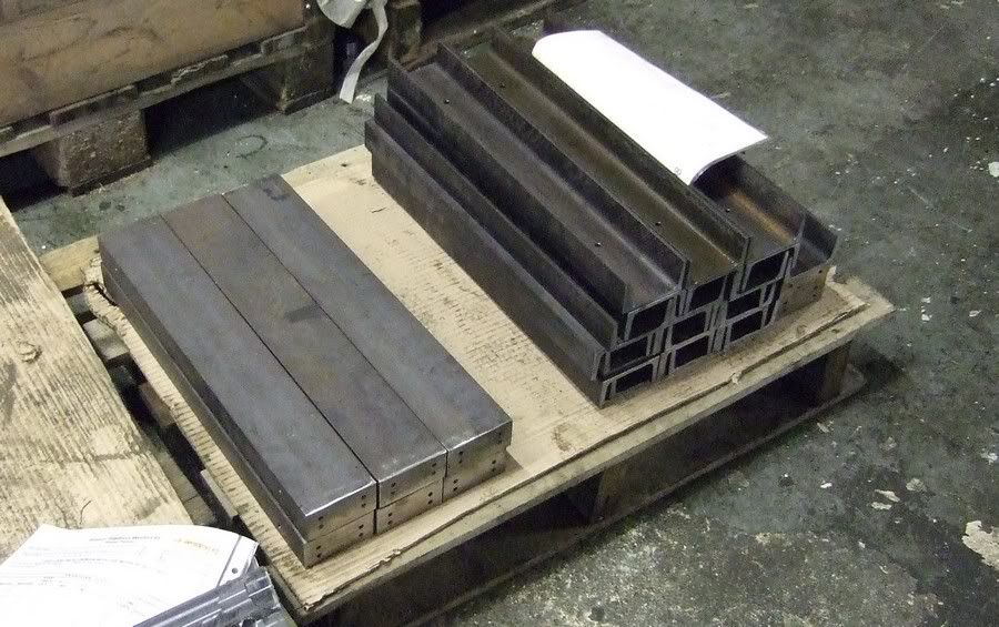

cross members (including a few old stock)...

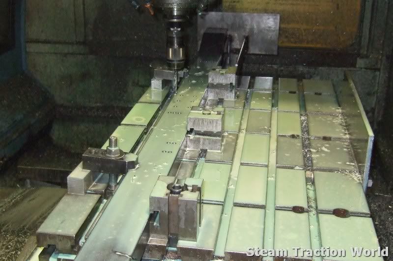

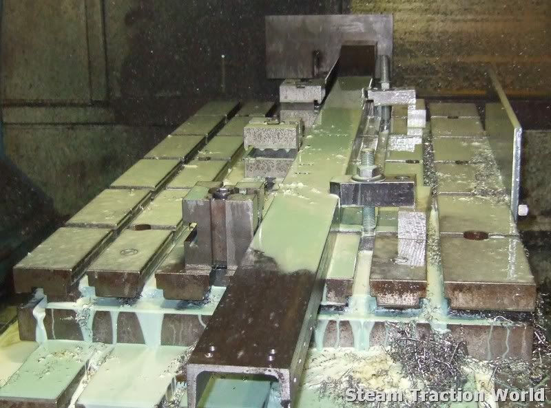

main chassis frames. thankfully not that many to do, five artics and ten (11) SWB.
due to the size of these and the limited travel on the CNC machine they are having to be drilled a section at a time. this means each one has to have nine separate drilling operations
cross members being welded...

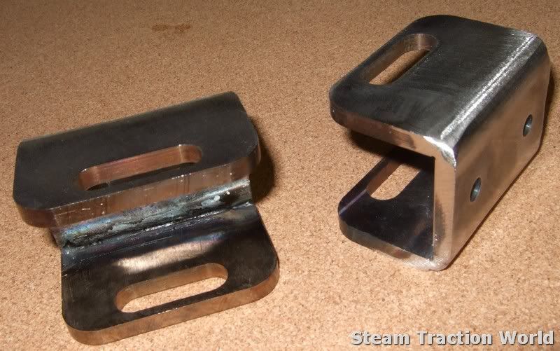

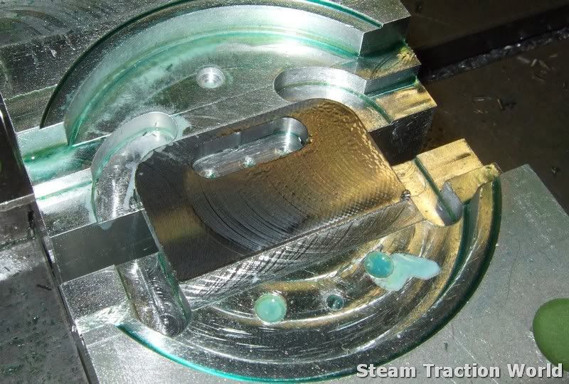

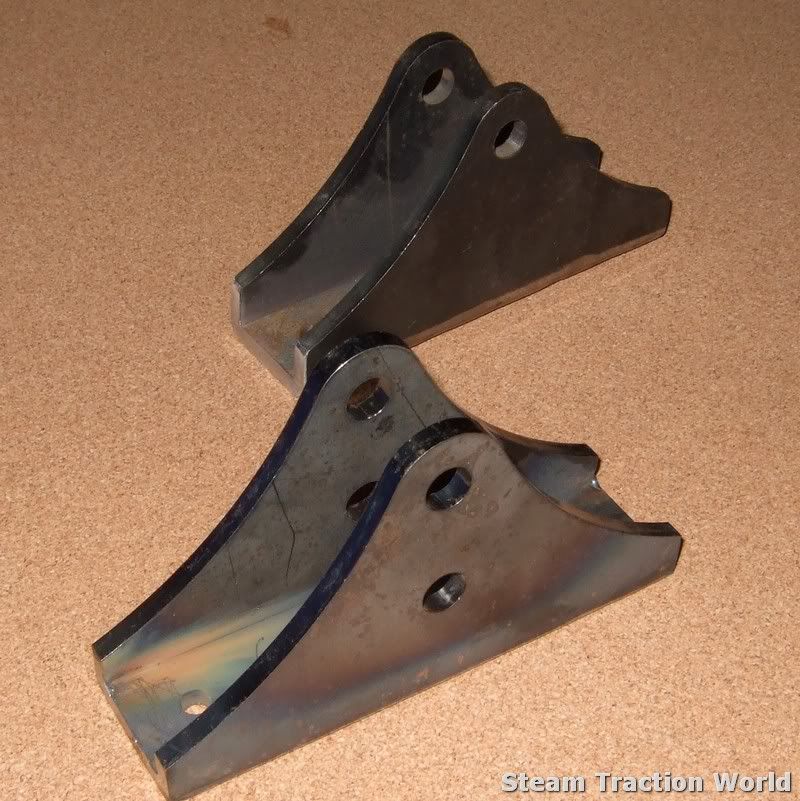

slipper brackets machined out of bar...
and welded together...
and the "other" bracket (called the "other" bracket because i've forgotten it's real title
). two types for the two different styles/options...

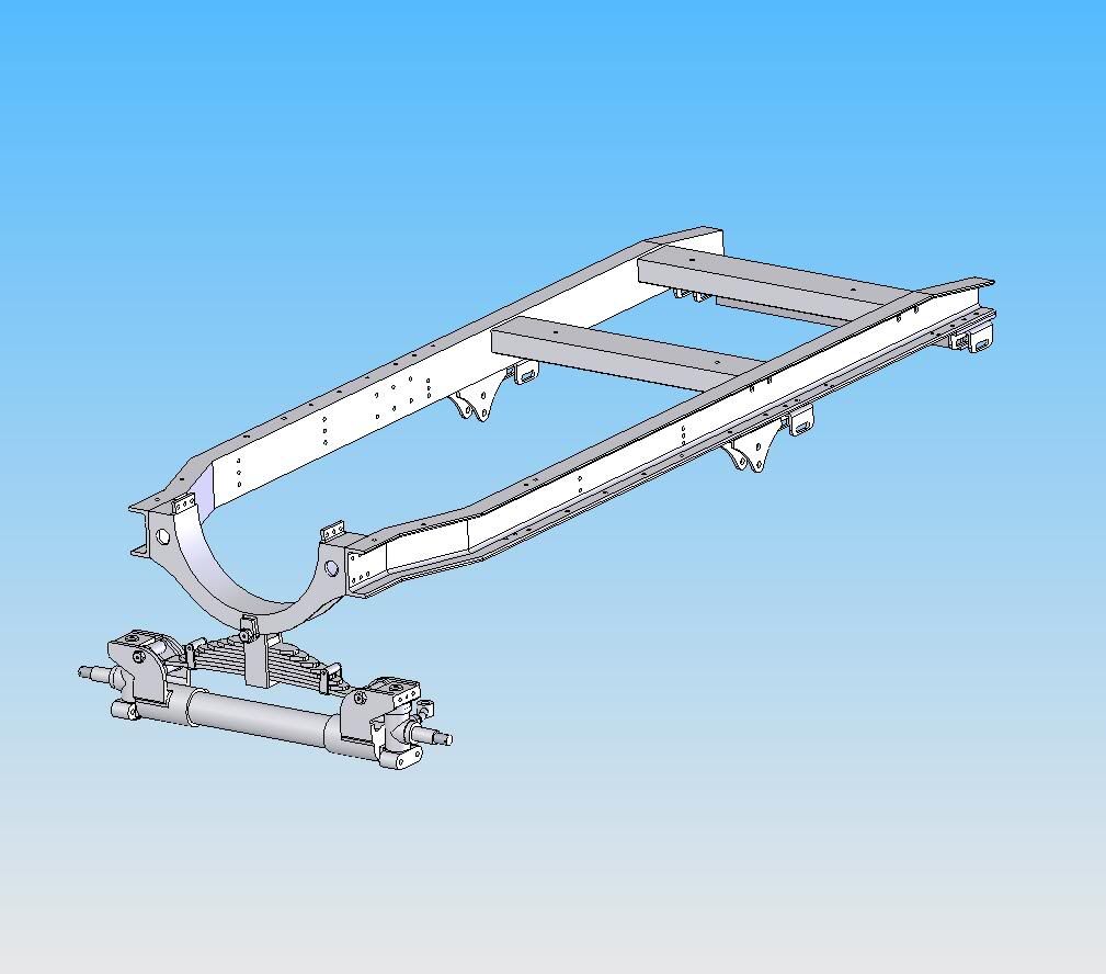

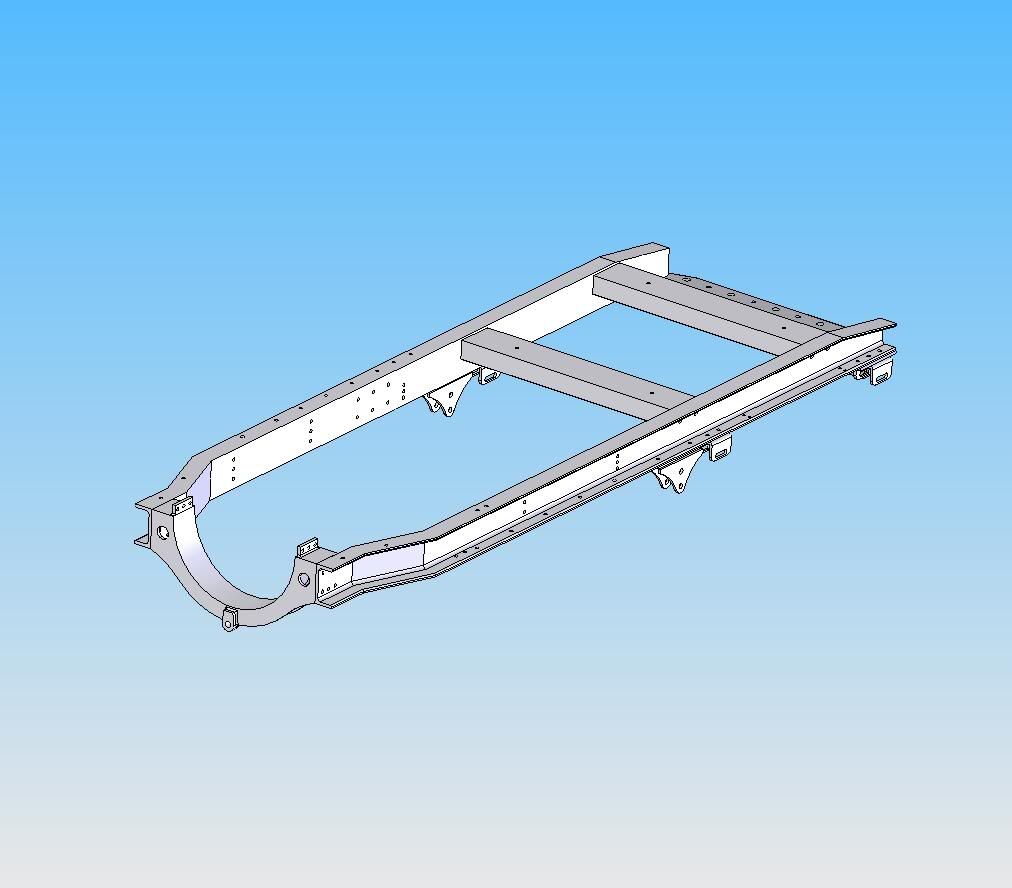

Foden Parts List

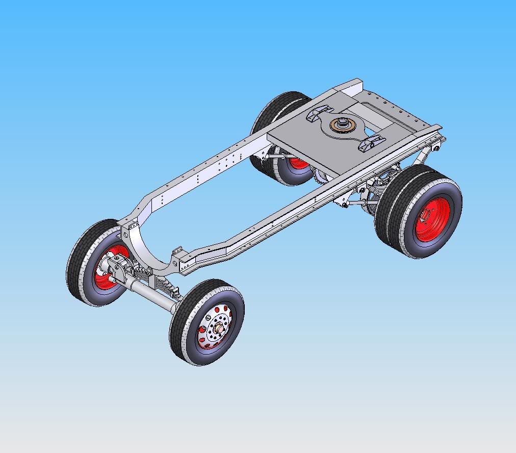

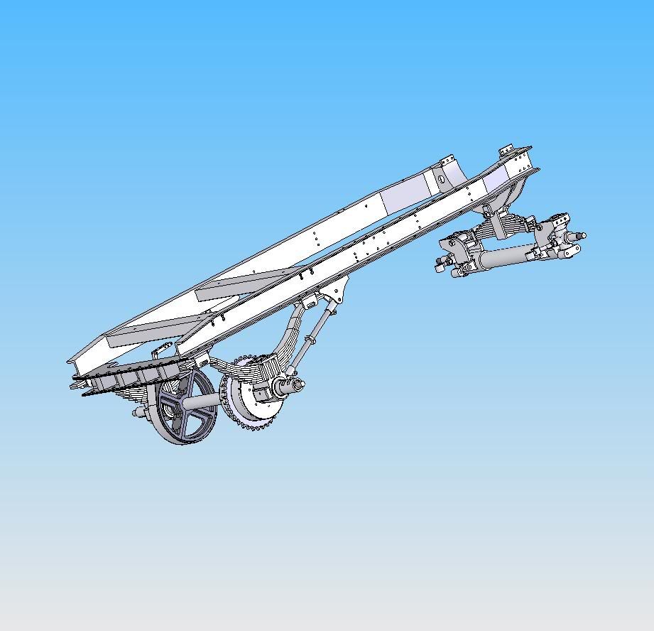

As I mentioned in the forum under Foden SWB/Artic, using the autocad drawings is a very good start to see what is in ieach kit - at least it should be similar for the early kits. I have copied parts lists and drawings for the first 6 kits so I should know what to expect when the "postie" arrives. I have attached a drawing of how kits 1-6 should look, although hopefully the SWB will be a bit shorter.
url=http://www.servimg.com/image_preview.php?i=4&u=14541526]
[/url]
Tom A
[/url]Regards
Tom A

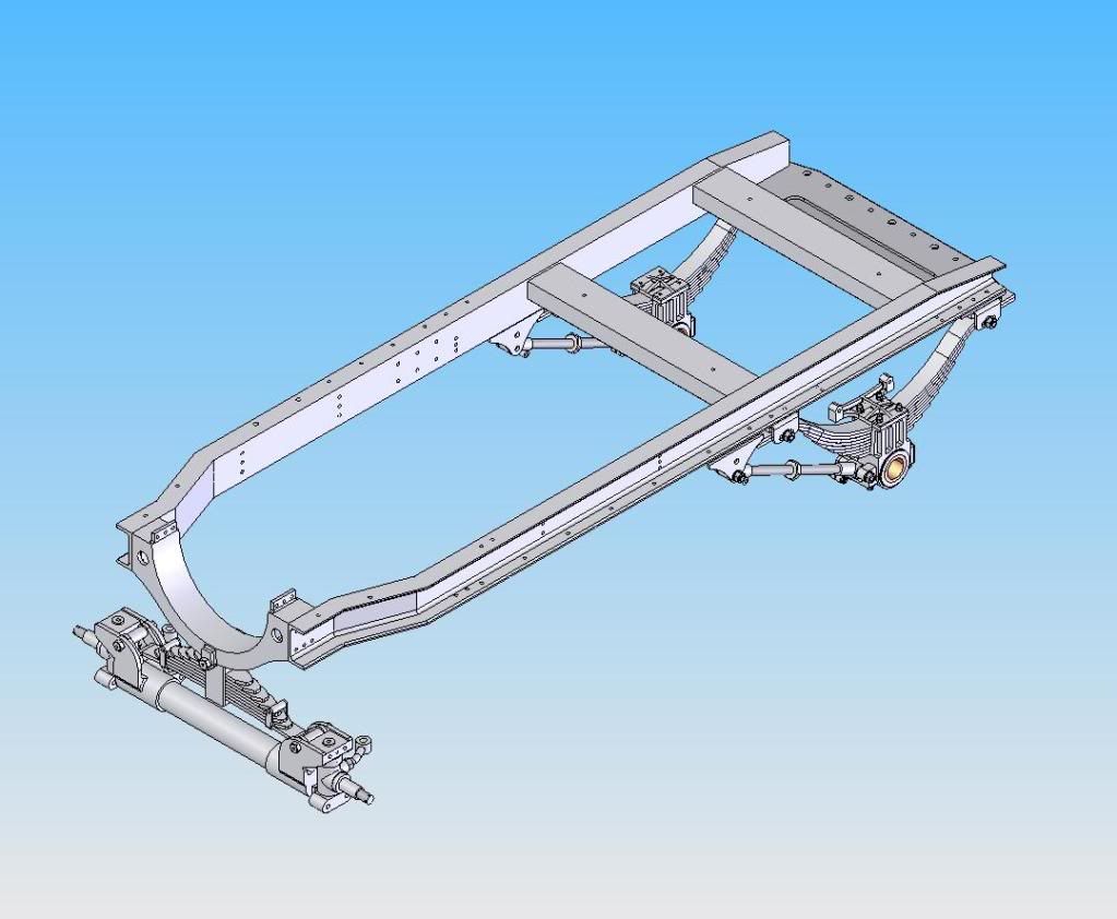

i managed to pull these jpegs off the system....
kit 1...
kit 2...
kit 3...
kit 5...
kit 6...
