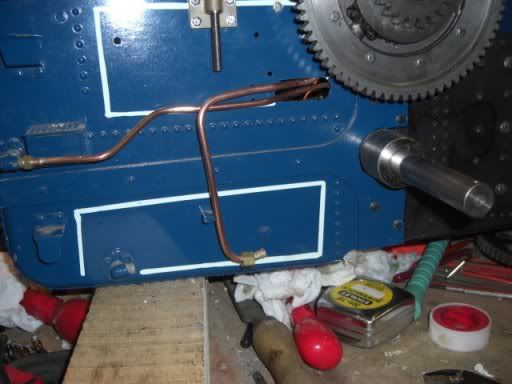

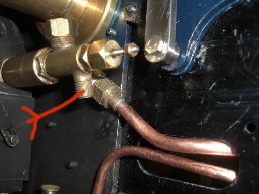

I do not know if this is helping some of you .but here is what I heve done ,not a lot for a saterday,
Ok the pipe that I took all the time to do had to come out ?? Mad as the space were the joint is so small none of my spanners will fit
I did try taking off my water gauge but that will not work. As it hits the pipe so by pushing the pipe down and
out of the way so that I can fit to next one and pulling it all up . I have done it . I griped it with a pair of plyers .it took a long time but just keep going. I used some string to thred it through.
Also the pips in the write up show the two pipes on the side to be the outher way up to mine as they would not fit.
This dose not look as good as the drawings I think. Question Exclamation
Ho yes is there to be a fitting under the water gauge here as I do not seem to have one .I was thinking some rubber tube to get the water down .I under stand it is for letting out bubbles to see were the water is in the boiler.This may not be right.
Well I hope that this may help some .Just rember that I am do mine but someone else is do it right cyclops

I've informed STW that were still missing the clack valve handles and the blow down pipe for water gauge.. I believe these will be sent out in the next package with the stearing chains etc.
rubber hose would do the job but a nice copper pipe will look nicer..
