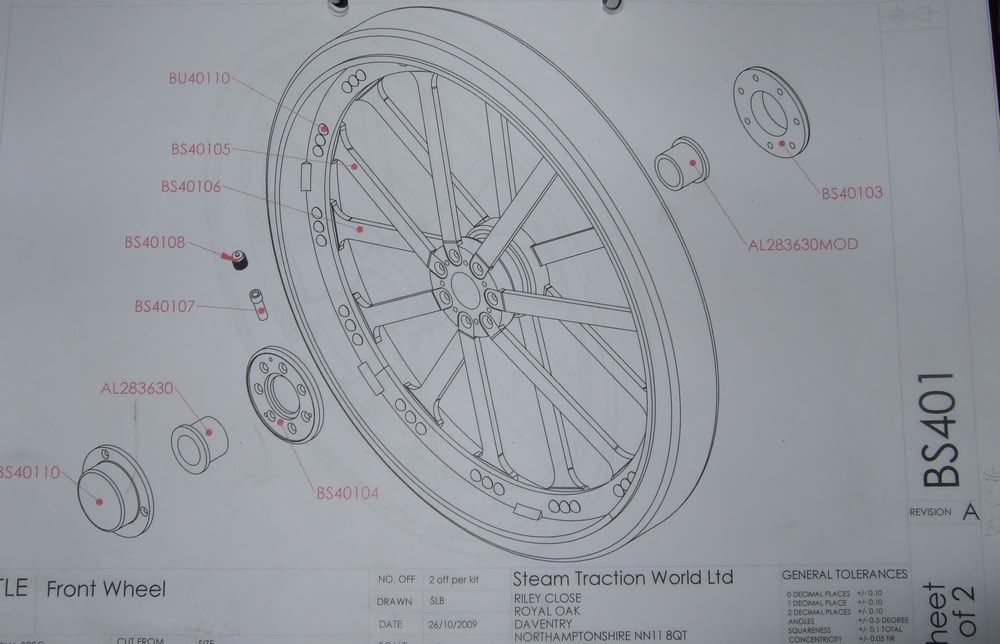

your kit 1 will contain two front wheel Assemblies....

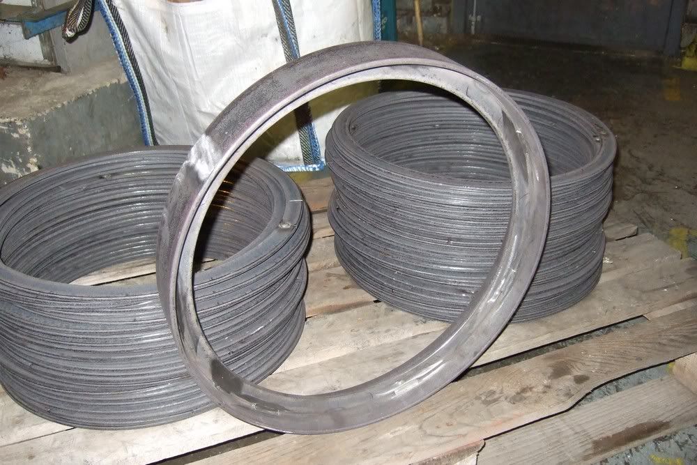

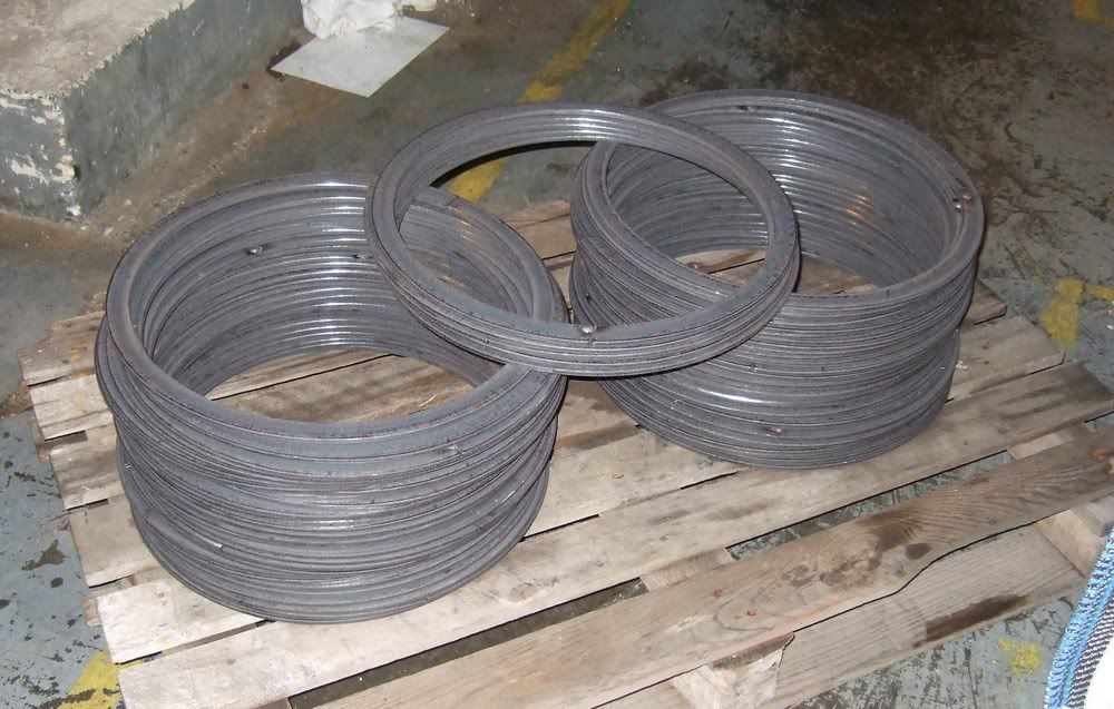

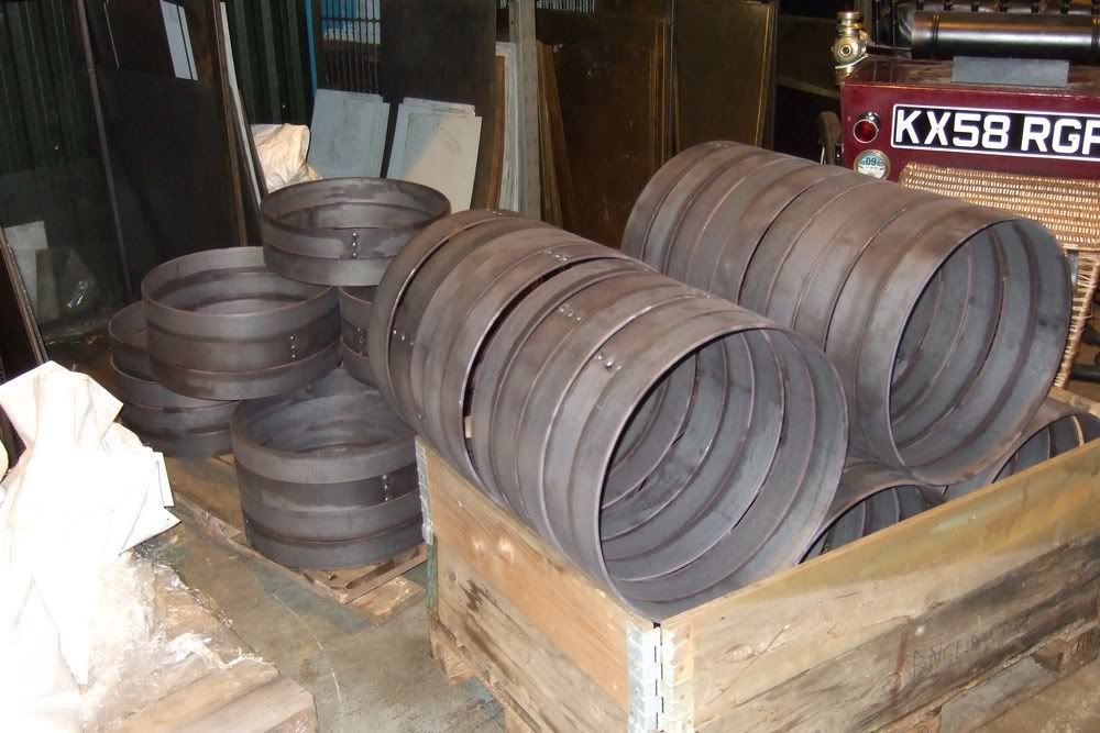

the wheel rims arrived at the factory on Thursday....
along with the inner section....
welding was started straight away as we need to get these out for Vulcanising as soon as possible, we also need to get the rims and main hubs made as soon as possible so we can make sure the spokes are bent correctly...

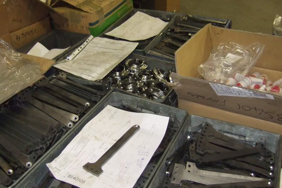

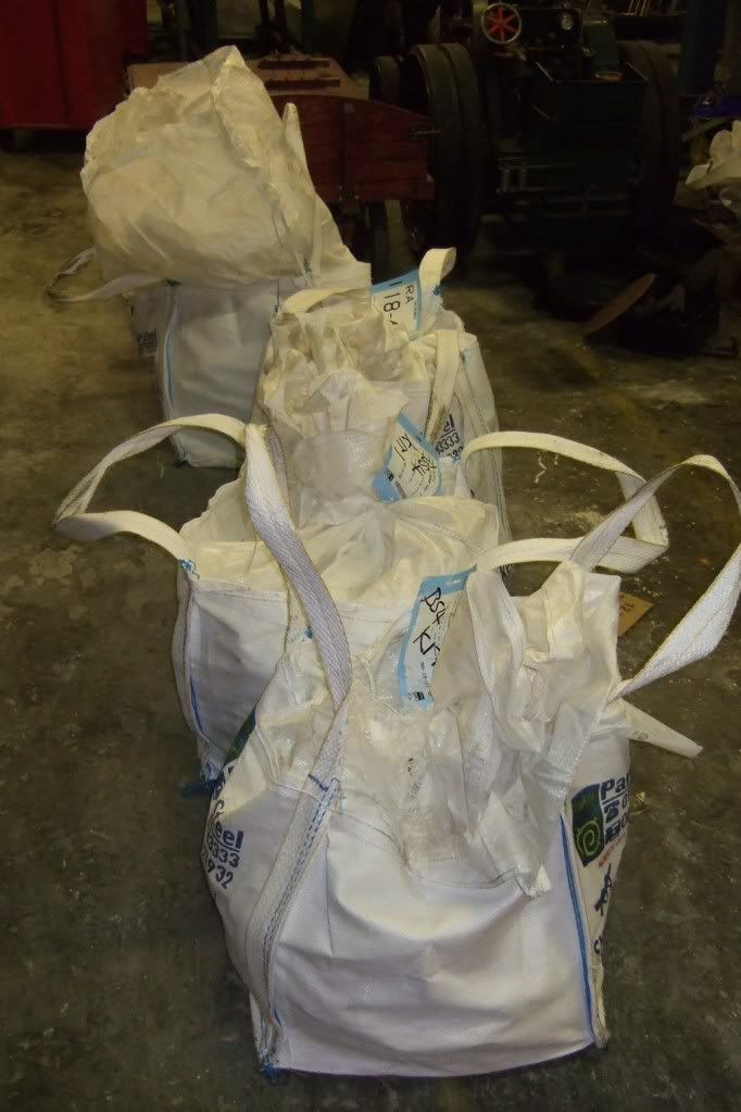

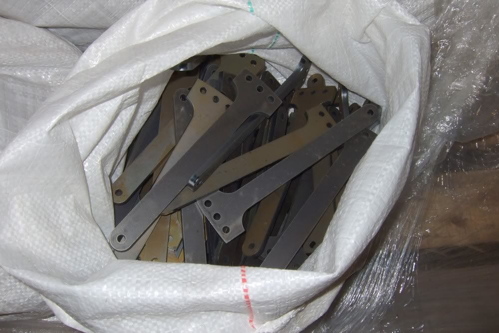

and in these bags....
are the spokes, loads of them Shocked they are already laser cut to shape but we need to get them bent. due to the huge numbers involved we need to push on with this and it's now the main priority in the factory Cool

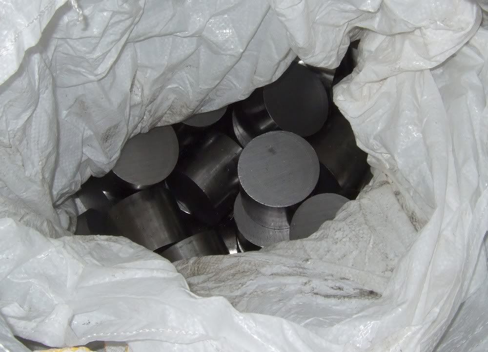

more bags of material....
we now have everything in stock and the CNC lathes will soon be working flat out to get things done, with only relatively minor work needed on the milling section.

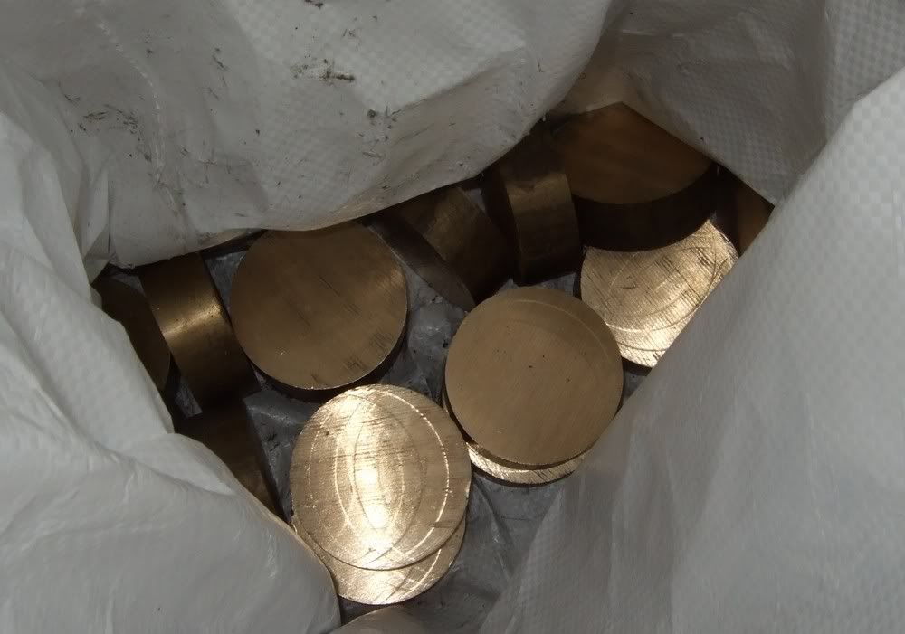

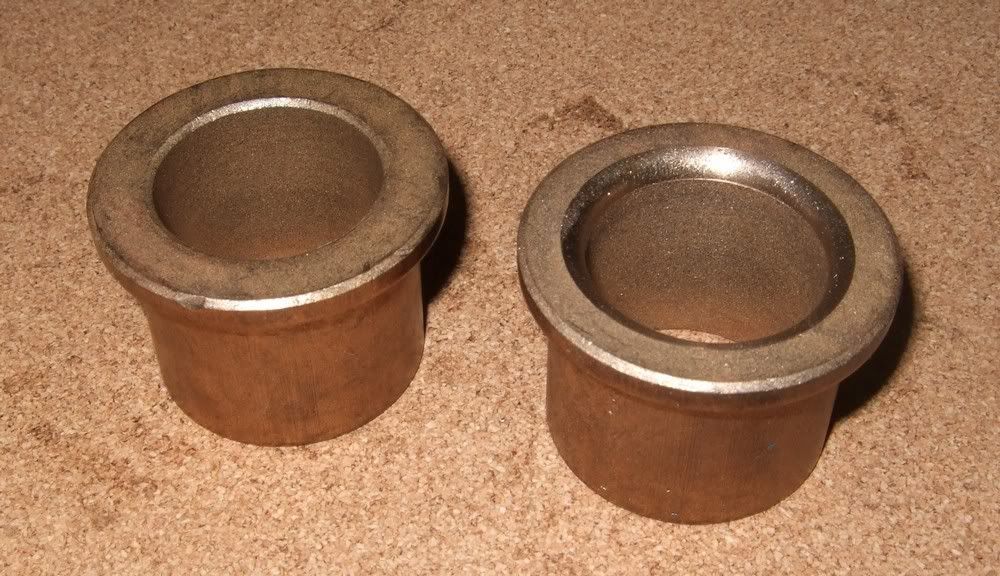

one part that's already done are the bronze bushes. There are two for each wheel and the inner one has been modified with the addition of a radius. I'm guessing this will allow for clearance on the Axel....

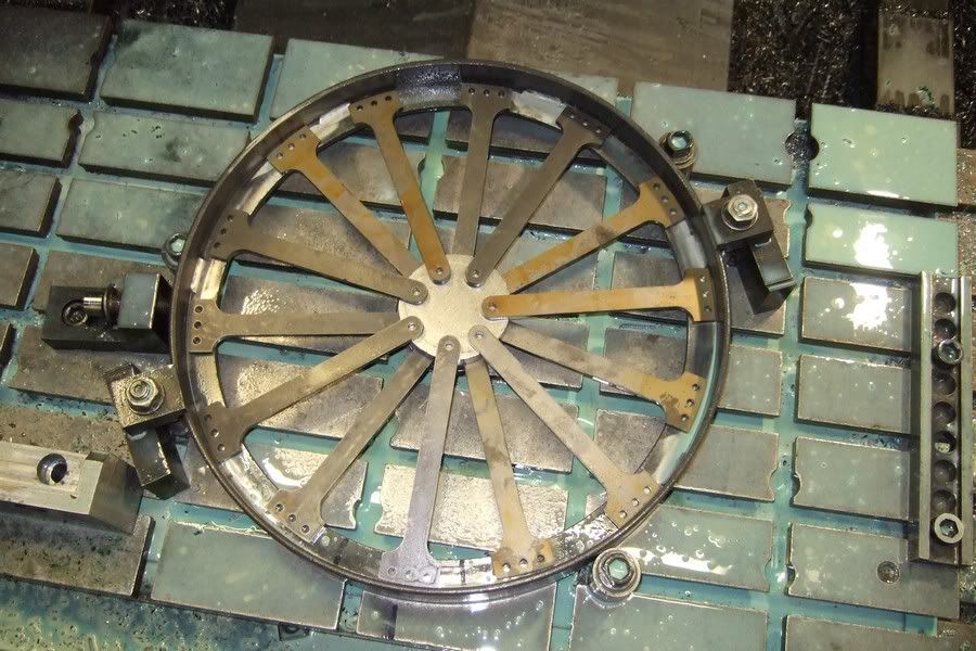

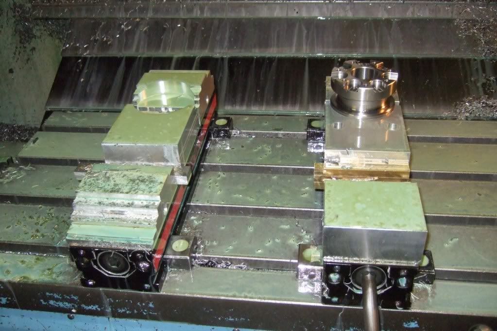

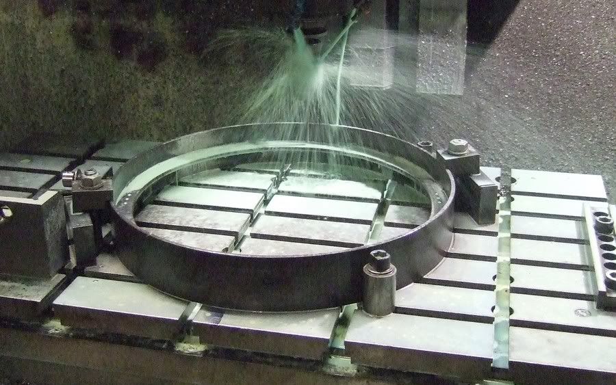

wheel rim on the CNC for drilling...
MMM, if only things were this easy Rolling Eyes

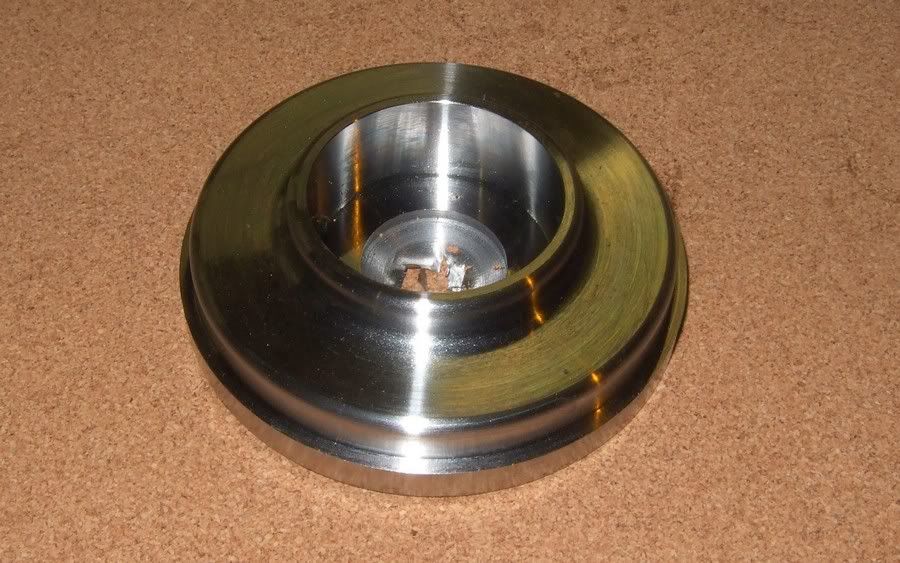

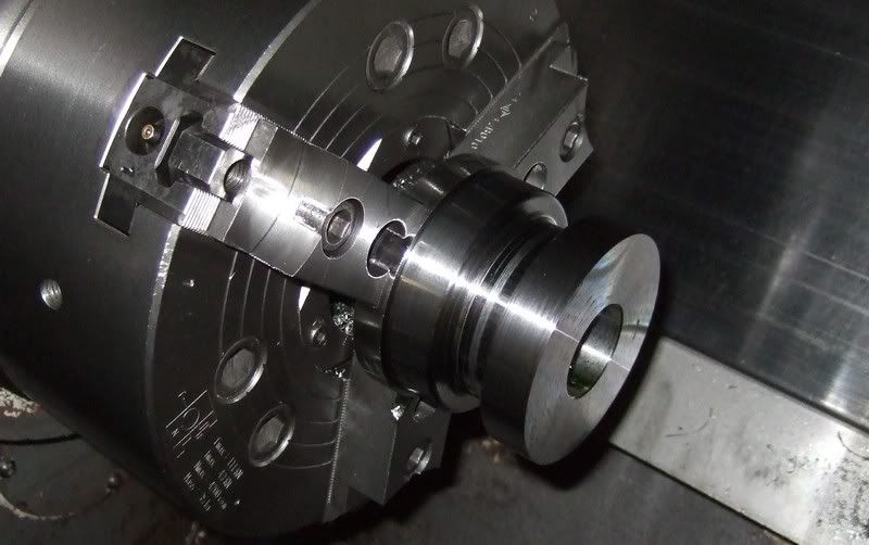

1st operation of the front hub inner cover on the lathes...

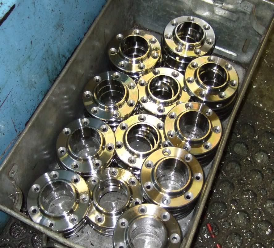

the main hubs are now on the lathe cheers
they just need the excess material turning off and then we can start milling the slots for the spokes

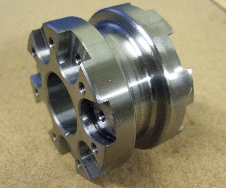

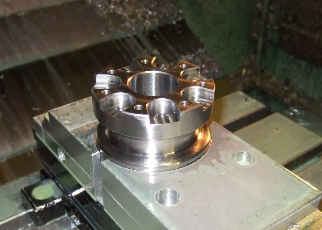

the hubs are now on their final turning operation so i can start milling them. Steve has made it absolutely clear that we make sure the rims, hubs and spokes fit perfectly before we carry on with any work so the main objective was to get one hub and a set of spokes done to test things out Cool
(please note, the hub and inner hub cover seen in these photos are rejects from the turning operations due to the billets not cleaning up. slight saw marks can be seen on the faces of these and they are only being used to prove out the milling ops Rolling Eyes )

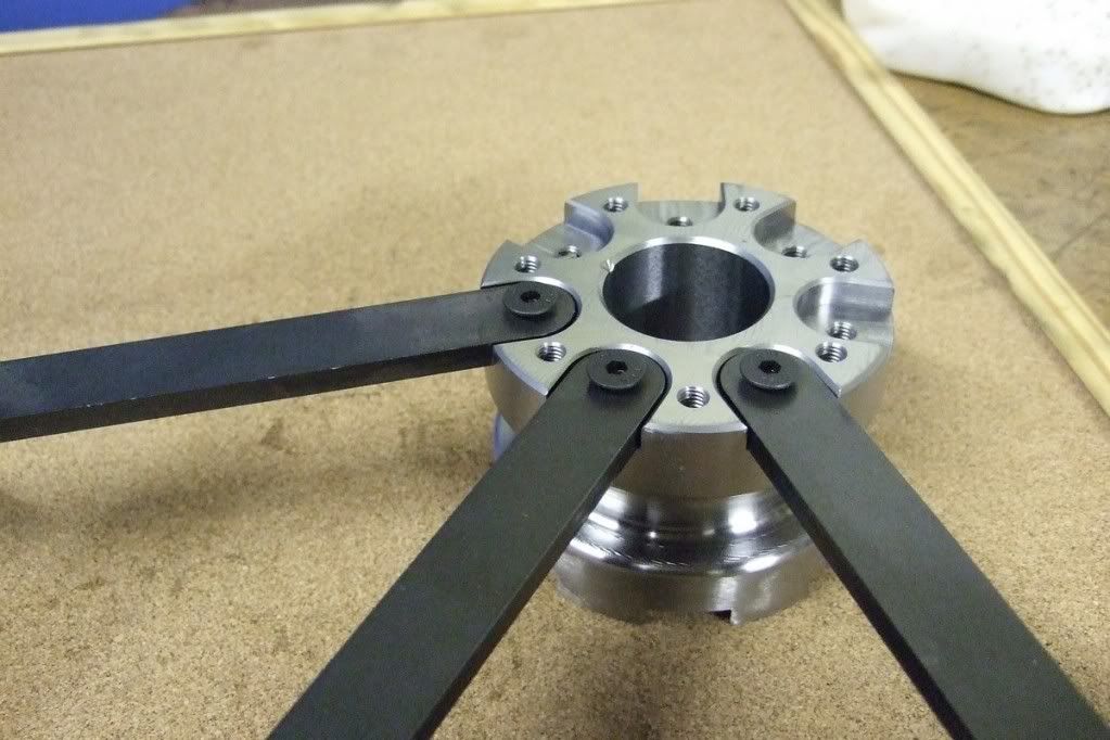

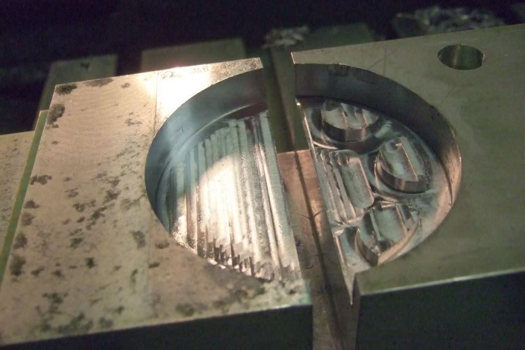

so here is the first hub, with the spoke slots milled in both ends....
and yes, the spokes fit. although these ones have not been countersunk...
once up and running the hubs will be milled in one operation. one end in one vice, and the second end in the other vice...
but it's very important that the spoke slots at each end are correctly orientated to one another, otherwise the whole thing just won't fit. How do we do this ????
well the pocket in the second vice has lugs machined at the bottom and these fit perfectly into the spoke slots in the first end and orientate everything....
a lot of time was taken to ensure these pockets are a perfect fit...

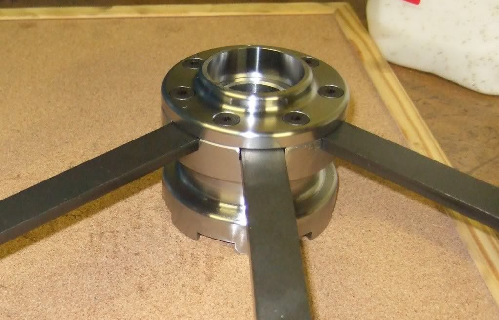

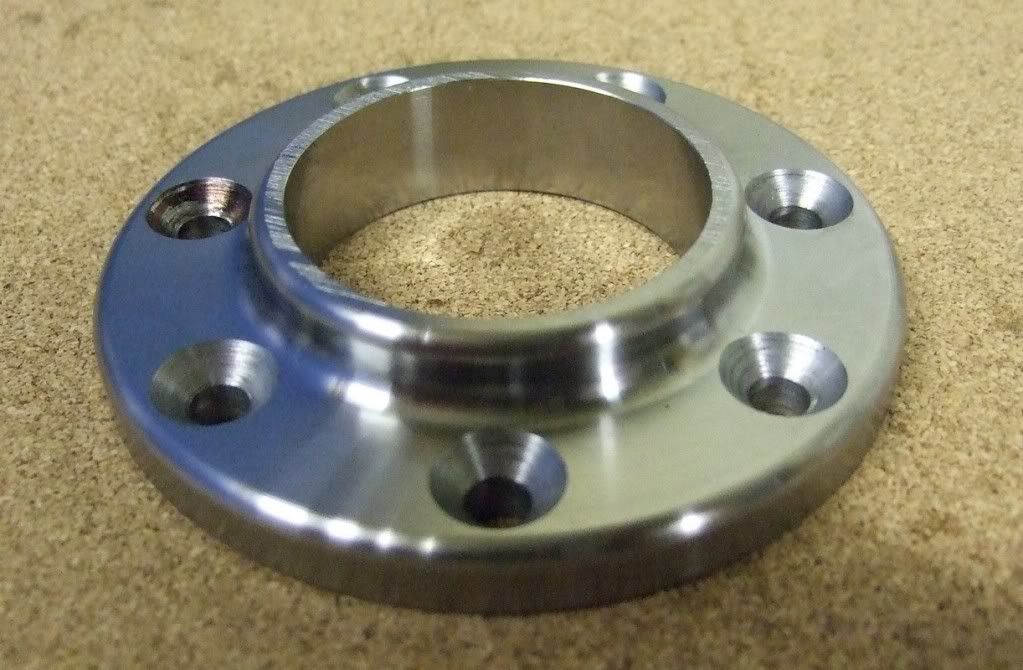

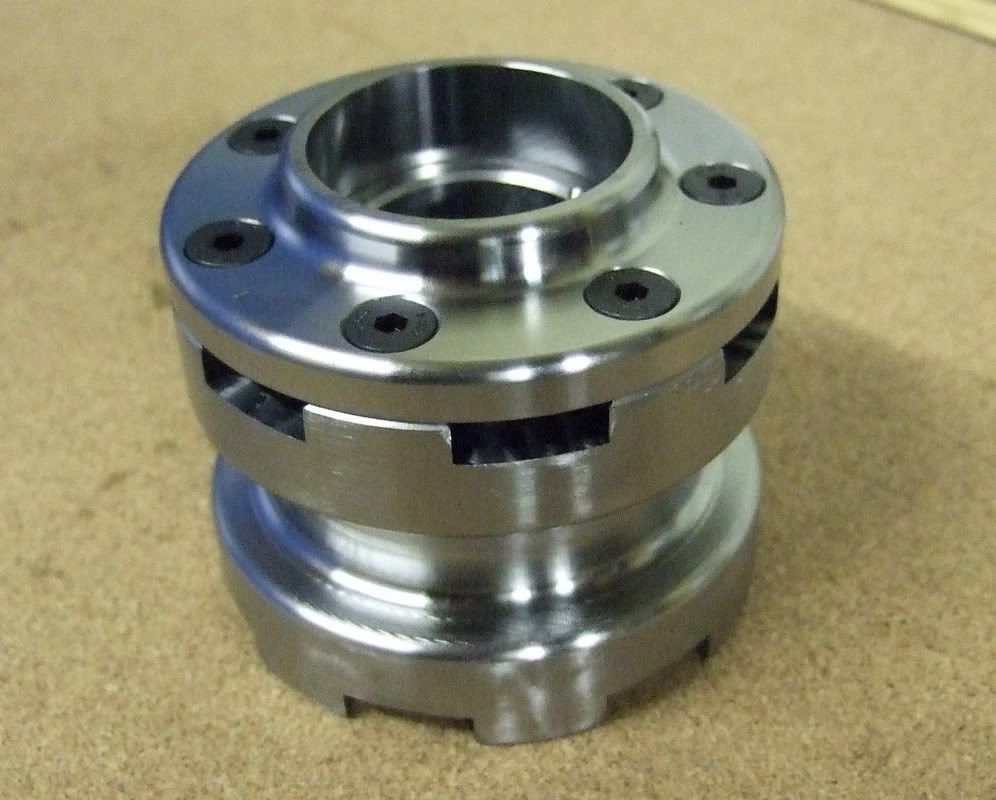

and now that we have a hub done we can drill the holes in the inner hub cover....
which fits perfectly on the hub...
so the rest of the batch could be done...

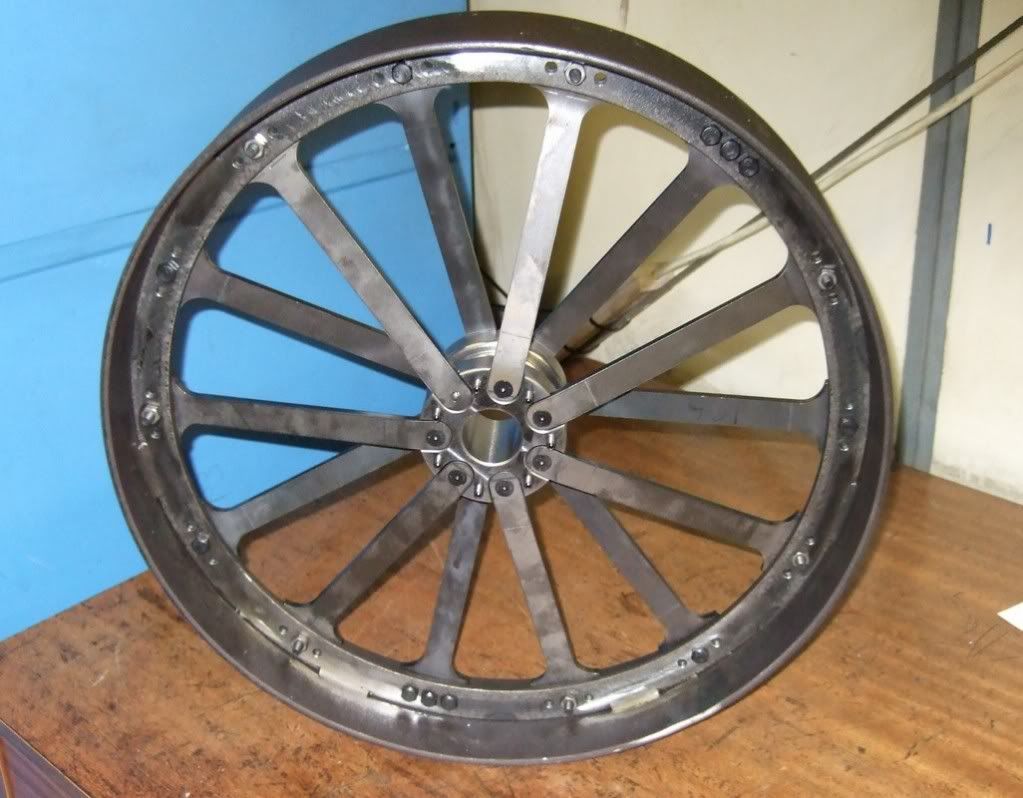

so now that we have the rims and a hub, Ian was sent off to bend up a set of spokes Shocked
and does it all fit ??? of course it does, perfect fit first time...
this pic was taken just before we left tonight (Friday), so it's back to work first thing Monday to get on with the rest of the hubs.

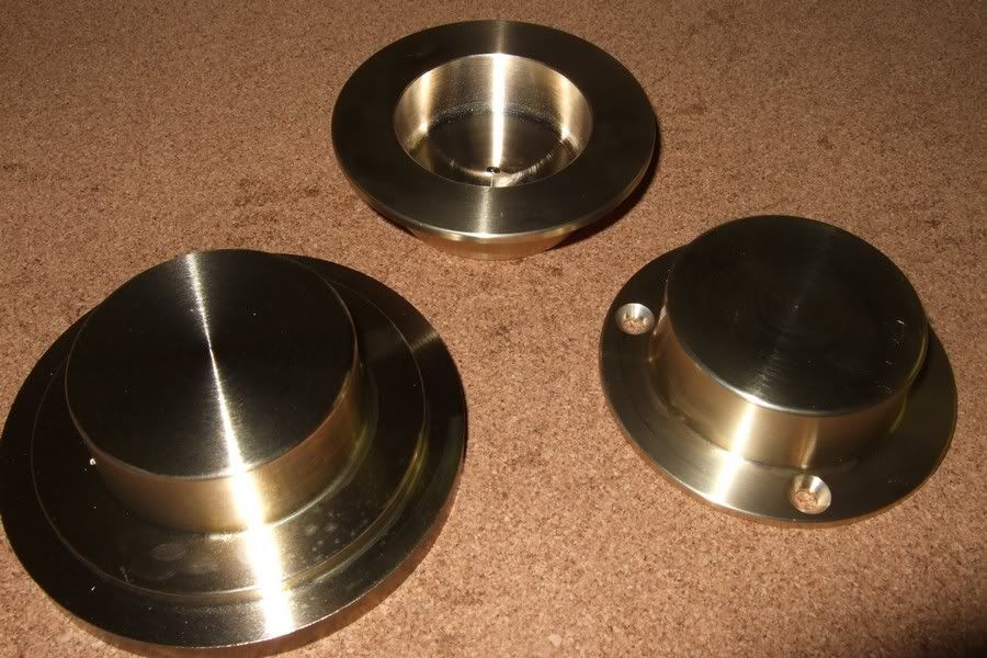

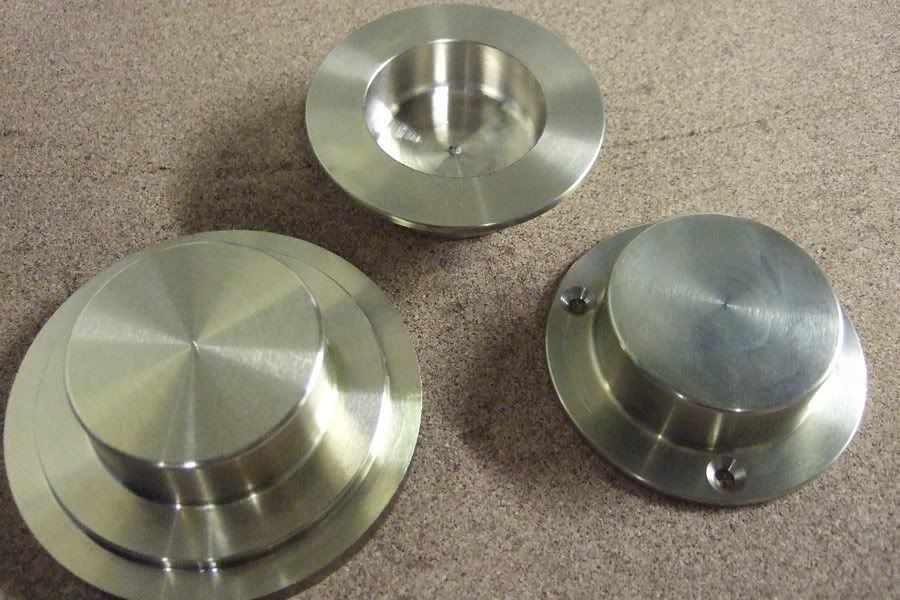

the outer hub covers are now being turned...
the three stages of hub-cap production...

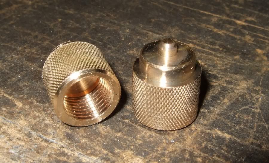

One question, Are the hub caps steel? and shouldnt they be brass if so? One less thing to polish I suppose but I was rather hoping they would be brass.
Re: DCC kit 1 !!!!! WORK HAS NOW STARTED
Post  miller on Fri 04 Dec 2009, 6:31 pm
yes, the hub-caps are brass.
the camera was set to macro setting with no flash as it brings out more detail, but it does tend to dull down the colours a bit
here's the same shot with flash, nice brass Laughing

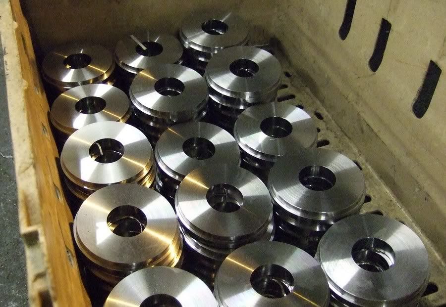

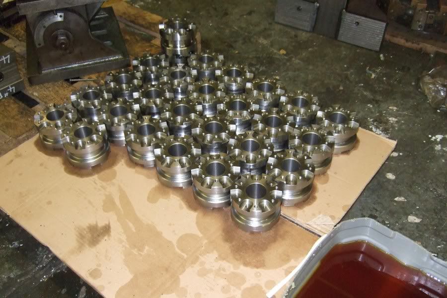

the bar-feed lathe is working flat out to produce 1000's of half-nuts and it just a matter of loading the rest of the stuff and getting it done.
