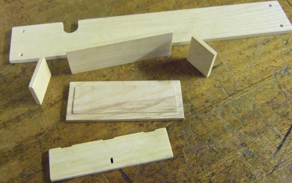

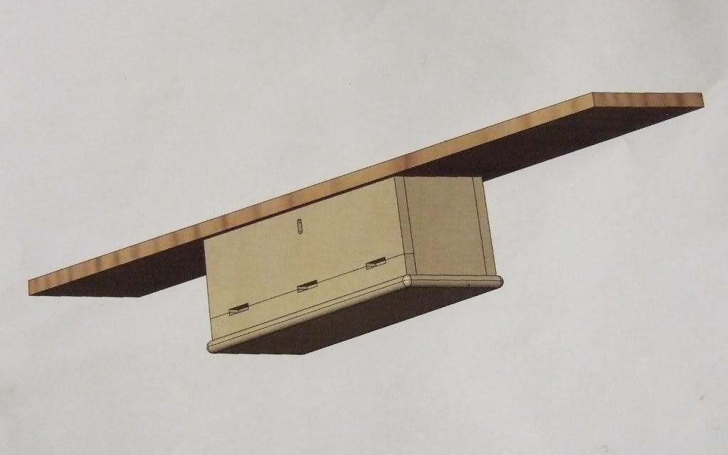

the whole sub-assembly is quite a little jig-saw puzzle, with a good few bits making up the box...

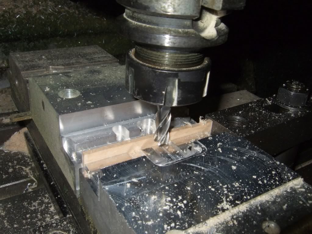

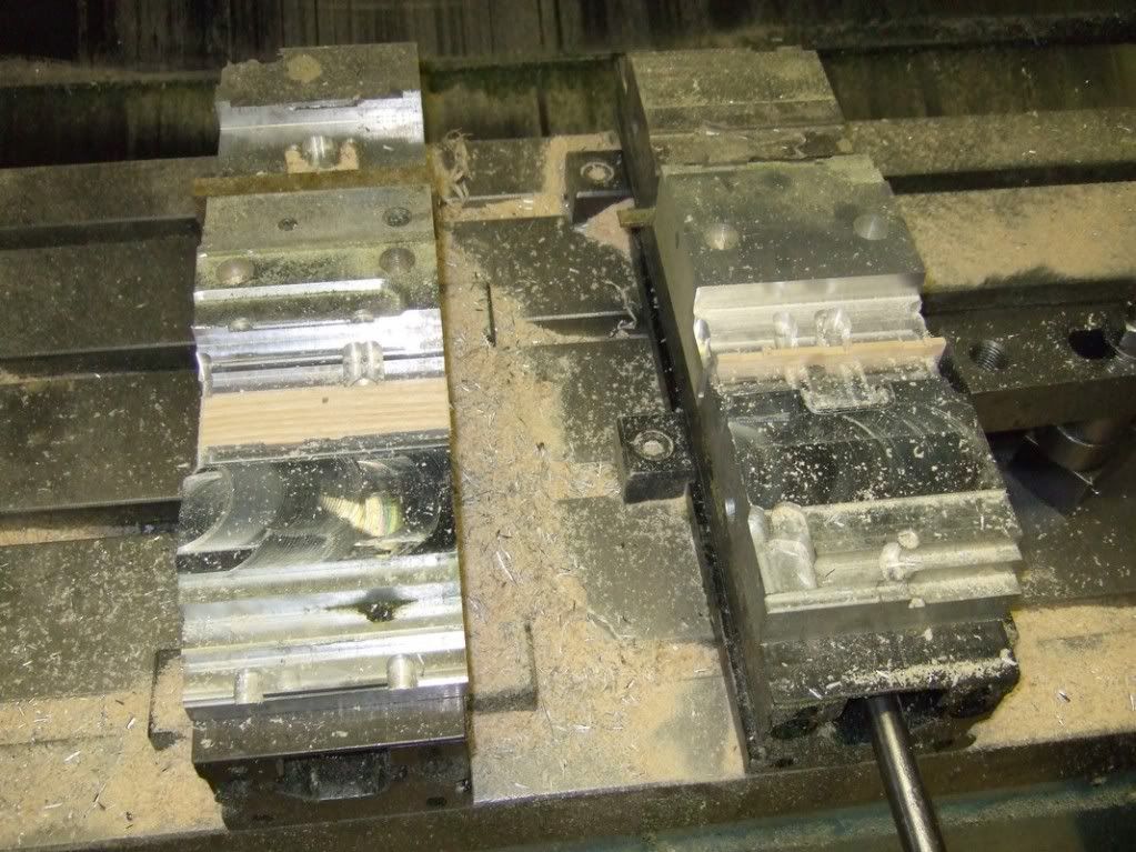

heres the front/door section on the machine. the wood is cut to size and the 2mm slot is milled in the left hand vice, and then the cut outs for the hinges are cut in the right hand vice....

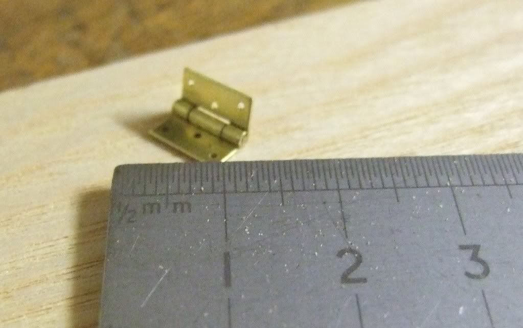

oh, and those hinges are really small, so for those of you that are finding the governor fiddly.... sorry Rolling Eyes

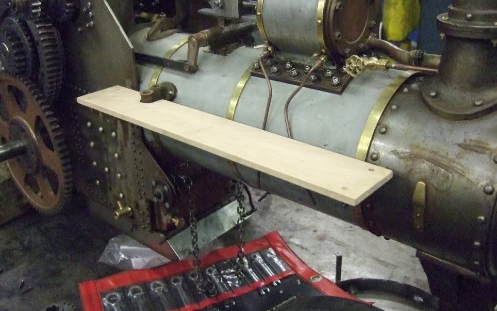

heres the walkboard in place on the control model...
