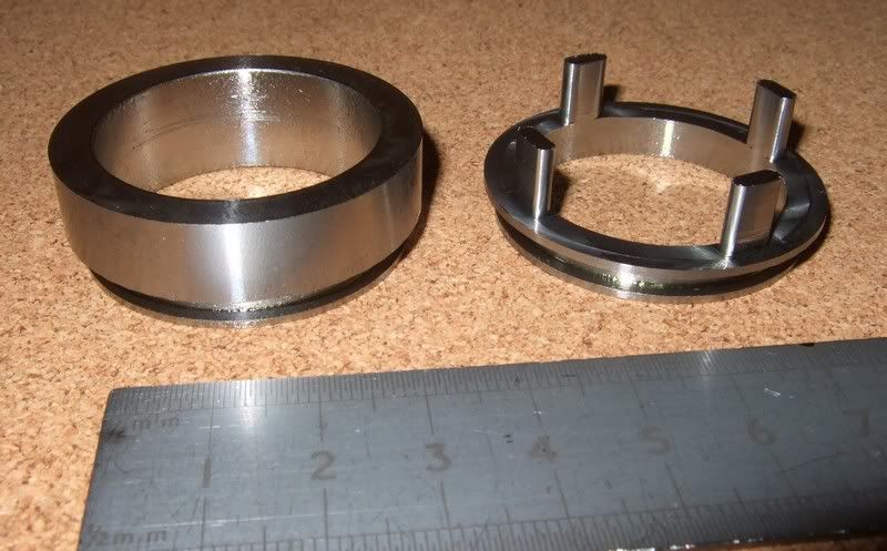

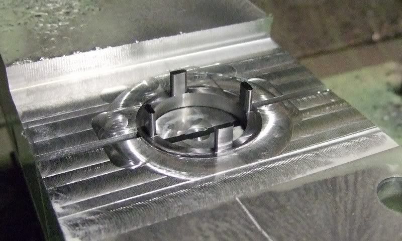

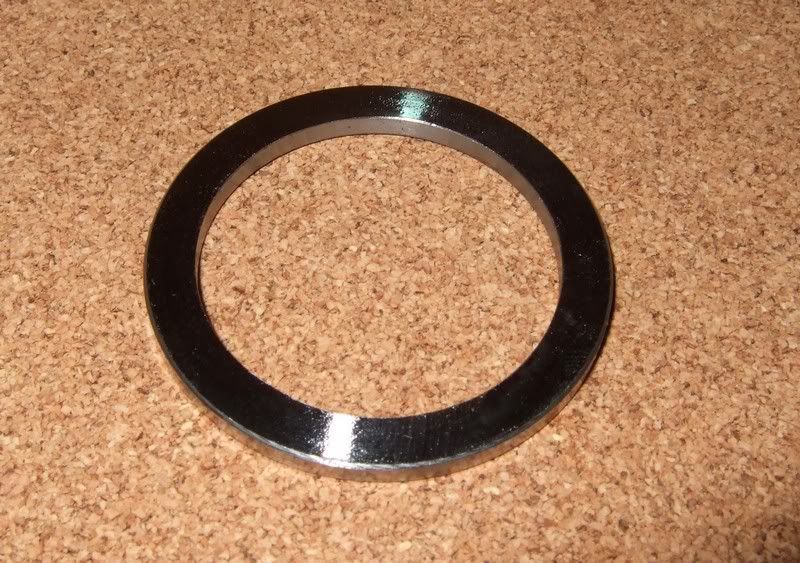

Just a quick one. i wanted to share something with you that was on the machine today, the 2inch Burrell Diff locking ring.
as you can see, the ring is turned on the lathe to start with and then finished on the milling centre...
another job for the Aluminium vice jaws Cool ...

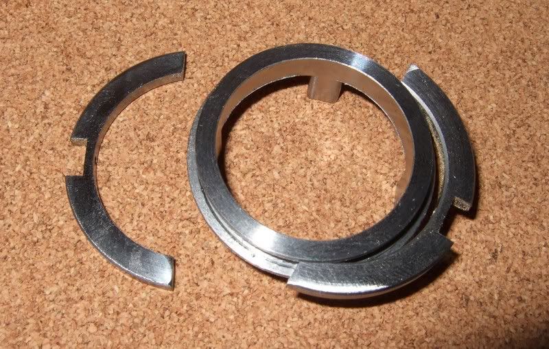

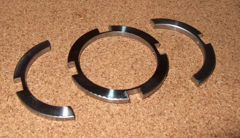

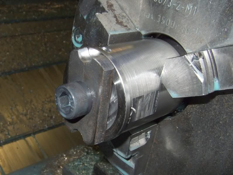

just managed to get the diff lock selector fork on the machine on Friday...
these are made on the 4th axis from a steel ring...
the ring is machined...
and then cut in half to give two forks Cool
