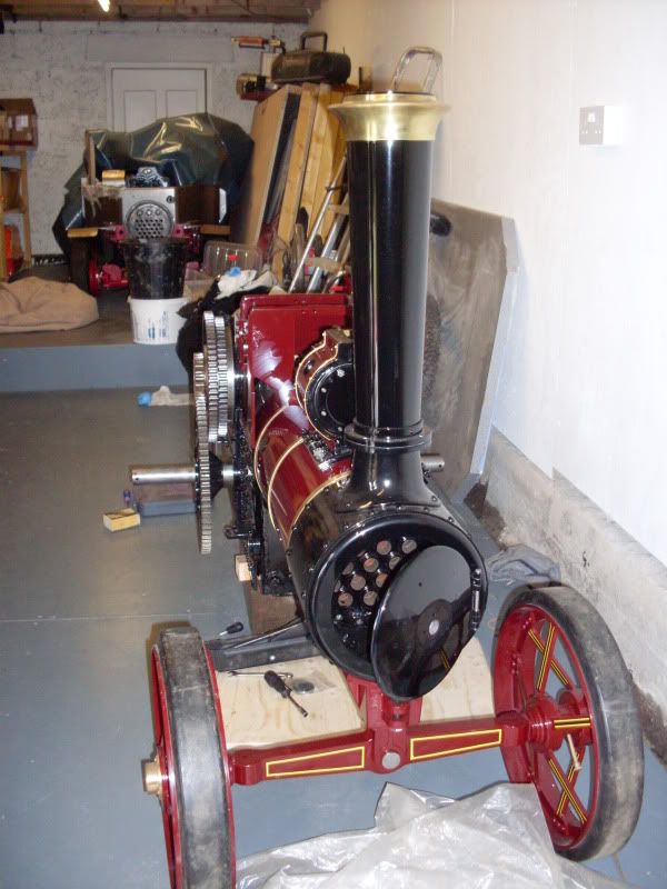

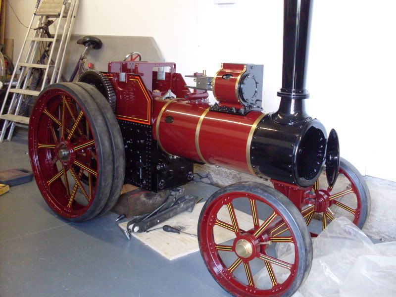

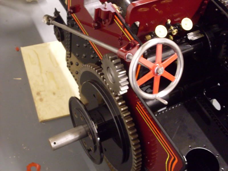

Hi i thought some of the 4" burrell builders would like to see some more pictures of my engine in build let me know what you think.

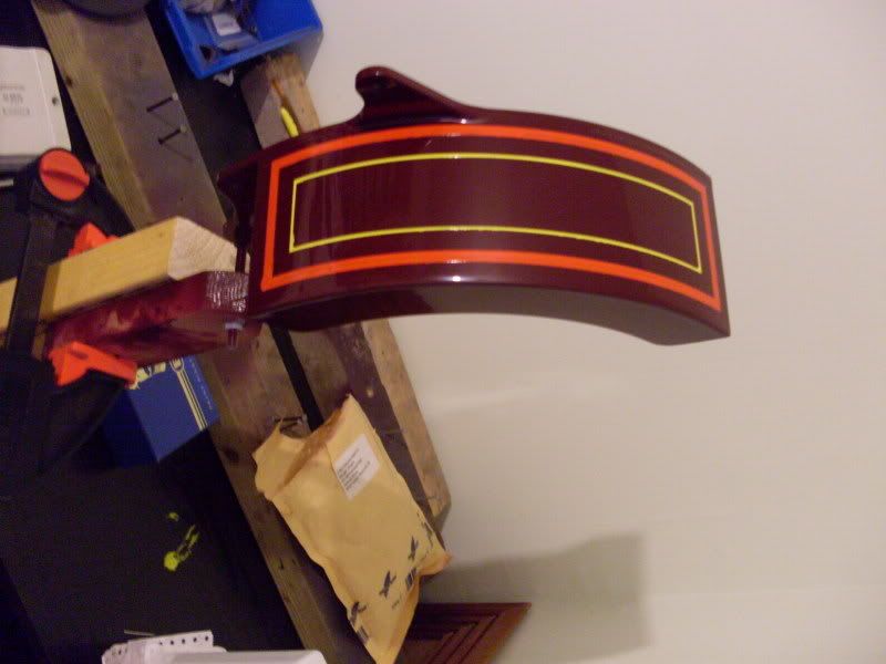

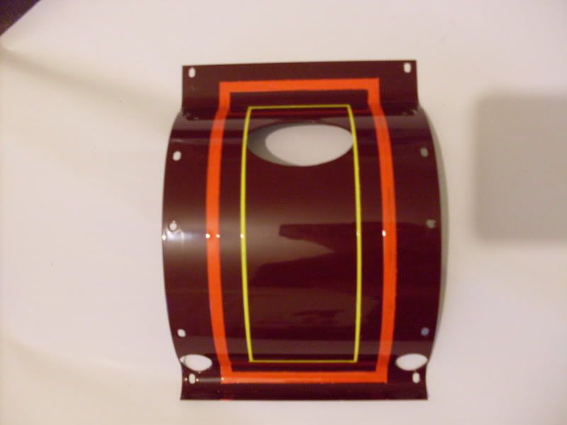

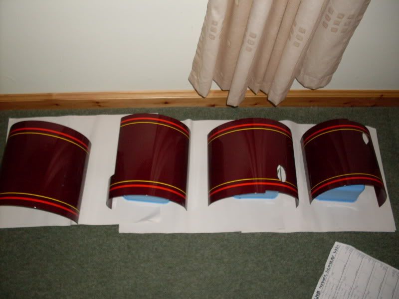

The lining is a mixture of masking tape and using the beugler pin striping tool with one shot lettering enamel and has taking a little while to do i was working on the boiler sheets, cylinder cover and top gear guard last night started at 6:00pm and finally got to bed at 12.00 Shocked i will go take some pictures of them and put them up.
I start by doing the vermillion and yellow and then when that is dry i will mask over the vermillion and line the black.
Re: Couple of pictures of burrell in build
Post  tef 20 on Thu 16 Jul 2009, 10:47 pm
Here is a couple of pictures of the first stage not very good qulatiy but you get the idea.
