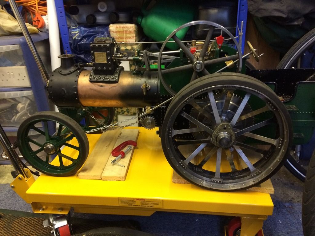

My wife picked up the engine yesterday from STW towers. May thanks to Steve and especially to Ian who did the work and also sorted out a problem I had with the diff / final drive. All looks good. Its n now on my newly acquired lifting table.
Now I can start getting on with finishing it!
