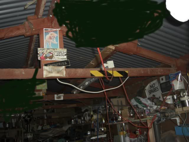

HI all well now I am getting some were .IE not caving or beeing away here are some pics for you to giggel at of my roof and what has happend.. Laughing Embarassed Shocked Surprised Sad Smile
First for smoe reason that is beond me 3 ducks DIVE BOMDed the roof pluss a BIG stick went through the roof.
The pick show were thay did this but I have coverd up the blood and things in black.
Good job that the door opens out all the thing to fix it are now here just need good wether Evil or Very Mad
All the insloshon is now out
HO F a mess and yes the dimm thing are lights.
